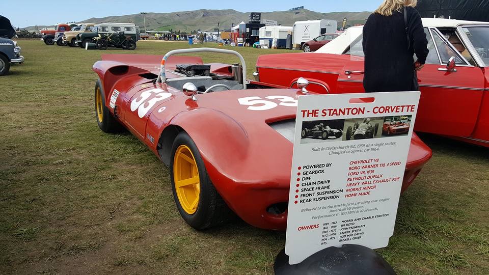

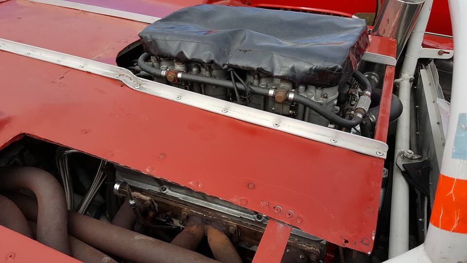

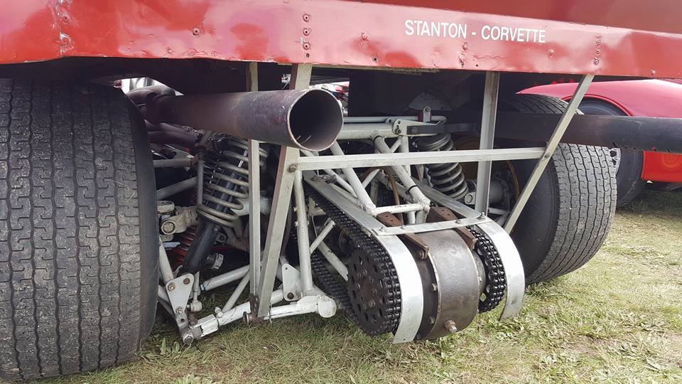

I saw these pictures on FaceBook and harvested them for posting here.
I had seen / read other references to the NZ based Stanton Corvette, but I don't recall seeing pictures this good before.
From what I have read, the drive system was not at all problematic and the car did rather well.
