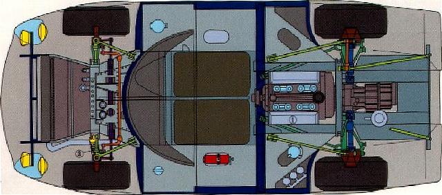

However, if you are happy to build a MkIII coupe chassis (a little different to the MkIIIB) I totally recommend you try and pick up one of the Tamiya 1:12 models and scale it up. From my research, it is surprisingly accurate. The instruction manual has side by side shots of components of the model compared to the real cars. You can't go wrong, and most of the Al folding looks straightforward whether you go mono or skinned space frame. As Russ said, you can use also scale up this kit to do the body if you want to go that route.
The kits often come up on ebay, or Paolo (lovegt40) might be able to help.
The kit also has the attached pic for reference.
