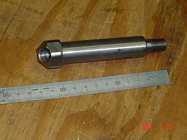

Sominck like dis -- use steel ones only --the Aluminium ones will break off at the thread

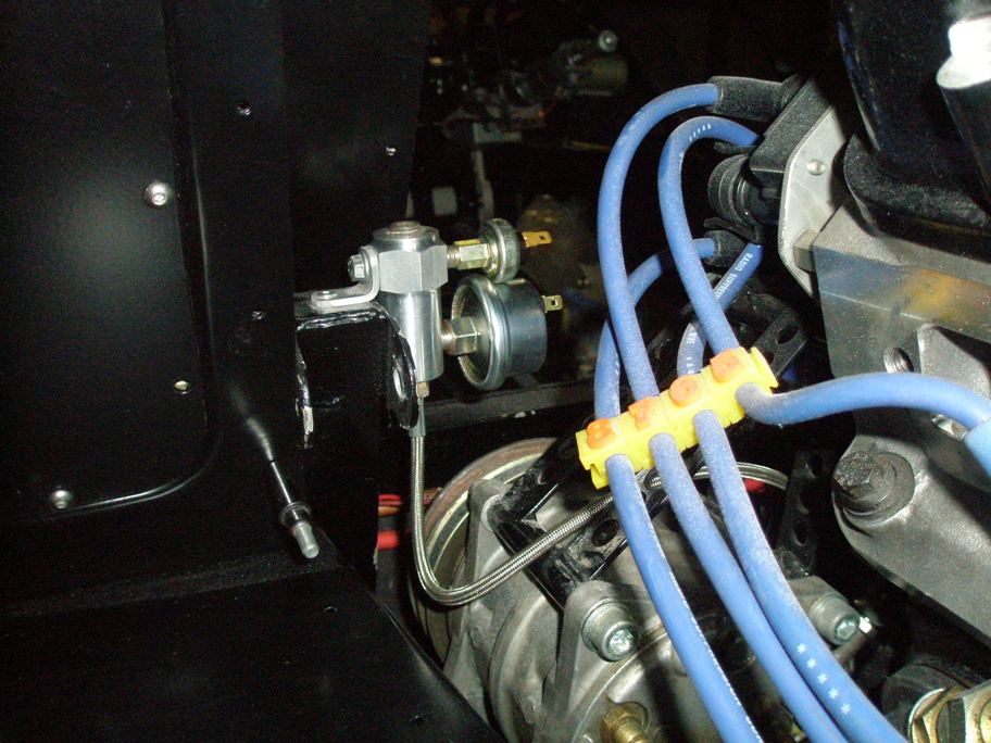

Hi Ian,
a remote sensor mounting is the safest way forward. I used some -3 hose to install mine as below

Thanks for the suggestions....I've bought some braided hose and the aero fittings to make up a remote connection to the sender.
