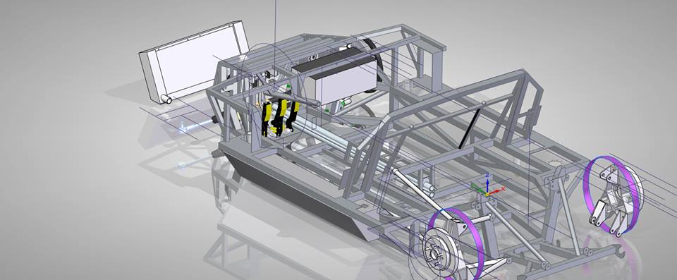

I gave up on making the hanging Wilwood pedals work and am going to be using Tilton floor mounts. This is going to be a pain because of the steering rack position, and I'm likely going to have to move the rack up as much as the frame allows and make custom steering arms. Obviously this is really unfortunate to be coming after I made my frontend changes, but I'm learning very rapidly from the hoops this build is making me jump through, and trying to finish up a component that I'm satisfied with is a constantly moving target.

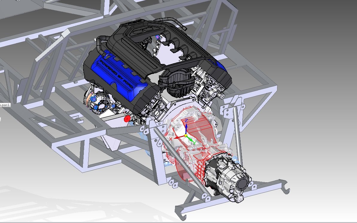

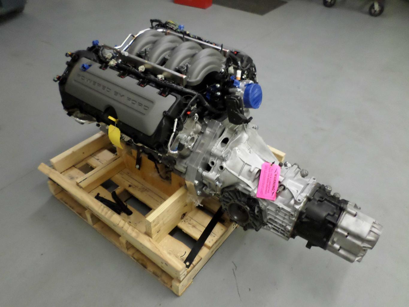

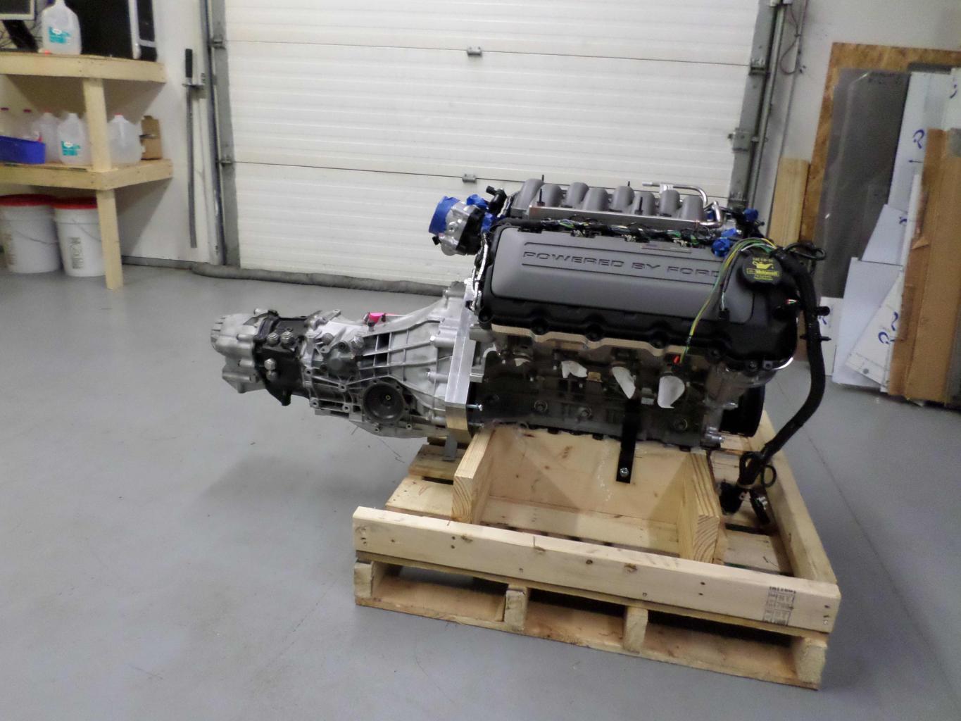

I also finally got my drivetrain bolted together, and put together a design for the engine mounts that I'll be welding in over the next week or so. The 01E does not have the most ideal output flange location, but I still placed the engine nice and low and pushed forward, and the CV angle shouldn't exceed 15-17 degrees at full compression. I also talked to Ford Racing and was told that there wouldn't be any issues other than oil baffling if the engine was actually leaned forward a few degrees past level, rather than tilted back as in a normal installation. So if I really wanted to, I could put the nose of the engine another inch or so down. I don't know if this will be detrimental to the life of the throwout bearing or other components, however, so I left it on the table for now.
