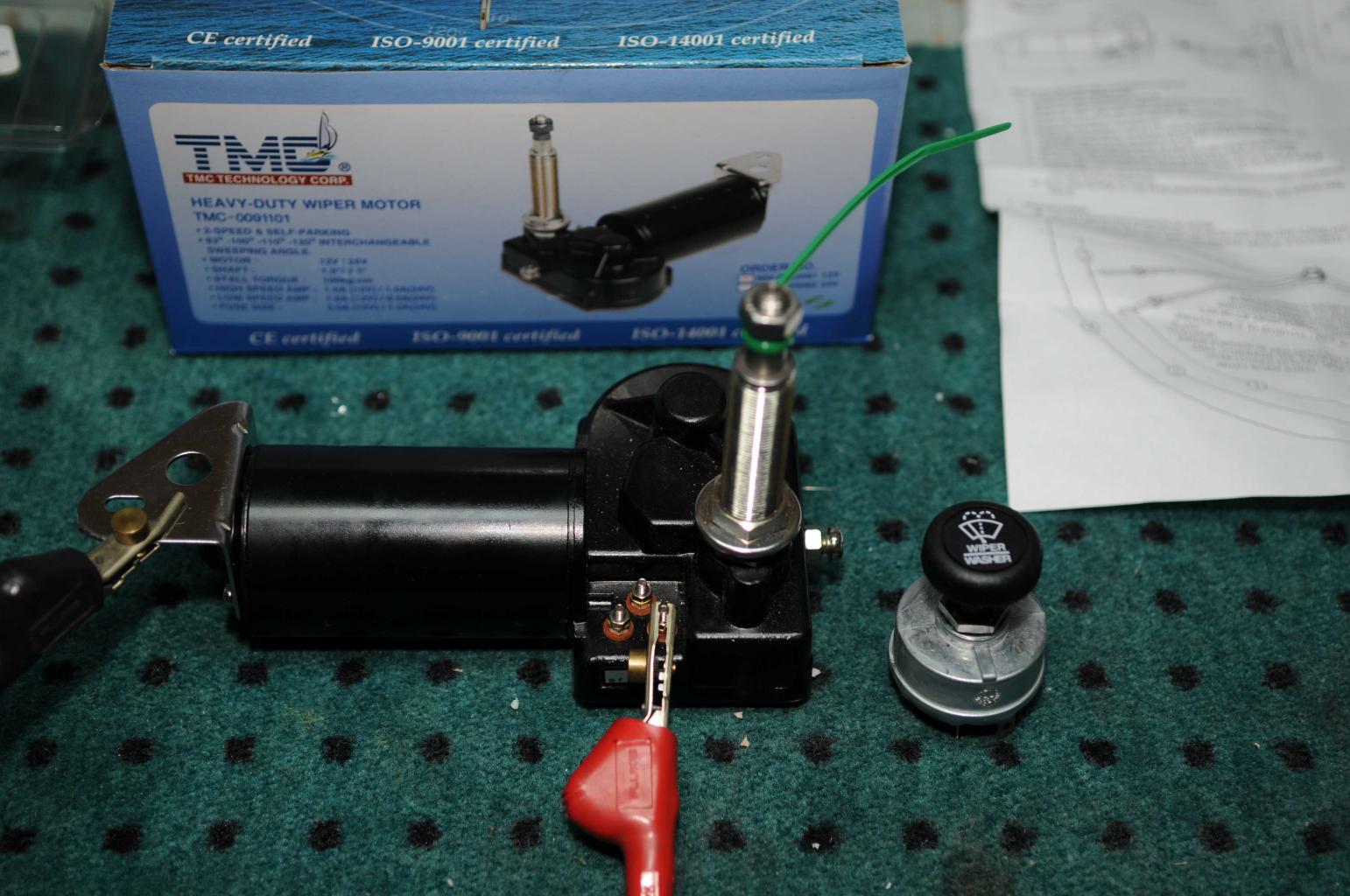

I found an marine type wiper motor that might work. It has long stem to accommodate mounting and two speed with park. The sweep is adjustable and I have it set for 120 deg. I think there is a post somewhere about the required sweep angle.
Can't remember if the switch came with it or I got it separately. Did a rough test fit and it seems to fit... who knows, maybe another paper weight :laugh:.

I used the same (long shaft) wiper motor that Renato is showing on my RCR and it's a near perfect fit. Sorry, I'm overseas at the moment and don't have any install pics to show.
As for the wiper arm. I ordered their adjustable arm (it looks the part) and bought a 21" (guessing here) steel wiper blade that snapped right in.
It's a nice unit and the sweep is adjustable to at least 120 deg, maybe more.
Model # TMC-0091101-16 Kit: 12V Heavy Duty Marine Wiper Motor with 2-1/3" Shaft and complete 16" wiper arm and blade.
