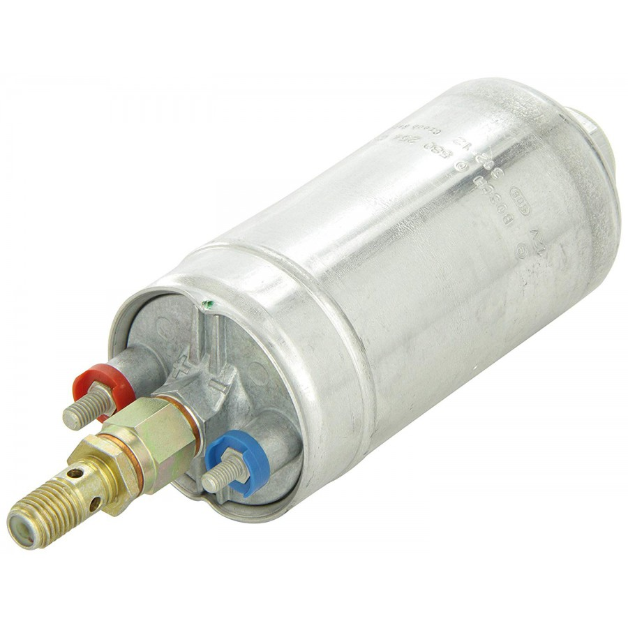

Bosch O44 pumps have them allready fitted.

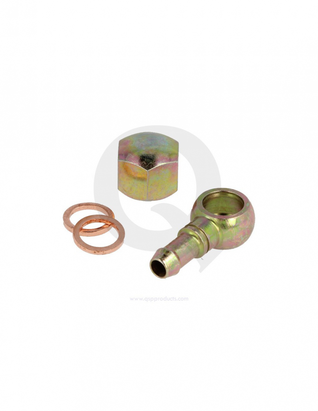

Normaly used with this take off kit ( capnut & banjo)

On advice from my Megasquirt suplier I wen't back to the one-way valve on the pump as it came with and the system stayed presurised for hours.
Way easyer startups.
Running the Bosch 044 (6.5bar pump, cheap Oriental version)
