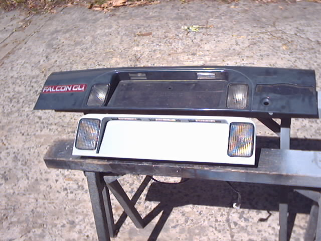

Not wanting the rear of my car to look a mish mash of added on after market bits I made my own number plate trim with built in reversing lights from a Falcon and number plate lights from a commodore station wagon.
The resulting look is more OEM and cleaner rather than added on accessories.
Below are photos of the trim before and after.
Dimi

That looks really neat. Is the panel in the Falcon actually a plastic?
Did you cut out and glass or glue in?
Bernie
Dimi Terleckyj
Hi Bernie
When I was looking for a number plate surround/trim I saw this Falcon trim and thought it would be the right look for my 40 but when I cut it out it was too big for the body section on the rear clip.
So I cut out the reversing lights and made a new frame out of aluminium plate and fitted the Falcon reversing lights and then found some neat small Commodore station wagon number plate lights and fitted them into the new alloy trim plate.
The Commodore number plate lights are small enough to fit into the space in the rear clip in the same space as the Falcon ones which are too big.
To ensure the lighting would be bright enough I used three instead of two as in the Falcon trim as can be seen in the photo.
The height of the DRB rear clip tail section is just big enough to make all this fit neatly.
One other thing to keep in mind is that the number plate lights you use must comply with the ADR rules and have a compliance Number or be "E" marked.
PM me if you need any further details.
Dimi

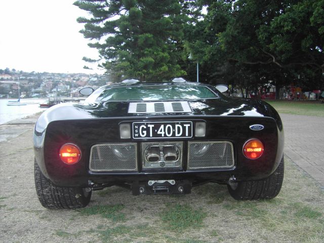

Bernie I recessed my number plate in by cutting into the rear clip on three sides and folding the bottom in.I then had just enough room for VS commodore wagon numberplate lights. There is a pic of it on MY thread (DRB 46 now on the road)
Hope this helps.
Darrell
