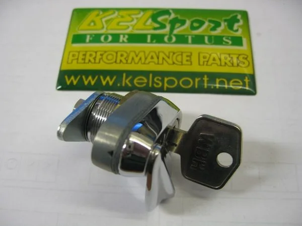

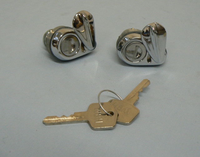

Paul, thanks & already sorted, with many thanks to Weston. ( like you I had a quick reply too supplying me details where to get them).
Lotus Europa, lock for bonnet & engine cover, so you'll get a pair on one key. (Weston number 9/01139)
€87 including shipping to the Netherlands.
They come with the big nut on the back which make fitting them in fibreglass doors easyer.
SJ046B0009 LOCK for BONNET and ENGINE COVER (PAIR) (sjsportscars.com)
So my MKII will get locking doors which locks will blend in like the MKII roundel lights.

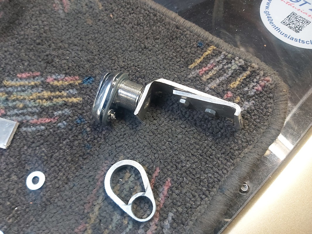

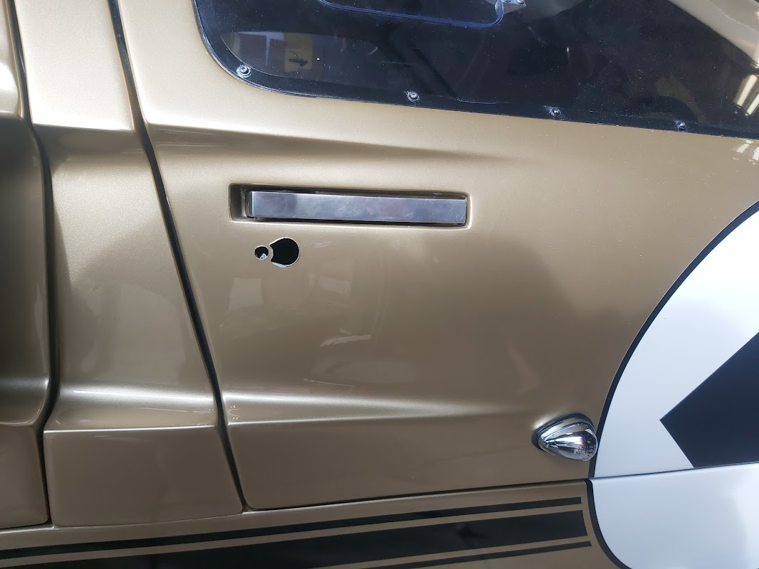

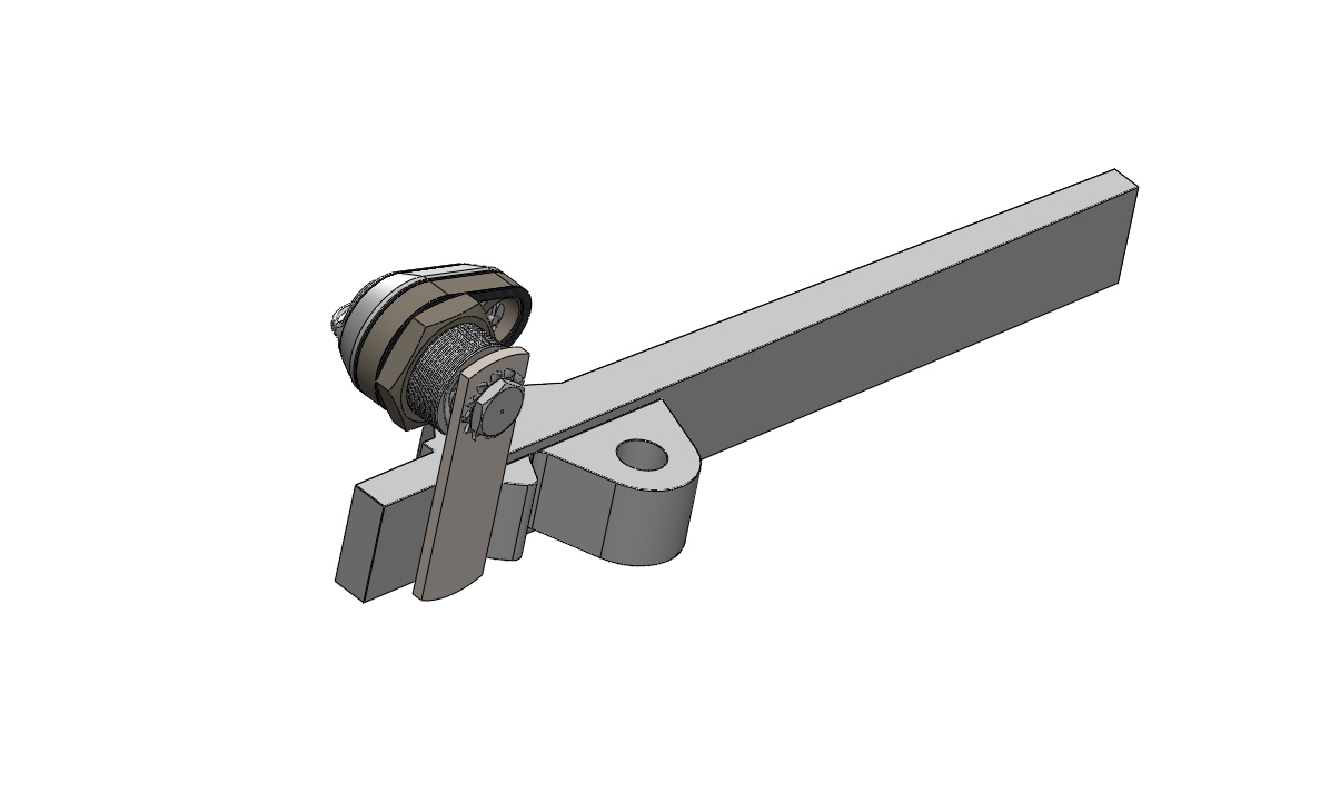

Ill going to adapt it to my SouthernGT locks, Ill have to make a new lever & rod assy to make it work.

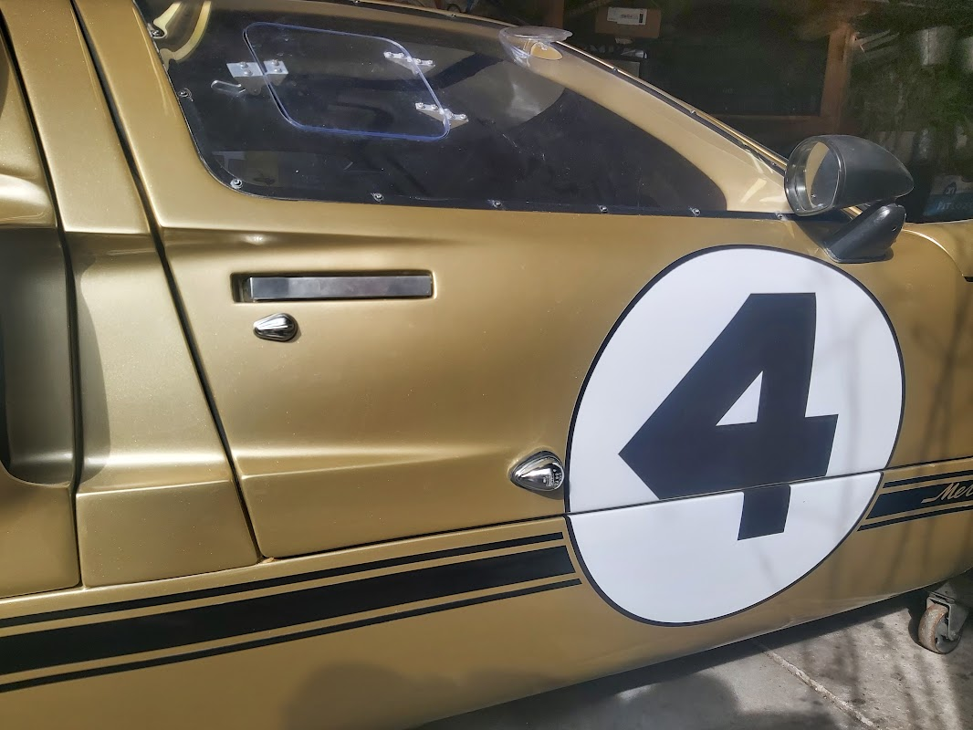

Some update about the Weston door locks.. they are flimsy but they work.
It doesn't fit the original location on a GTD door as there's no room above the handle.
But all is doable.
Lock is about 27mm wide.
About 38mm long.
Needs a 19mm hole.
Protrudes about 17mm

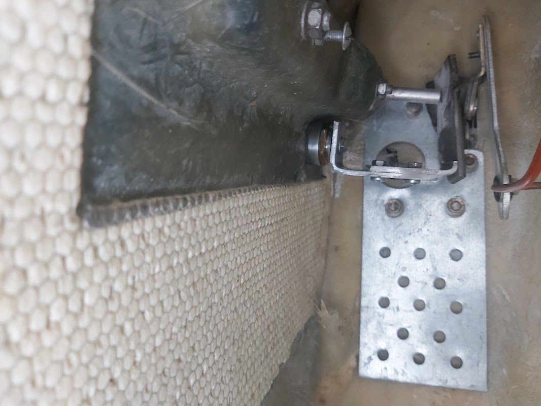

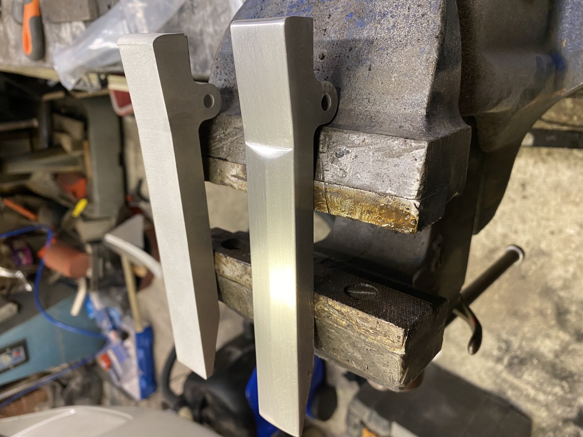

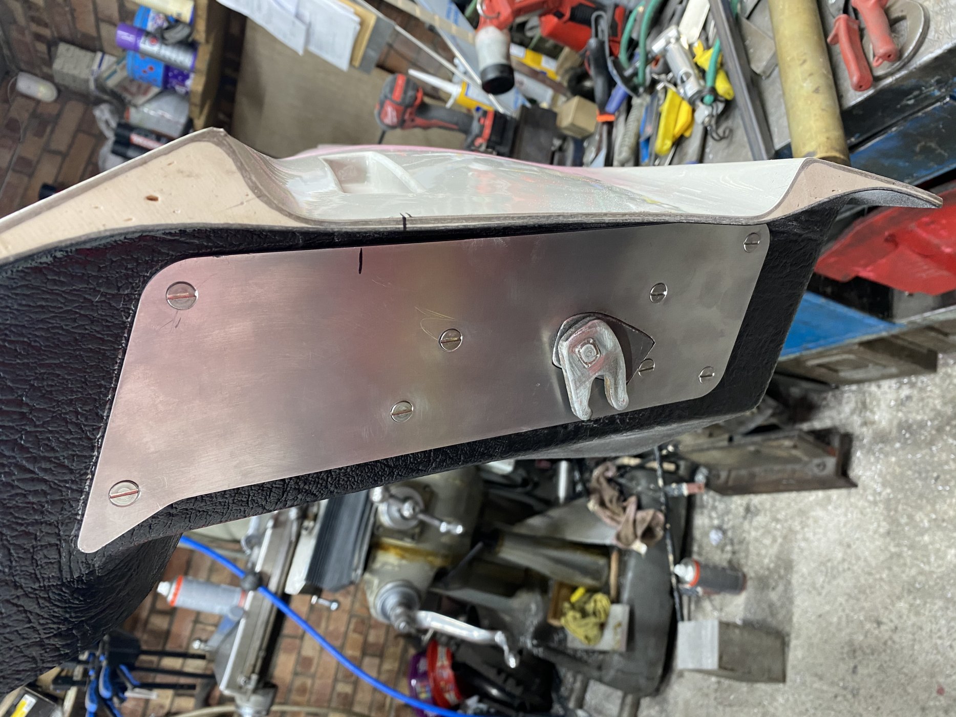

My latches & door handles are SouthernGT. And the SGT latches have a provision for lock, but that also means, it locks the inner handle which I didn't like to use if I need an emergency escape from the other door (which I might forgot to unlock from the outside..).
So like OEM situation I locked the handle, but at the latch itself.
Don't worry, I had to file down that corner so it could freely turn inside the door.
Door locked.. but still working on the inside handle.
Door unlocked.

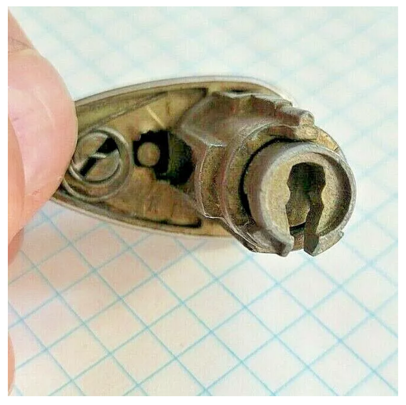

What’s a good source for for these locks now that SouthernGT isn’t around? I’m in the US so would prefer something here vs the overseas shipping & additional cost/wait time.
Devin, Lincon, Mercury and Edsell models also used this lock, based on what I noticed when looking for my rear lights. Quite a few on ebay and not hard to find at the time of writing.
(prototypes ran a Mercury rear light)
JimmyMac
Try "52-58 Ford Car 53-60 Truck Door Lock Barrel" for USA Ford.
Slightly larger than the British unit but easier to get US Ford key blanks cut.
Devin
Yes I see those, but the backside of the tumbler/mechanism isn’t friendly to modification being pot metal and not a bolt-on actuator. If I have to, I’ll try to make something “work” but isn’t ideal and really a $50+ gamble. Plus the back of the Weston lock is threaded and secured with a nut where as the Ford unit is made to secure with a clip and for the thickness of sheet metal and not thicker fiberglass doors.
