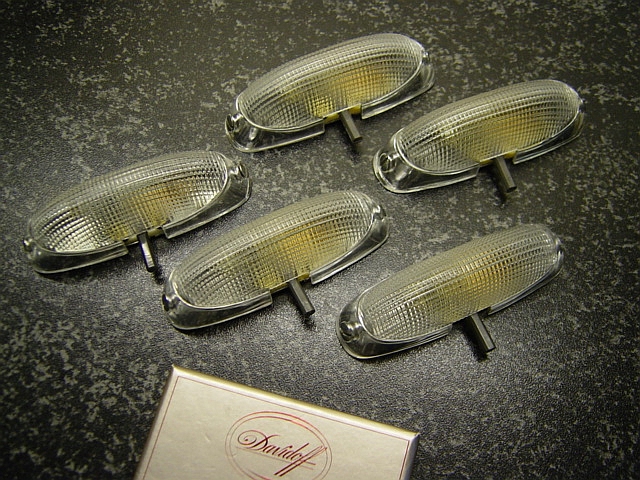

I know this is an old post but does anyone know what these interior courtesy lights are from. I've been looking everywhere to try and identify what they are from or who makes them
Thanks guys
Trev
Thanks guys
Trev
I see in the lead up to the British F1GP on the weekend that Christian Horner was driving into the circuit in an old DB5 Aston Martin doing a TV interview. Go Pro mounted on the dash looking back at Horner and the presenter/interviewer...… interior lights looked similar.
