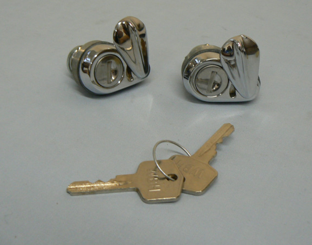

I think it was made by Hella in any case here is one and yes it was used on some Aston Martin cars.
It was used on DKWs originally.
They are pricey but if you want a much cheaper but similar look, this one is freely available, it's in a slightly larger size at about £45.
Volvo Amazon - All models 1957 - 1970.
Also fits PV and Duett

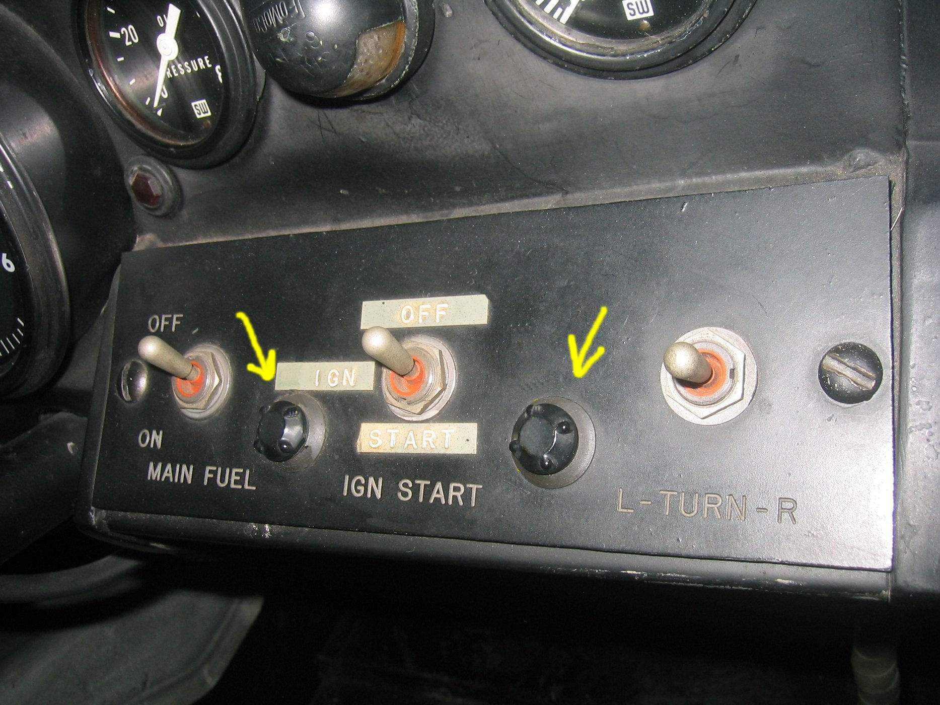

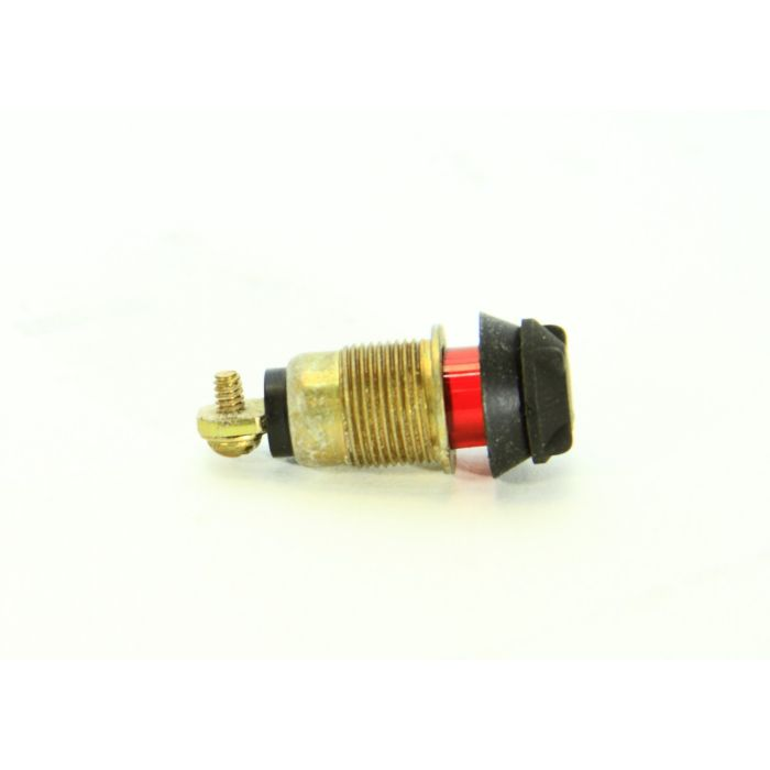

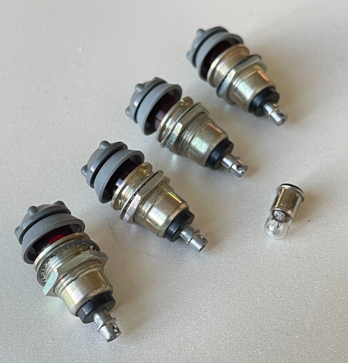

Aviation Panel Edge Lights as found on MK2a & MK2b
MS-25010A or MS-25010A11A Google that number and you'll found lots of these.
Usually come with 28 Volts T-1 bulbs, but T-1 bulbs are also available in 14 Volt 1.4watt versions.
Shown is with 14 Volt bulbs installed.

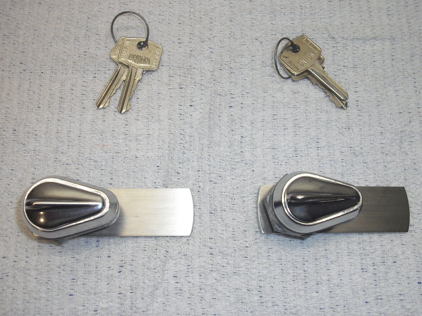

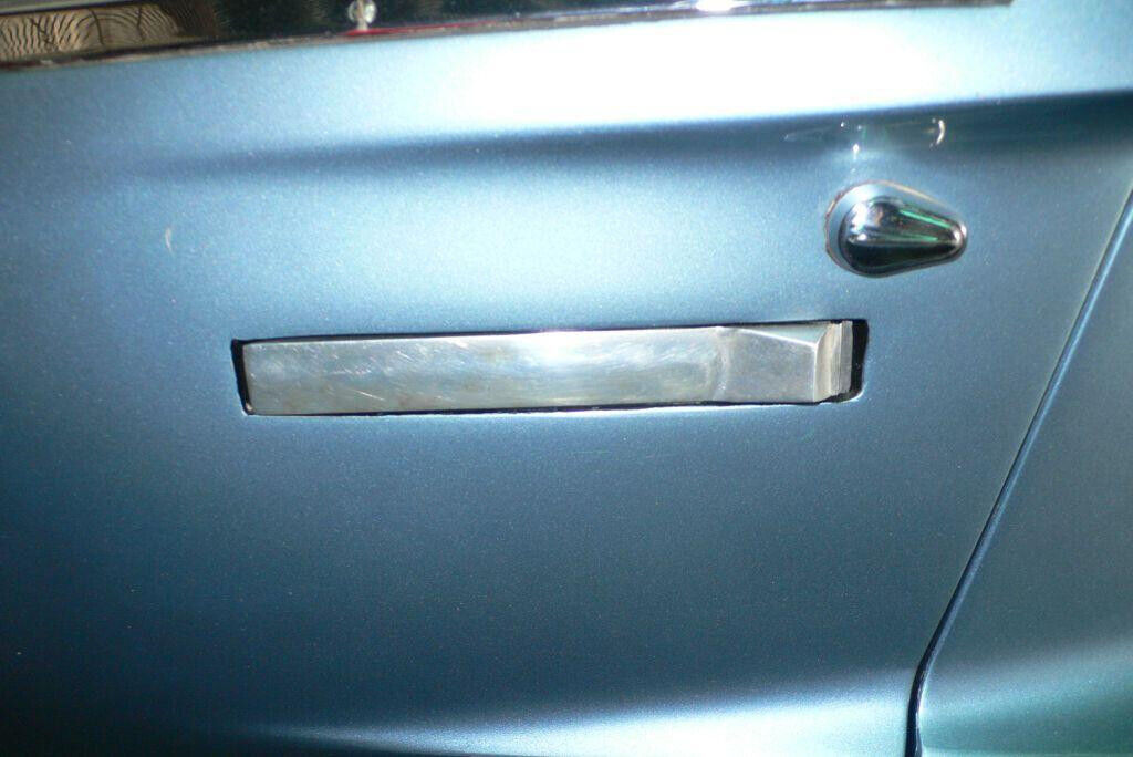

Lotus Europa, lock for bonnet & engine cover, so you'll get a pair on one key. (Weston number 9/01139)
€87 including shipping to the Netherlands.
They come with the big nut on the back which make fitting them in fibreglass doors easyer.
SJ046B0009 LOCK for BONNET and ENGINE COVER (PAIR) (sjsportscars.com)
So my MKII will get locking doors which locks will blend in like the MKII roundel lights.
