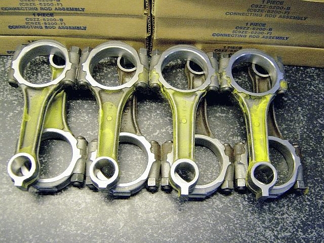

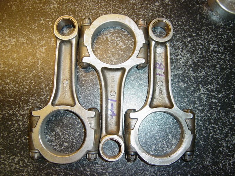

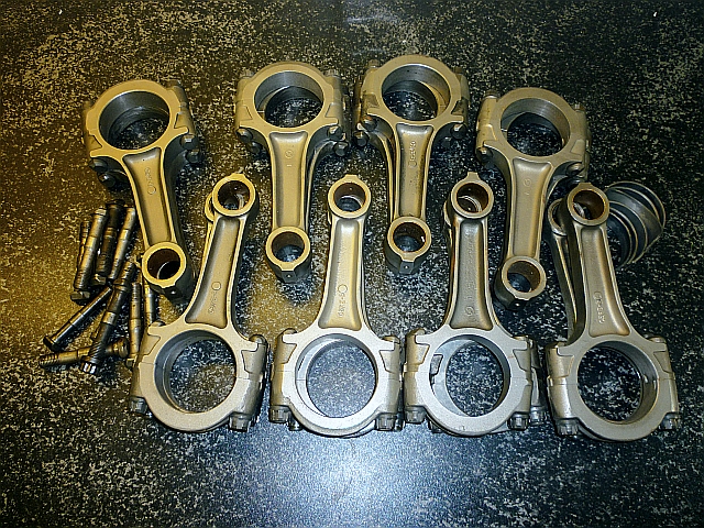

Bob,
The 289 XE engine is heavier than the HiPo and the Boss 302.
The rotating parts in the HiPo and Boss engines are skinny compared to the GT40 XE.
Have a look at some rods below for comparison.
The C5FE and SK Rods shown in the photos are true GT40 engine parts and in my XE.
The lighter yellow painted rods are in my HiPo and are a bit heavier than standard 289/302 versions. The Boss and HiPo versions are virtually the same rods with the exception of differing shaped heads on the studs..

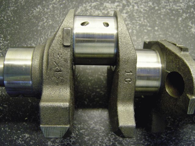

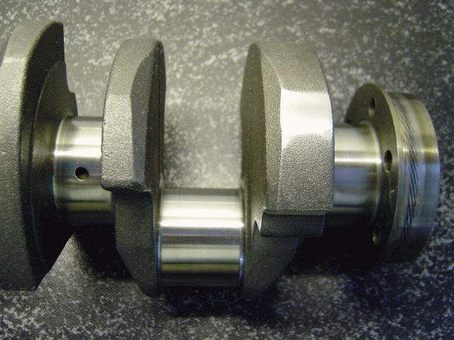

It's always been my understanding that the only difference between a standard 289 rod and Hi Po (K code) rods, was that the Hi Po rods had 3/8 bolts as opposed to 5/16.
Also the crankshafts are the same, except that the Hi Po crank was hardness checked and verified by a stamp.
Am I in error?

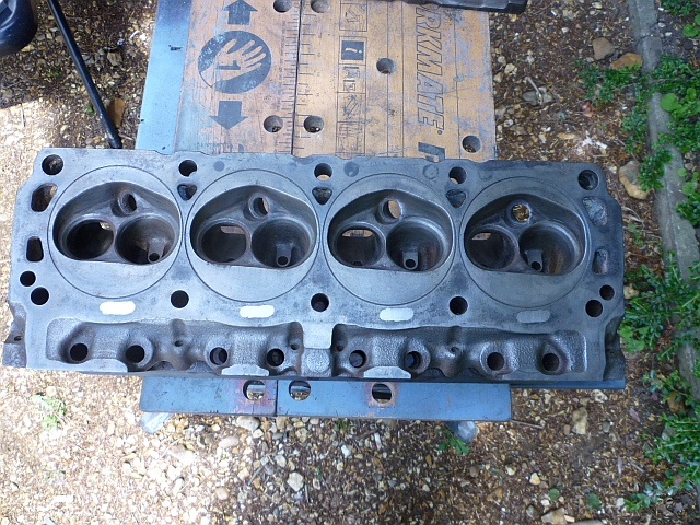

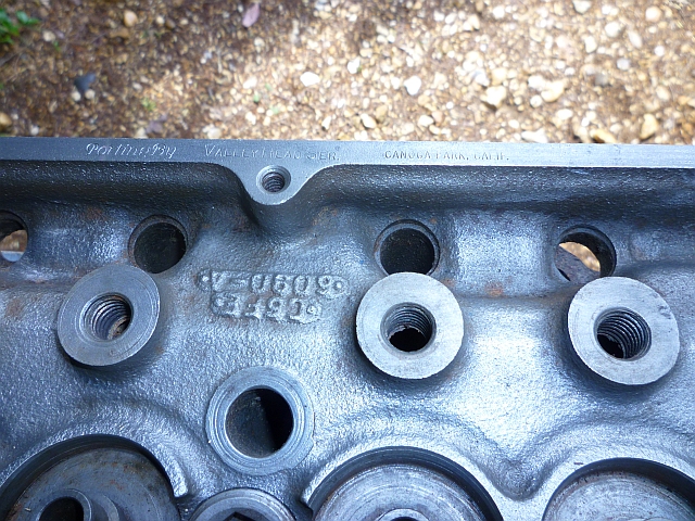

Picture of my ringed heads below. These were prepared by Valley Head Services Cal. for a Shelby C6FE engine.
They also brazed up the waterways.

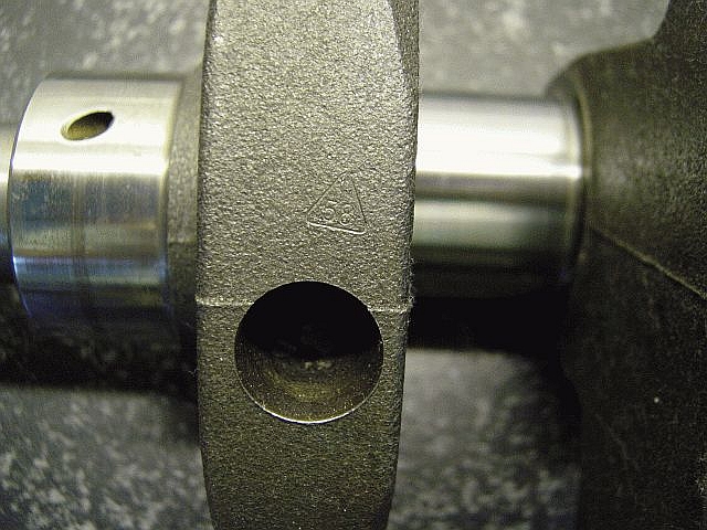

Scott,
Correct.
The HiPo crank was from the same mould but tested as you say and it also had a special counterweight added.
Pictures of an extremely rare NOS crank which I put into the HiPo along with those rods above.
It is so rare insomuch that it has a complete set of the foundry inspection marks including the hardness stamp.

Picky Corner:) head gaskets were never really the problem, bolts(7/16) and head deck thickness were real culprits, relatively simple cure in both cases, drill/ tap block for 1/2" UNC(351w bolts) and fit studs/props inside water jackets to deter head flex as reqd, only works on early 289/302w & 302 Boss blocks, no good for later 302 blocks where head bolts go thru to water, bean counters stuffed all those by saving too much cast iron .
