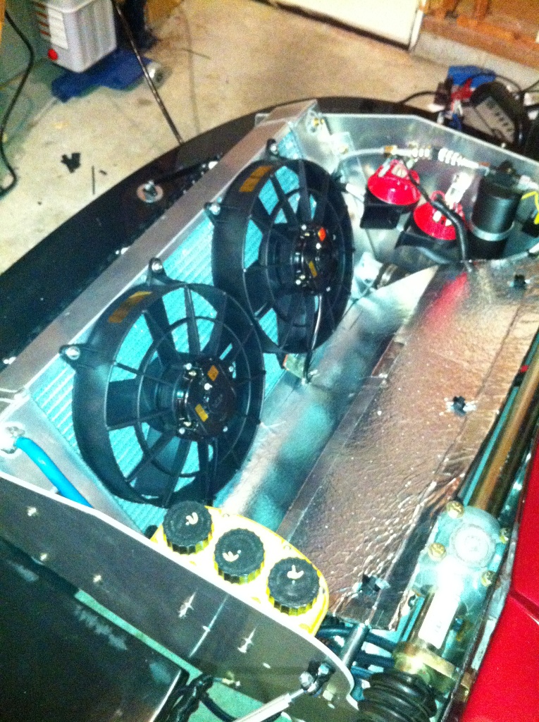

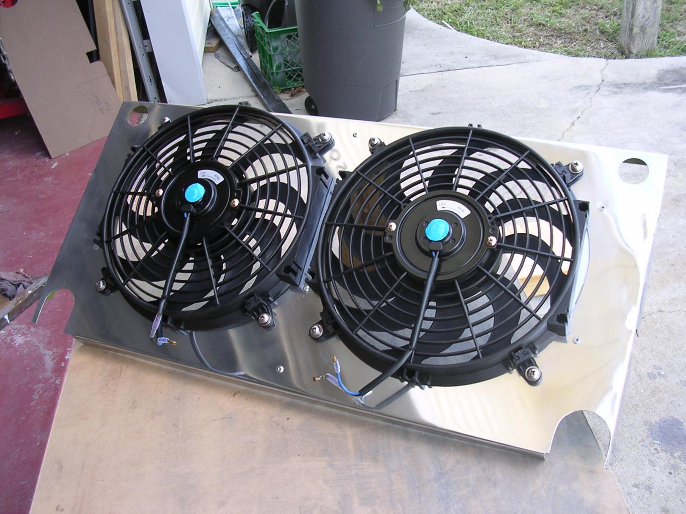

The shroud will make the fans more effective. Instead of having fans tight to rad surface on only pulling air through the fan dia itself, the shroud will lift fans off core and draw air through entire surface instead. It's kind of a big deal. lol
Yep! A minimum of 3/4" to a two-inch offset should be okay.
The shroud needs to be sealed around the radiator too.
