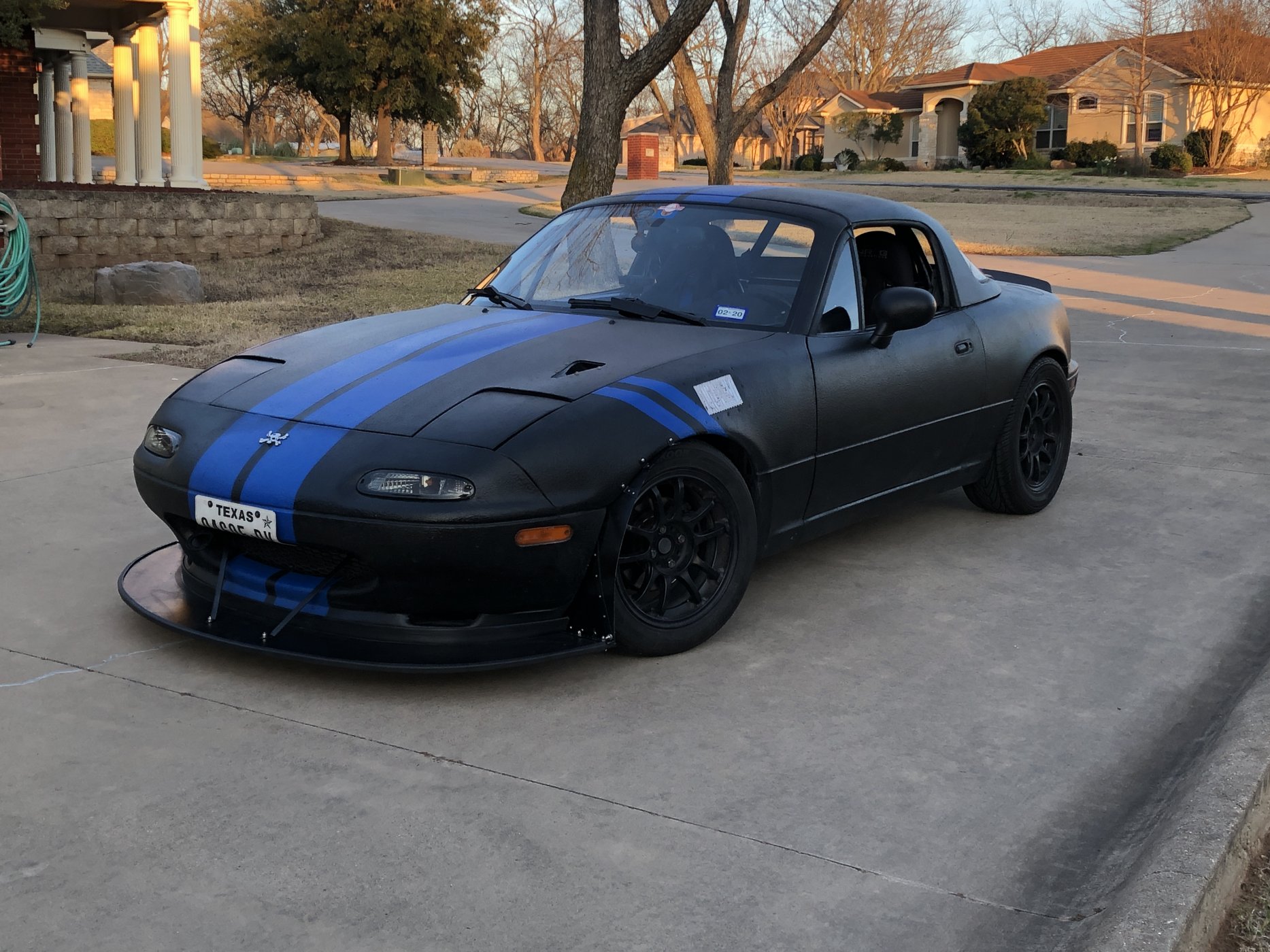

DO NOT track a $25,000 paint job. NOT even once! The tire swarft is little pieces of hot rubber that picks up asphalt grit, little rocks and metal stuff and then cools into a ball that can be the size of a golf ball or larger. Then it gets thrown at high velocity off the tire of a car in front of you and you run into it at a 100MPH. Paint will not hold up to much of that. You could, more than likely will, return to the paddock and find you just REALLY FUCKED UP your beautiful $20K paint! I've seen guys with brand new Porsches and BMWs nearly in tears.
Track car = cheap single stage, single color, paintjob or maybe even a hard look at a wrap job.
I am following Cam's lead and doing plasti dip. If you spray it thick enough is easy to remove and you are looking at around $500. That helps you see what areas of the car get road rash etc, as well as allow the body to settle and to see which areas are a high risk for cracks that may need reinforcement. Also it can help you see what areas may benefit from clear bra type protection as well. And a bonus: try out a color scheme. I am thinking one of those shifting colors.
I will call it a paint try out and prototype. Just my 0.02
