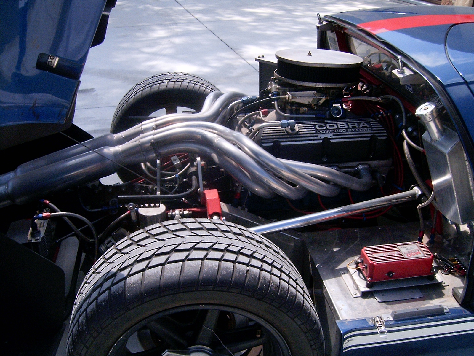

Do something like this using a "hood pin" kit ( multiple sources} and a homemade pedestal. These are made from 2X6X1/8 inch aluminum tubing with an end welded on it (facing the firewall) to act as a bolt-on surface.
You are correct in thinking you need these. There is a long history of GT40 "blown open" rear clams. Do it now!
