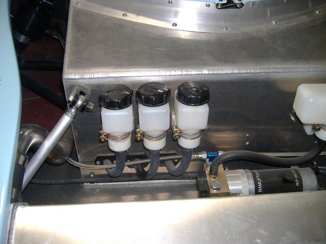

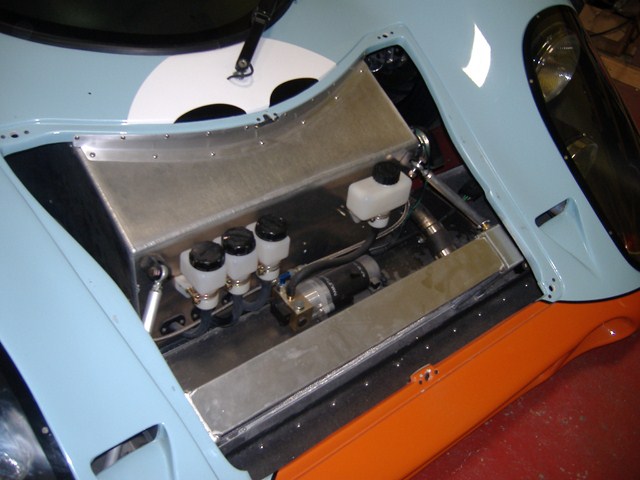

Does anyone have some photos of the location of the brake/clutch reservoir on the RCR 917. I'm assuming that they are placed under the front cover. There isn't a lot of room there, so I don't want to mess up the placement of them.
Here ya go Craig...the lift kit pump and reservoir are under there too on this car..

Thanks Fran.

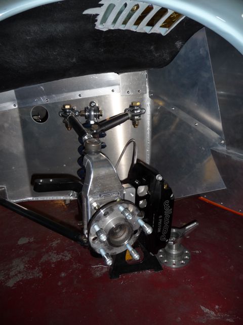

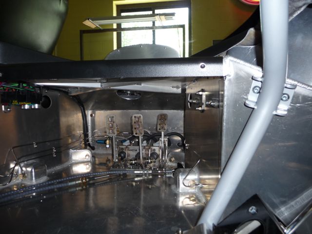

Do you have a photo of the best location for the front brake lines to go through the chassis? Or suggested location?
Hi
Don't mean to step on Fran's toes here but maybe this will help?
Regards Martin

Thanks Martin, those pictures really help. What length flexible brake line is used on the front? It looks like about 18 inches.
