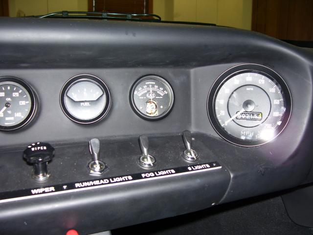

I like the ammeter but didn't feel comfortable with the SPF 50A meter with internal shunt and fast on terminals.
Got a NOS original CAV (not CAV GT40 but CAV the meter mfg) on ebay that is rated 60A, has large external shunt and bolt terminals.

Jack Houpe
Absolutely great deduction, those spade terminals will end up frying someday and creating more problems than you can think of down the road.
