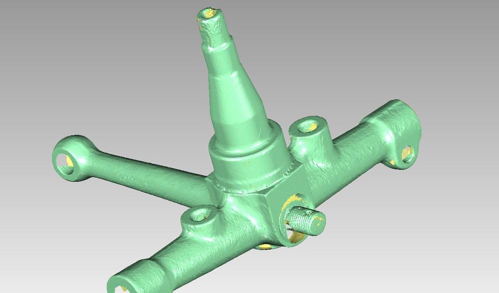

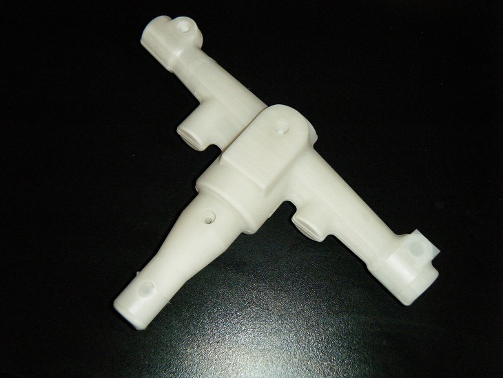

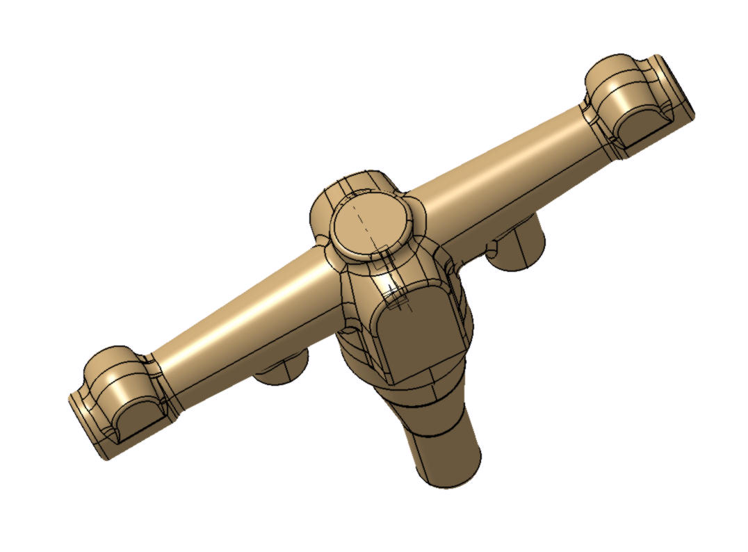

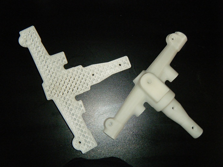

So here we go. I have the opportunity to borrow some original parts. So I had some 3D scanned.
First picture is a raw 3D scam of the front upright

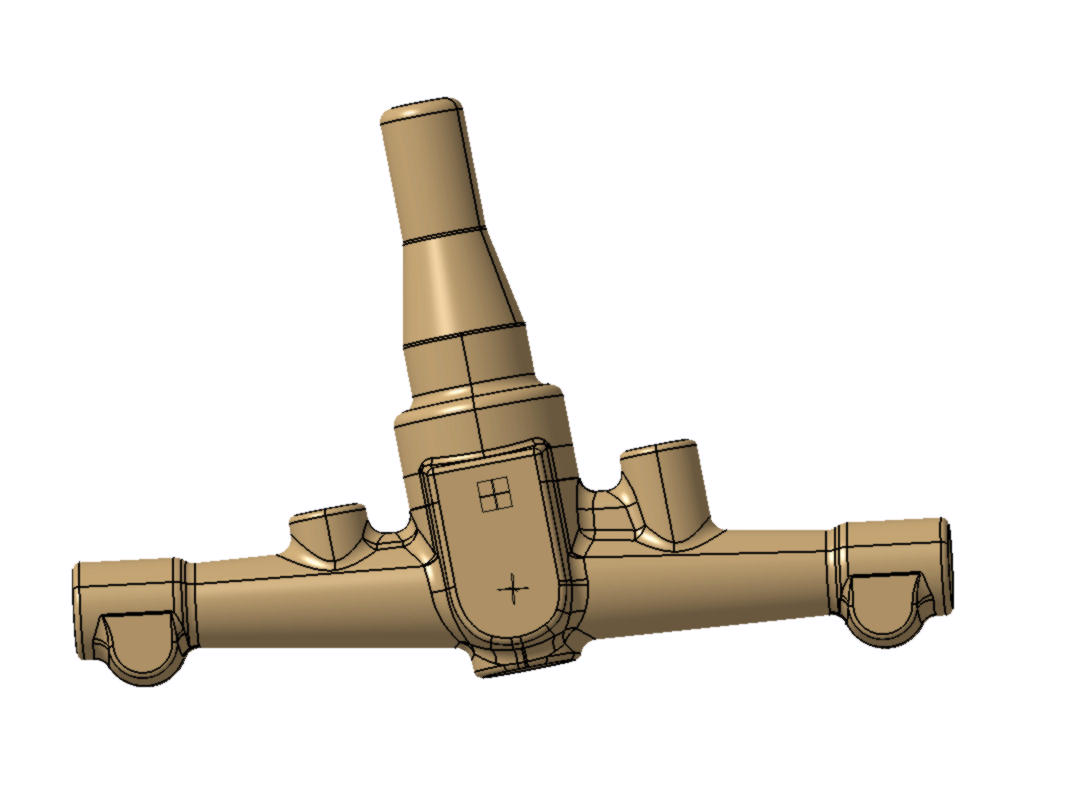

Pictures 2 and 3 show the scan reworked in CAD
Then a pattern is made in rapid prototyping thanks to the 3d files last picture
In another post, I'll show more if there is some interest!

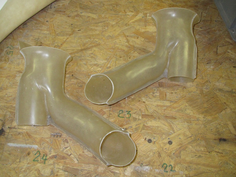

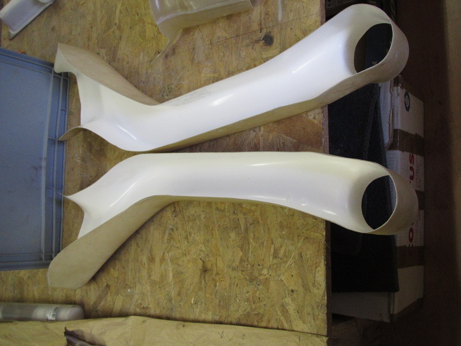

if needed avaible one last pair left of 906 air ducts and driver seat
( all set of parts can be yours at reasonable price "not historic " !!)

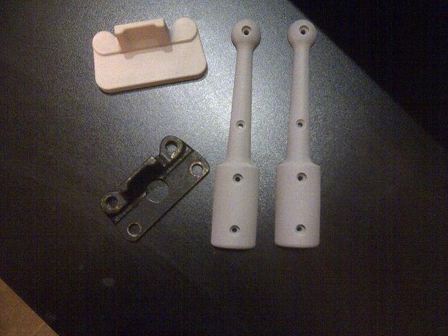

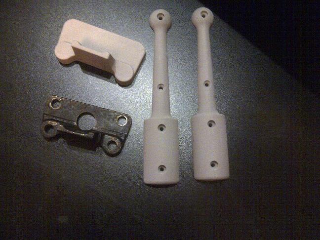

Yesterday, I picked up the last patterns of parts to be cast in steel.
The bracket is for holding the rear calipers.
The wizzard's stick is actually the steering arm, which is to be fitted into the front upright.
Still a lot of work to be done before actual casting, but we're getting closer!

PM sent about fiberglass parts
Concerning those parts you are enginneering: are you aware that they where not"Casted "!!!
Fronts uprights and steering lever where and "are to be forged ; as you know probably it's completly different process as casted will give a non safety constitution of metal ( being very brittle ,specially for the lever )
Just my 2 cts
Michel,
You're right, at least half right.
Right: those parts were originally forged steel. I havent performed analysis on the original parts, but I am confident enough that they used a "mild steel" type.
Half right: Yes, castings can be brittle. Castings can also be improved. To counter the fact that castings will be less "safe", my parts will be made out of high grade steel.
This is not a good option, as high grade steel are more brittle.
BUT, they will undergo a special heat treatment, which is a bit new (at least for me) which is called Hot Isostatic Pressing. This treatment has 2 effects:
- First it acts "like" the forging process, and closes virtually all the micoporosities into the metal (elongation and fatigue resistance are really improved!)
- second it lowers mechanical properties of the steel as grain grows, making it less brittle
So the 2 combined make me confident in the end result.
Last thing, a guy in the US produced a bunch of these parts in cast steel in the 80's with a similare material, and he never heard of any failure. This is a good feedback!
