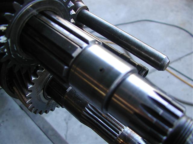

Rear cover plate and hockey stick (shift rod ) cover plate must be removed first. Then take off the pinion nut and remove the large reverse gear. Center section will then slide off.
Remove the input shaft nut and use a big two jaw puller to remove the end bearings by pulling on the gear behind each one.
Then remove the two 17MM hex head bolts and the spring and detent pill behind them. This allows you pull the shift fork shafts back as you pull each individual gear. DON'T loosen the adjusting nuts on the shift fork shaft or you will need a factory tool to adjust them. Tap them back and you will save your factory adjustment setting.
I'll measure the shafts and gear widths before I leave town and post them.

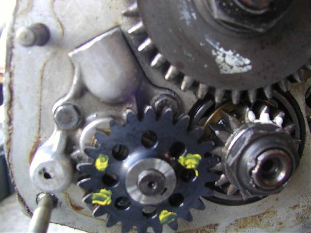

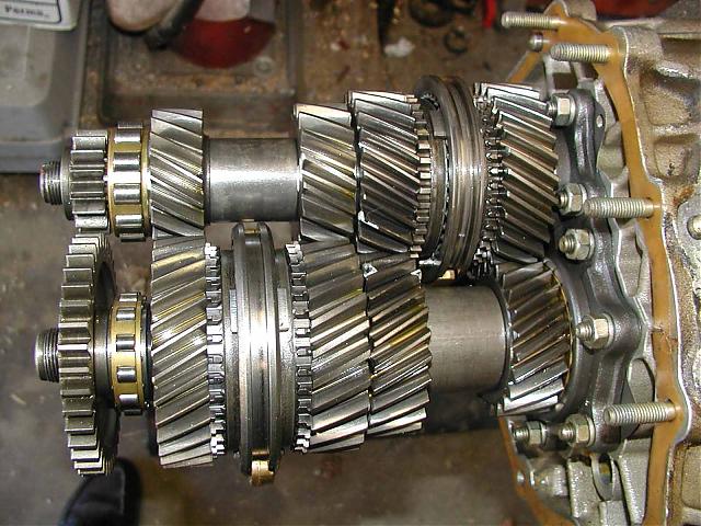

What part of the syncros is typically bad and do you replace with stock parts? The synchro ring is replaced while the expanders and anchor block is reused unless damaged. This can be done by hand and requires no tools once the gear is off the shaft. The engagement teeth (sometimes refered to as "dogs"), and the shift fork sliders are replaced if their sharp little points are worn down or worn off. Look carefully at the first picture of a 935 box before rebuild. On the bottom bitter end is the first gear set and the teeth are sharp and good. Next is second gear and the teeth show flatted points. Gotta be replaced. On the upper shaft is third gear with sharp teeth. Fourth gear has no points at all due to a driver jamming into fourth without using the clutch. Pro drivers are an uncaring, brutal lot, eh?
A special is tool used to press the engagement teeth off the gear and the new teeth are heated to 350*F and dropped onto the frozen gear. Tap it quickly into place with a small brass hammer until it seats flat. Seat it quickly or you must start over again.

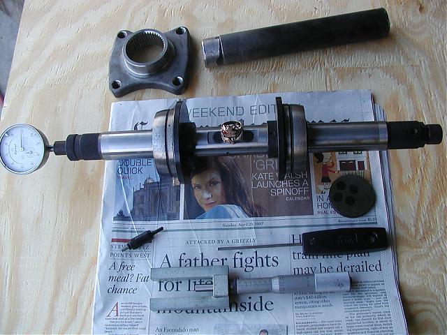

The "drop through" gauge is pictured below. This is used to check the O.D. on the needle bearings that ride on the input and pinion shafts. They are not used on the bearings pressed into the case.
The measurement at the top is 43.80mm; the measurement on the bottom of the taper is 43.40mm. This puppy is very temperature sensitive and should be used between 64*F to 80*F. It has four tapped holes to insert bolts to keep it from gaining heat from the surface it might be sitting on. I use styrofoam. Just for grins I took a known good bearing and let the gauge heat in the sun untill it reached 100*F. Zoom, it passed right through. :eek:
There is also a drop gauge used to check the I.D. on the needle cage bearings but it's a joke. Gentle pressure on the inside of the bearing will pop out any needle held by a weak cage.
Both gauges and the 385 tool are pictured also.
DC

Russ Noble
Hmmm......That's a bit tricky! Not at all like I'd imagined. Guess I won't be making that in a hurry!:( Thanks DC, for taking the trouble to post though. Very interesting.
