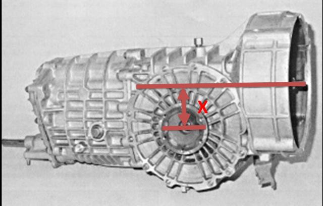

Does anyone happen to have the dimension shown by "X" in the attached photo? I want to know the distance from the input shaft center line to the center line of the output shafts.

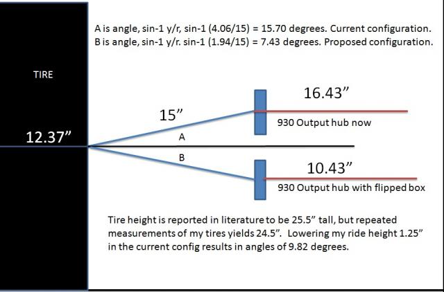

Thanks Russ. So if I flip the 930 my output shafts will drop by 154mm, or around 6". Hmmm. That might be too much of a good thing.
Okay.
It looks like if I flip the tranny, all remaining the same on my setup, I can lower my half shaft angles from fifteen degrees to just over seven degrees. That would be a great thing.
But I'd have to make sure the chassis is setup the way I'd like it. I'm thinking we need to drop the rear ride height about an inch to 1.25", at least, and if I did that then my half shaft angles would drop to at a more manageable 9.XX degrees with no box flip.
However, If I flipped the box and then lowered the car 1.5" I'd be back up at 12.3 degrees.
Flipping the box seems favorable although a bit more study is involved. It could be I might be able to lower the car AND lower the engine/tranny in the car a bit. That might resolve everything favorably.
