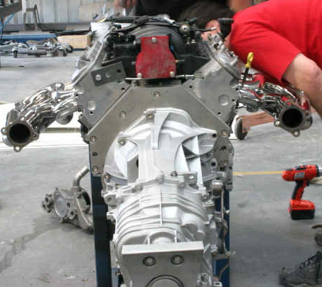

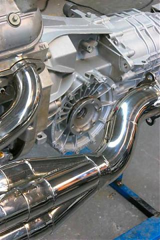

Don't know how it perfomed, but the "Red Back"(super car?) were trying what looks like a boxter trans coupled to a chevie
