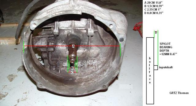

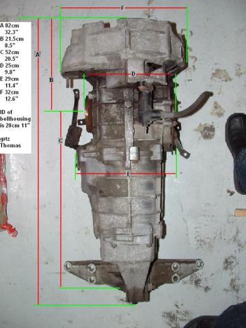

Found these online. Cant say if they're right or not.
Yes the measurements in the G50 dimension drawing are very acurate, made those myself :lipsrsealed:
you missed the G50 side measurements btw should be 3 pics in that series, those contain the awnser to the question also, I'm at work at the moment so don't have the files at hand.
have them for the Renault UN1 also should anyone be interested.
regards Thomas
I am still interested. Any and all measurements help. :D
regards Thomas
Hey Wyoming,
will try and post the picture tomorow.
you need the hight difference between the drive-shaft bell centers and the center of the rubber donut in the back?
I hope I have those in the picture, I machined down the rear casing on the mill for it to fit my GD chassis. I think however that I can relocate the middle within about 0.5cm or 0.2" which shouldn't be a problem because thats well within the play the rubber gives you on full throttle...... :-)
regards Thomas
