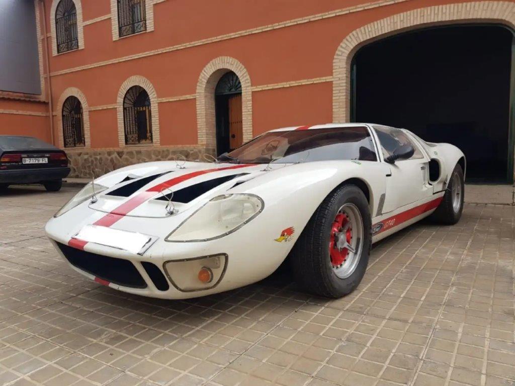

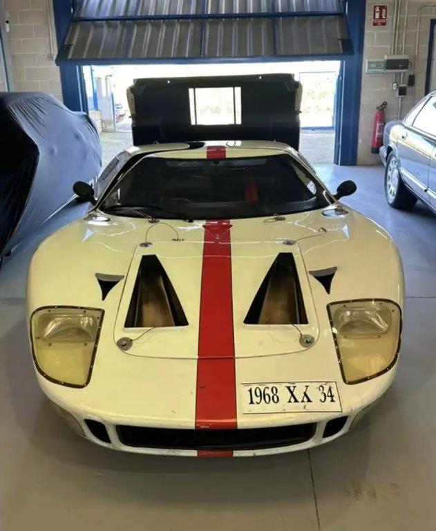

He encontrado uno y estoy hablando con el dueño, sin embargo tengo muchas dudas.
El coche tiene matrícula española histórica y el actual propietario se lo compró a un señor francés hace 16 años. Sin embargo, no tengo más antecedentes del coche.

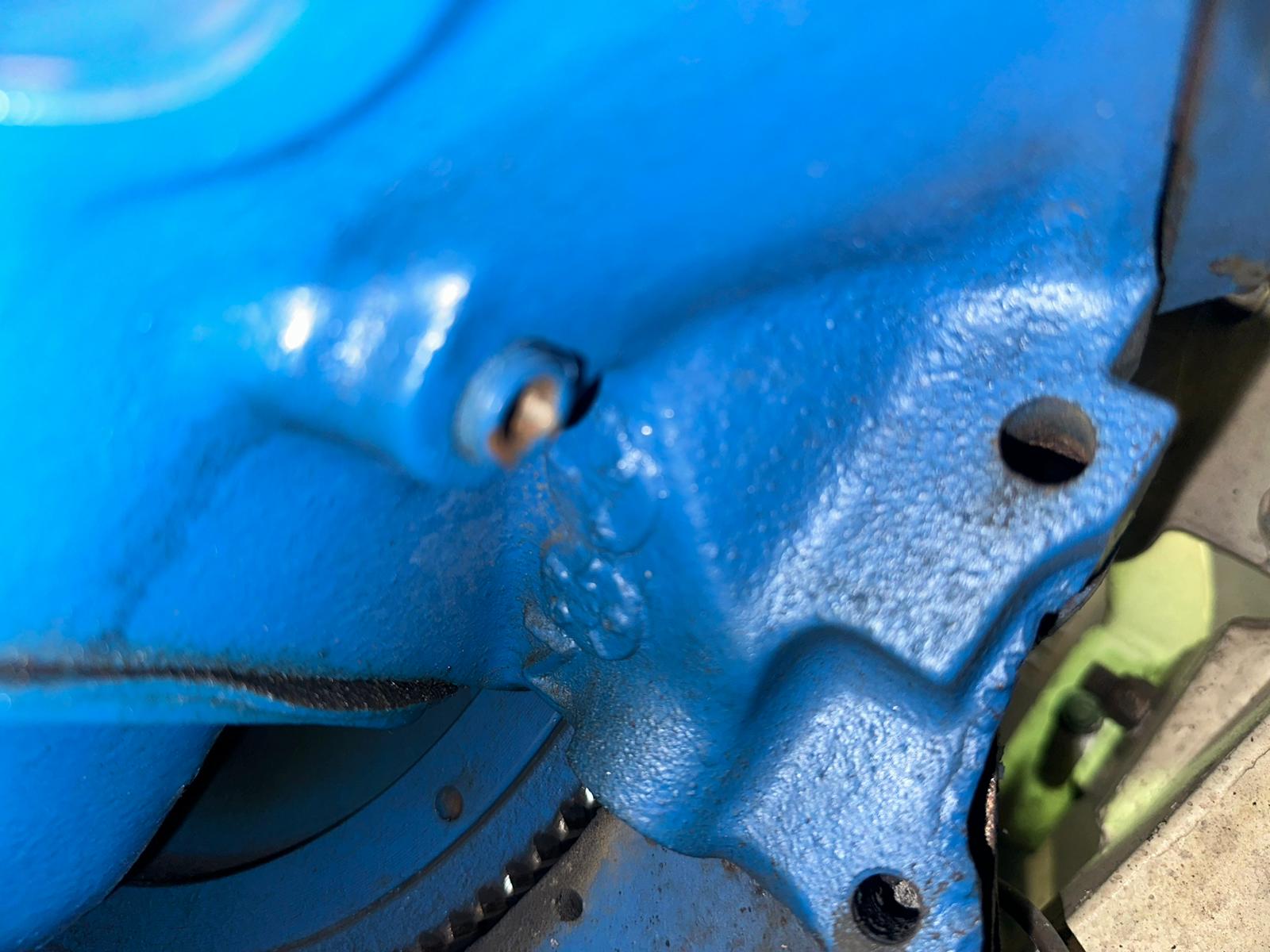

Está propulsado por un motor 298 con carburadores webber y caja de cambios Renault.
El número de chasis es de un Ford Cortina, pero no sé si es solo una matrícula o si realmente es de ese coche.
Del resto del coche no hay más novedades. No hay más información sobre los componentes del coche o quién será la carrocería, etc. No tengo trazabilidad.

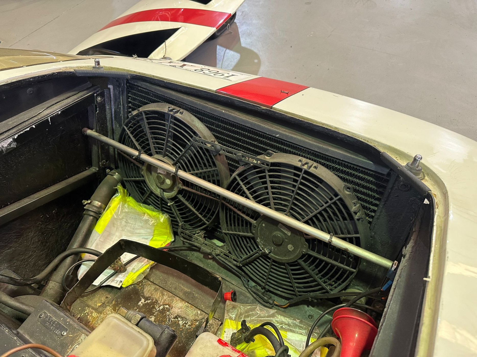

La fibra es bastante fea, con golpes y grietas en muchos lugares.
Acudo a ti para ver si puedes orientarme con las fotos que te muestro.

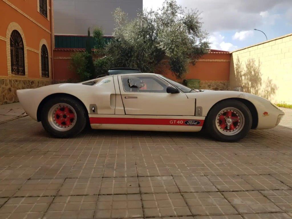

Possibly Ken Saunders car
From memory an early KVA car with some modifications.
A long time ago it was possible in the U.K. to get an Old Ford log book like Cortina / Mistang etc which was registered as a two axle coupe. The v8 engine number would be transferred to the log book and after that a notice advising it was rebodied to look like a GT40. This loophole in the registration process stopped with the SVA process and now IVA inspections.
I do not know the registration process in Spain but France does not like home built cars. There were some in France but they returned to the U.K. to get an annual MOT inspection and under the then EU rules they could be used on French roads.
Ken Saunders moved to France circa 2000 with his KVA, along with Mike Osborne with a Tornado to renovate a farmhouse ‘Forty Towers’. I believe Ken held onto the car until his passing in 2019.

Hello Ben, we were in discussion when I was planning to buy this car. From the photo and the history, it could be an old KVA or a French car built by Marcadier in France in the seventies. Marcadier produced les than 50 cars. The Marcadier were equiped with a V6 for homologation but some owner put a V8 after the got the pink slip.
There is one for sale in France presently, with V6 ; may be you can compare the two.

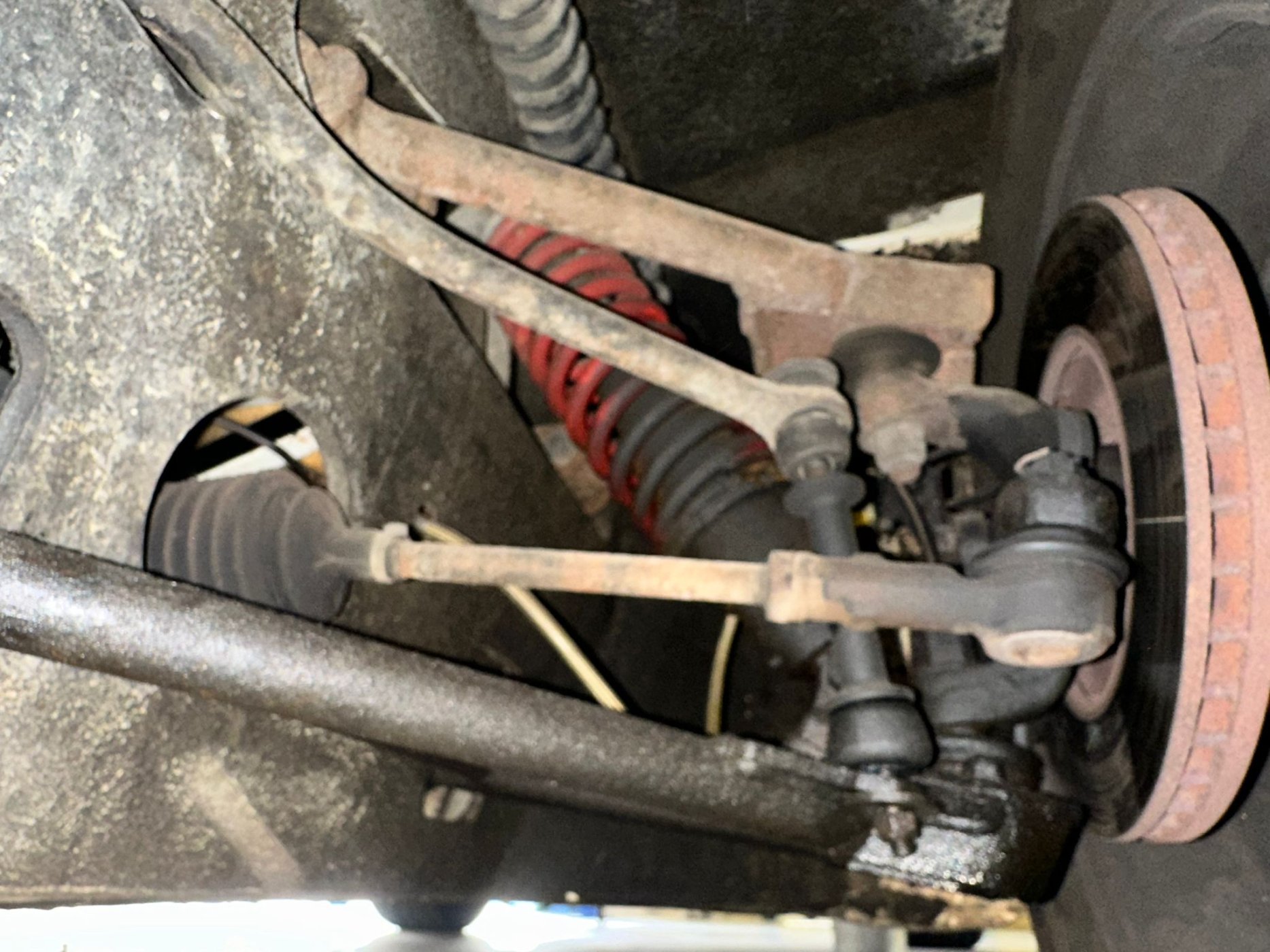

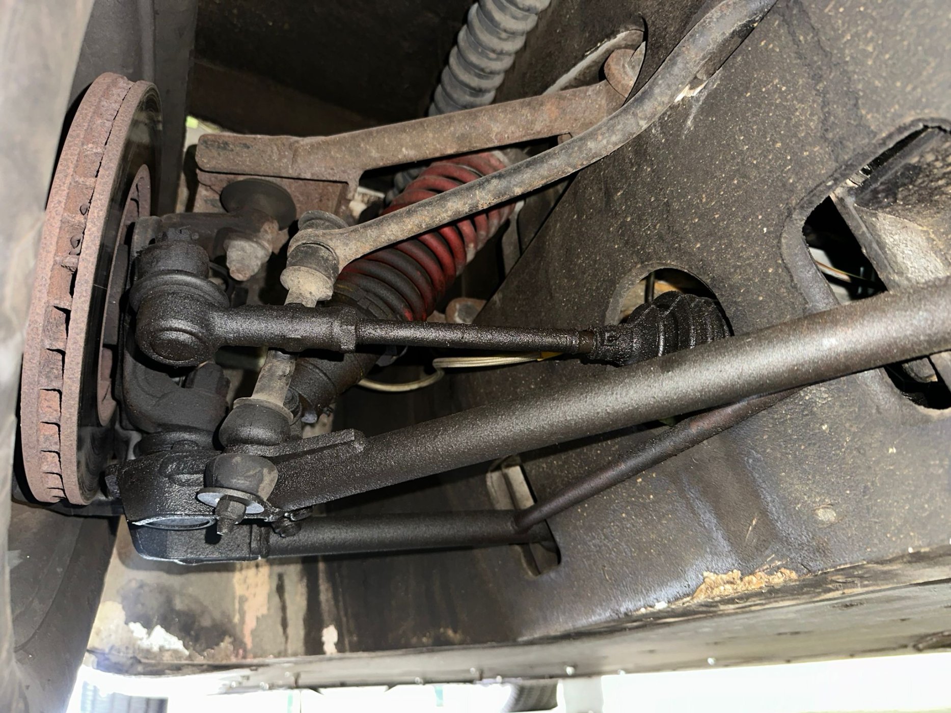

Looking at the front and rear suspension it is a fairly standard GTD.
It is not Ken Saunder's car as that was brought back to England by ken's niece.
Brian.
One thing I Remember Ken doing was fitting a Cleveland V8 not the Windsor V8s fitted by most of us. Not sure if he ever changed it.
I recall the same, and machined his own rims to fit a Countach tyre on the rear. Hopes for my first trip to Le Mans sank bleeding brakes at first light prior to a broken driveshaft on the way to the ferry. Maybe too much grip / oomph for a 90’s home built? We jumped into a backup car where I met Mike Osborne’s daughter and a 10yr relationship blossomed over the next week and so a memorable trip!
En cuanto a la suspensión delantera y trasera, es un GTD bastante estándar.

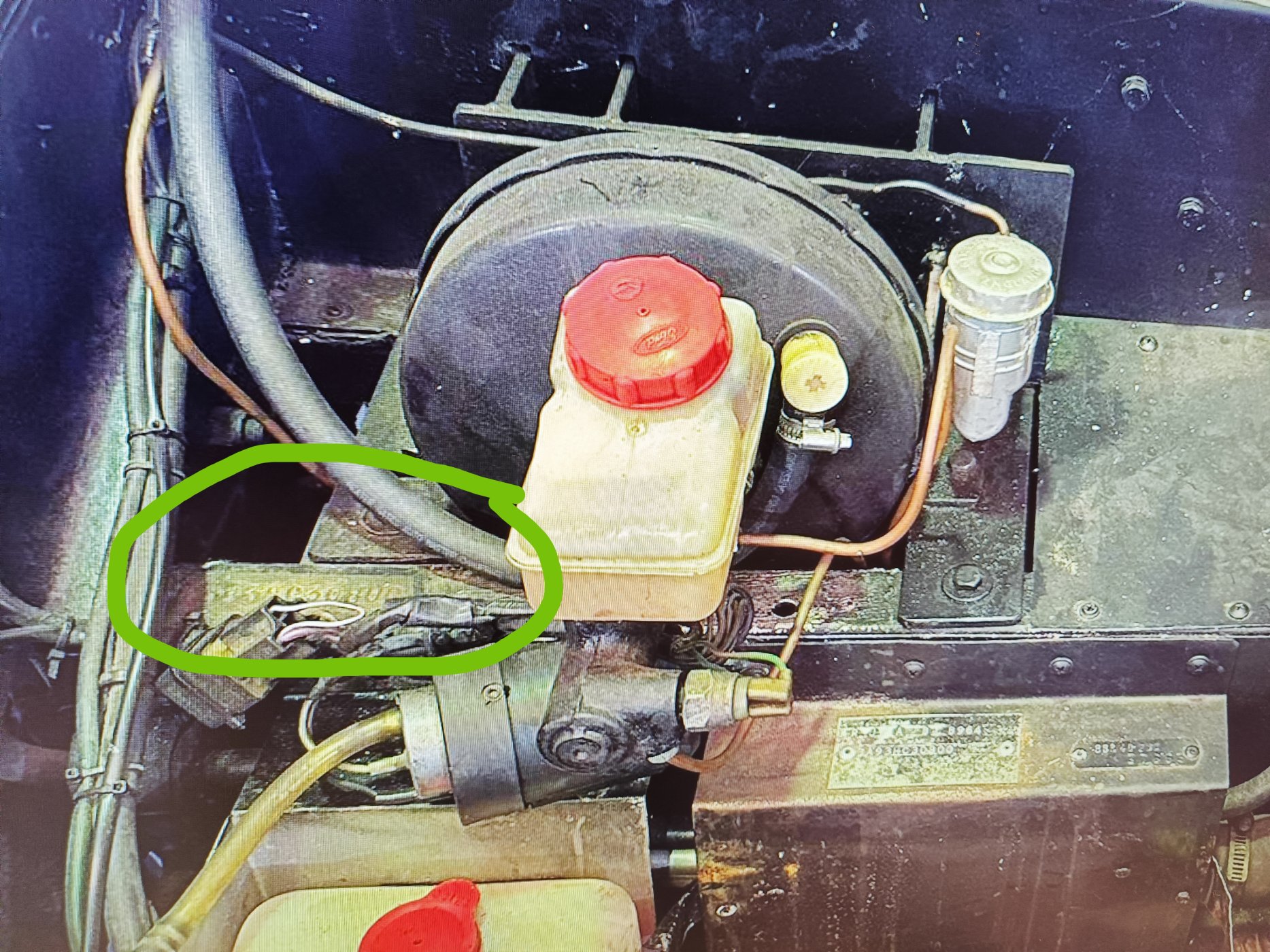

In you picture No 9 of the brake servo, to the left of it you can see a number on the rail., not the other numbers in the center, Either that is the number or there is a new number on a plate over the top. I am not going to take a guess of the value. You will have to decide what you are willing to pay.

En su imagen número 9 del servo de freno, a la izquierda puede ver un número en el riel, no los otros números en el centro. O ese es el número o hay un nuevo número en una placa en la parte superior. . No voy a adivinar el valor. Tendrás que decidir cuánto estás dispuesto a pagar.

Tienes razón, no lo había visto. Sacar una foto de ese número será lo primero que haga cuando vea el coche.
Supongo que ese numero nos dará información para saber si es un KVA o GTD ¿verdad?

Me han enviado el número al que te refieres y como verás en la foto es el mismo que aparece en la placa del centro y coincide con el número de chasis de un Ford Cortina. ¿Esto no nos ayuda para saber si es un KVA o GTD, verdad?
