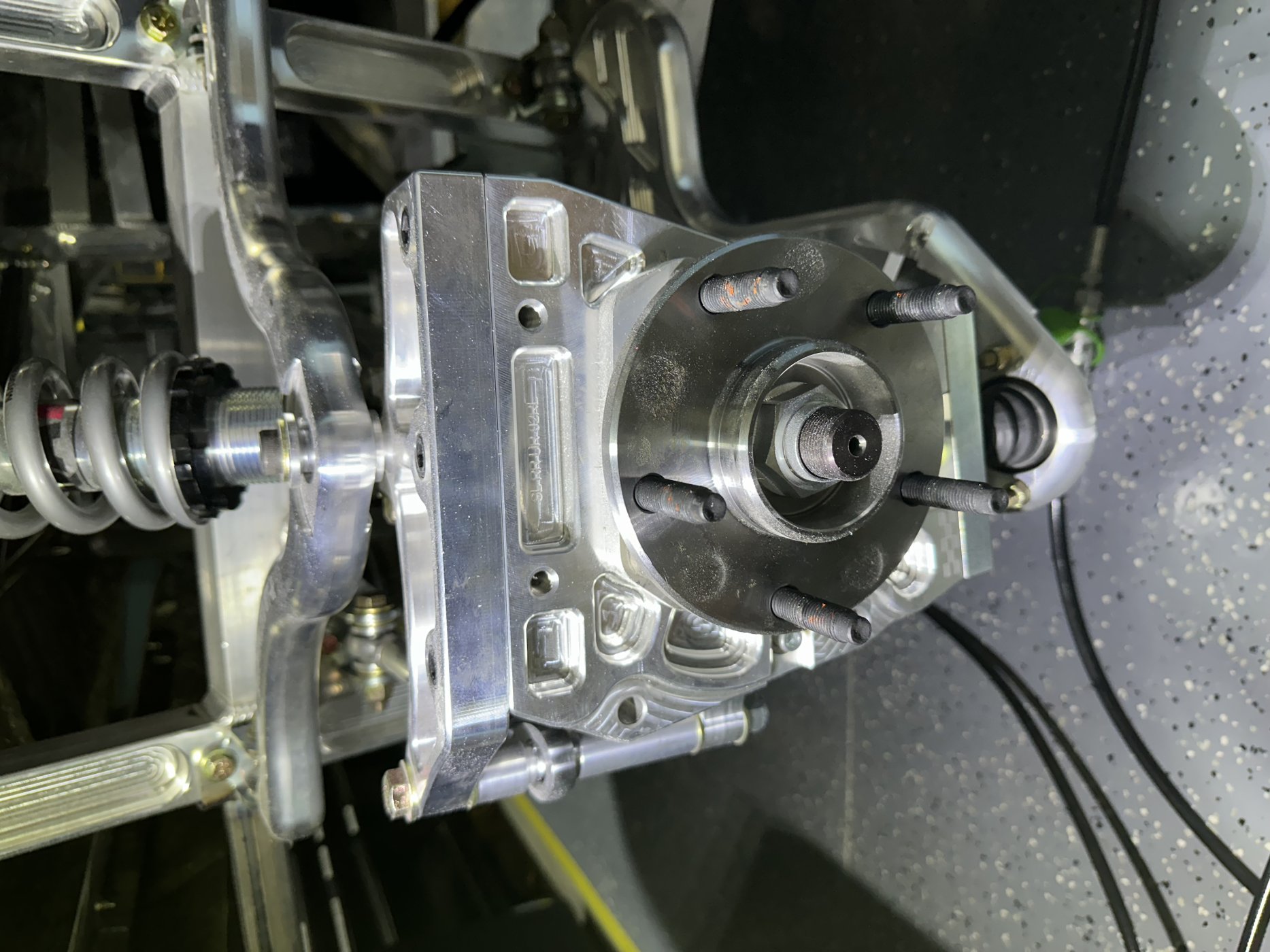

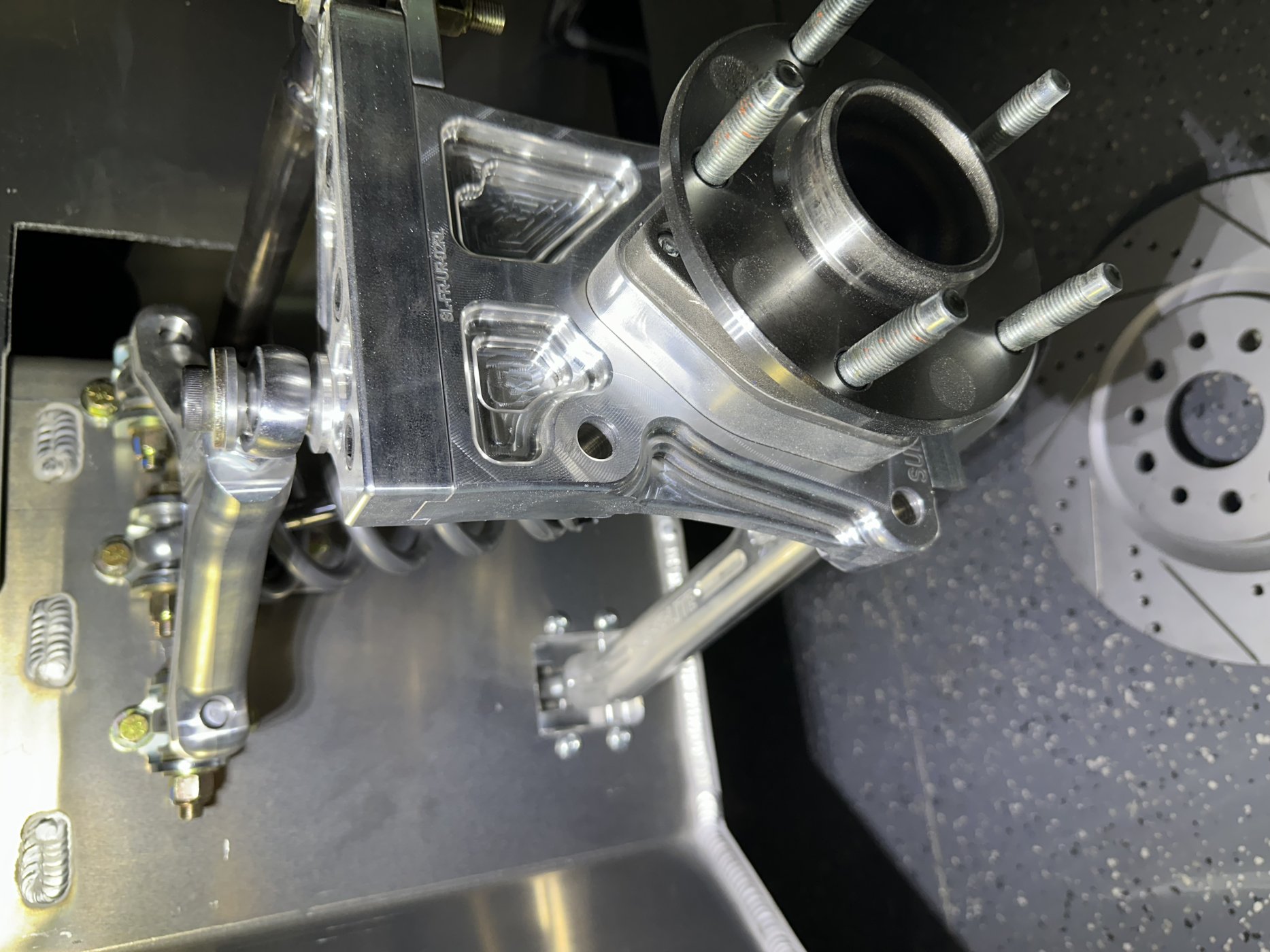

I have just begun my Superlite GTR Build and i am starting bottom up. I am sending the corvette calipers out for powder coating but looking at the suspension everything looks reslly good. Has anyone coated or painted any of the rods or arms? Not for appearance purposes just looking to protect these parts. Any suggestions?

I think you will find multiple posts by Randy V (Big Foot) and others about coatings hiding possible cracks, especially in aluminum parts. Anodizing is probably the best option if coating critical aluminum parts such as the control arms.
