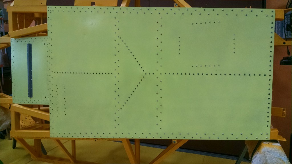

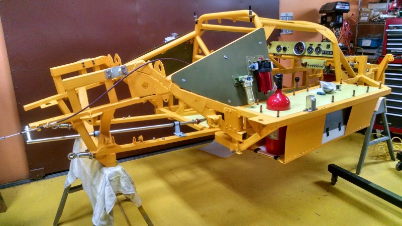

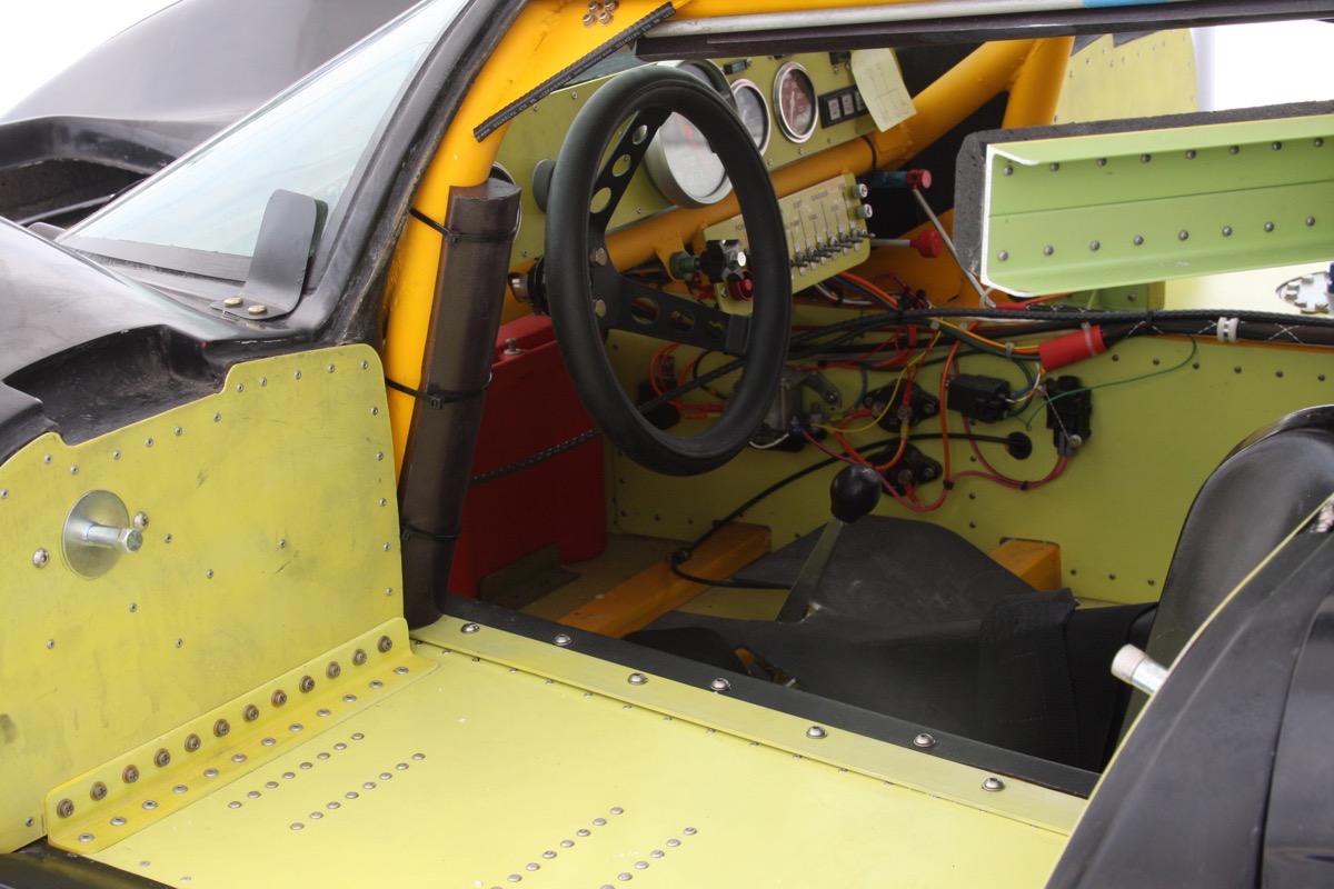

Standard aircraft practice on aluminum is to use a self-etching zinc chromate primer and (optional) topcoat. The epoxy primer from Aircraft Spruce gives you a nice hard glossy yellow green finish. On my steel tube chassis, I used a yellow topcoat of an aliphatic isocyanate polyurethane. It is made for high-performance aircraft. $$$ This is not a GT40.

Weather resistance of aluminum depends on its alloy. The highest strength alloy, 7075-T6 is corrosion prone but 5052 has far better resistance to corrosion but far lower strength. Paint or bare- it's your choice.
Personally, I prefer the Zinc Chromate and Urethane paint. A number of people have gone the powder coat route - but I’ve found that powder coating alloy really works best if you sand or otherwise put some “tooth” in the surfaces to be coated.

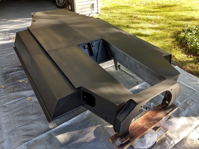

Pat, I like the look of shiny aluminum also, but after restoring a bunch of old British motorcycles, got tired of trying to figure out ways to keep it that way. So I decided to go a completely different route and used a product called POR-15 on my RCR aluminum chassis. After spraying 2 coats of Base and 2 coats of Top Coat, it came out a very nice matte black finish. I think it looks great in contrast with all the other CND'd aluminum suspension parts on the car. However, if you are still prone to shiny, you might look at a product called Sharkhide. Super easy to apply, I used this on the aluminum panels of a FFR Cobra replica that I built 8 years ago and it looks just as good today as when I first applied it.
Rod

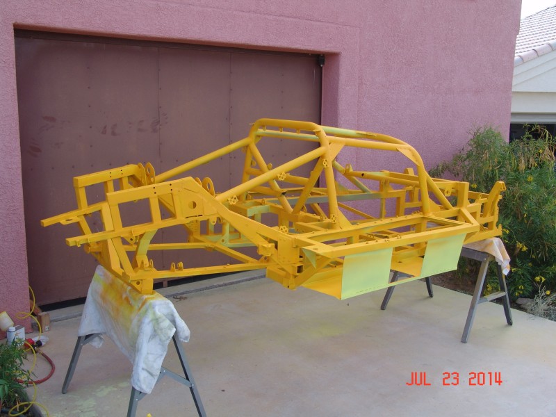

Unless you do not like the color of zinc chromate it is not necessary to topcoat it. The epoxy primer itself is hard and glossy. If you wish to topcoat it , a n aerospace quality 2-part Polyurethane is a very good choice. I used a light orange polyurethane over the zinc chromate primer. In this photo you can see the difference in colors. Black is popular for a chassis color but I wanted a bright color.
