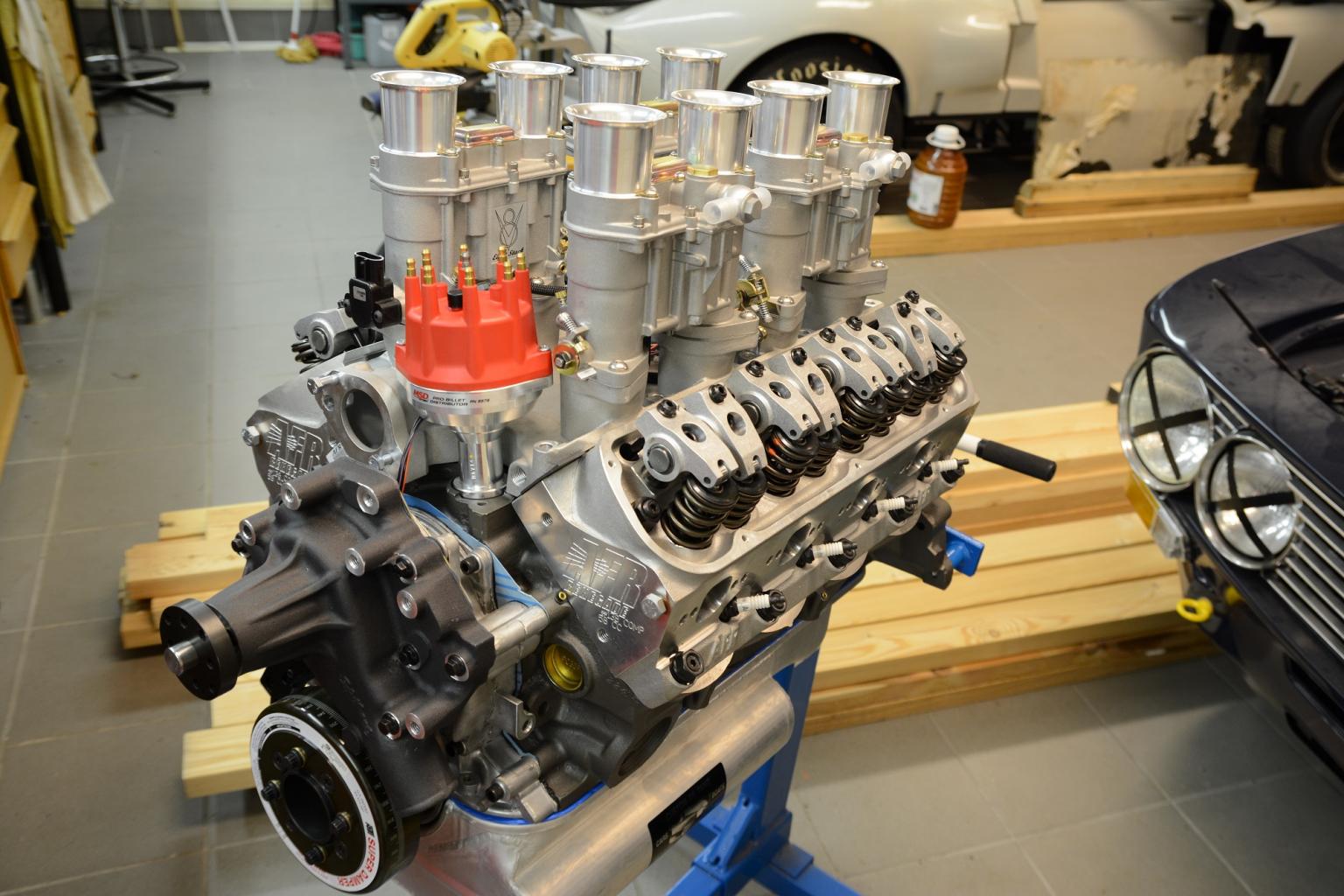

Paul, not running the 8 stack system but the Pro Comp system instead.
That said it is not running yet, but i picked the MSD Pro Billet #8579 for space reasons !
At 4.75" OD it was the smallest i could find that would fit comfortably.
You may not have the same issue with the 8 stack but just thought i would raise the issue.
Andew

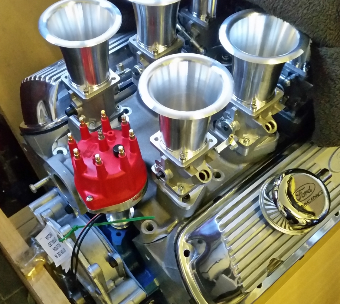

Hi Paul,
Like Andrew I picked the MSD-8579. I can confirm that it fits the Eightstack intake manifold. Also like Andrew I haven't run anything yet. My intention is to have a crank trigger for timing and use the 8579 as a "cam position" sensor.
