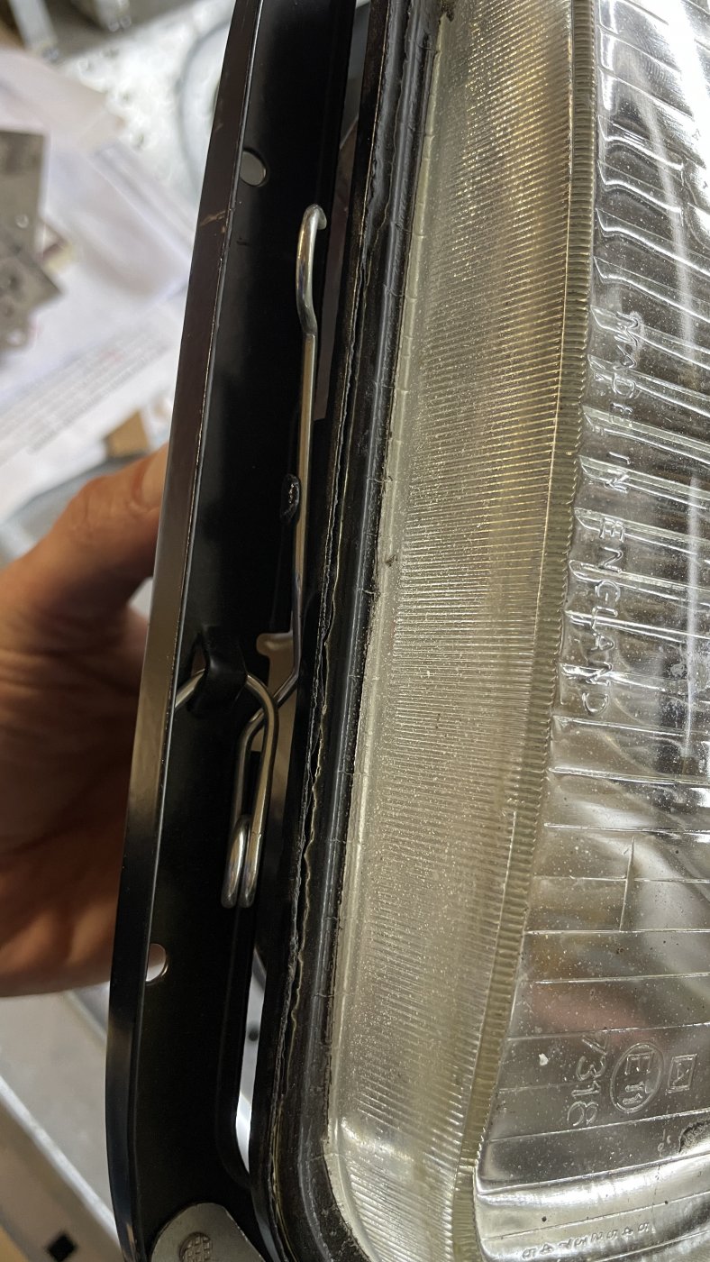

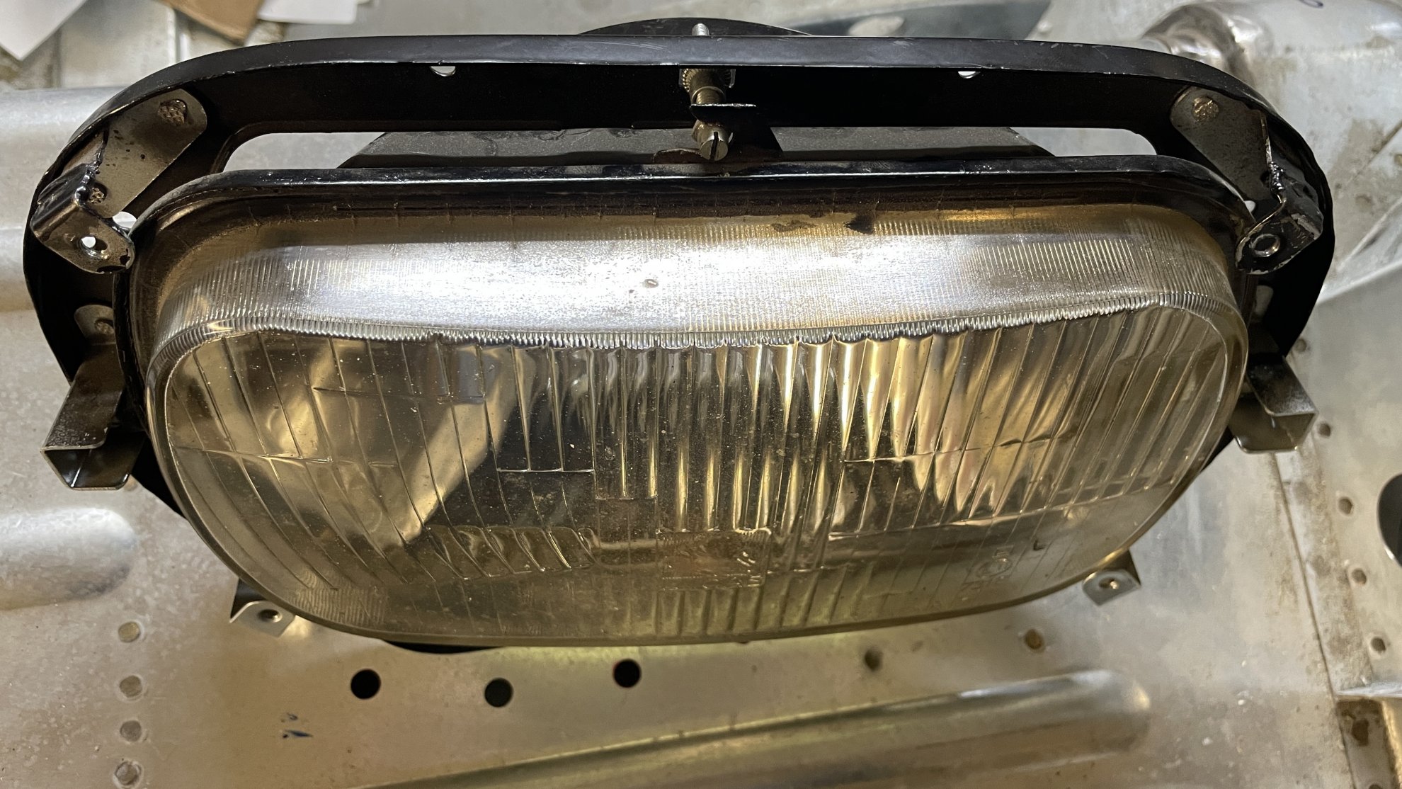

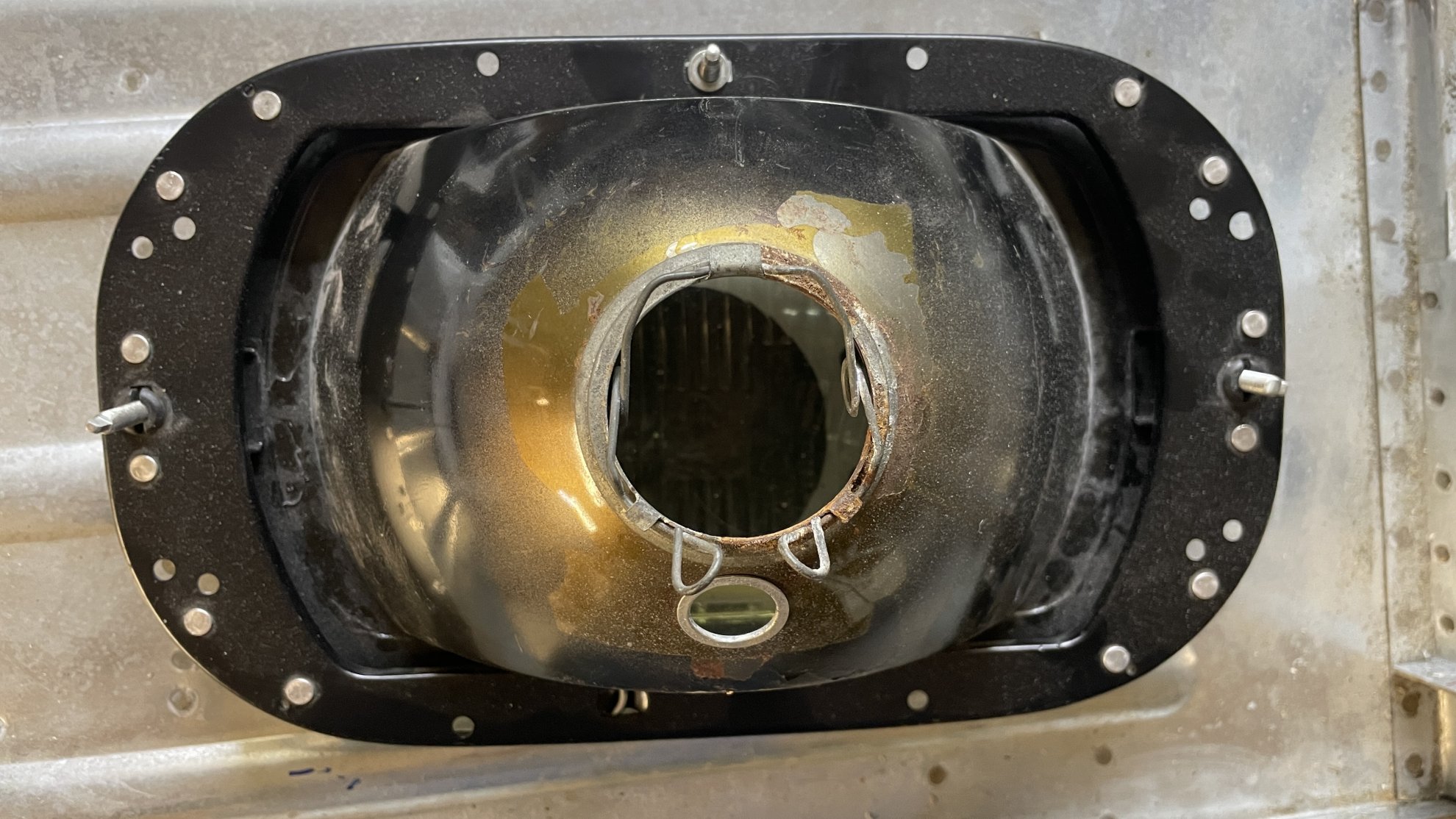

So off came the nose shell, we removed the access panels behind the headlights and removed the headlights. On inspection, we figured out that when the fastening screws, attaching the nheadlight units to the brackets, are tightened from behind, the whole headlight unit is actually pressed against the fibreglass shell and can‘t move anywhere.
Has anyone had this problem and an idea for an easy fix? I thought about putting some spacers between the brackets and the headlights to move the whole unit back into the cavity and allow for adjustment.

There are 4 screws, one each corner onto the light backplate. Adjust accordingly to get light beam within spec.

The problem is that, when the screws that attach the mounting frame to the brackets bonded to the car, are tightened, the light unit is pressed against the cutout in the fiberglas shell.
The only idea I can come up with is to use some kind of spacers between bracket and mounting frame to move the whole unit backwards / inboard, so there is some play between the light unit and the shell to allow for adjustement.

Just shim to suit I guess. Bit fiddly though.
