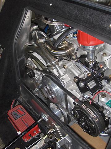

I imagine Fran has a fix for that:) Attached pic shows our short accesory drive package that accomodates forward and low (correct) engine placement. This setup will run with an almost flat firewall panel, only about an inch protrusion needed to clear the water pump nose and a/c pump clutch. There is all kind of space for air circulation to minimise heat soak.
The A/C Bracket is a CAV Canada part that fits any small block Ford water pump and aligns with all pulley configurations, very trick part.
Your simplest suggestion would be a horizontally oriented water outlet fitting rather than the OEM Ford part pointing strait up, works in a Mustang but this is whole different horse. Could be custom fab part but simple enough to make. We do that kind of work too...

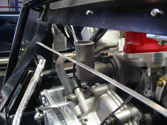

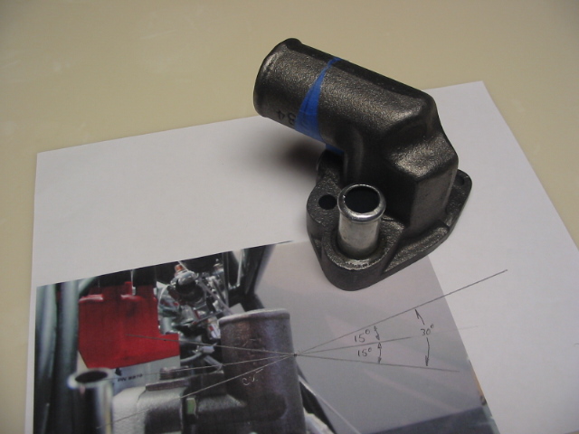

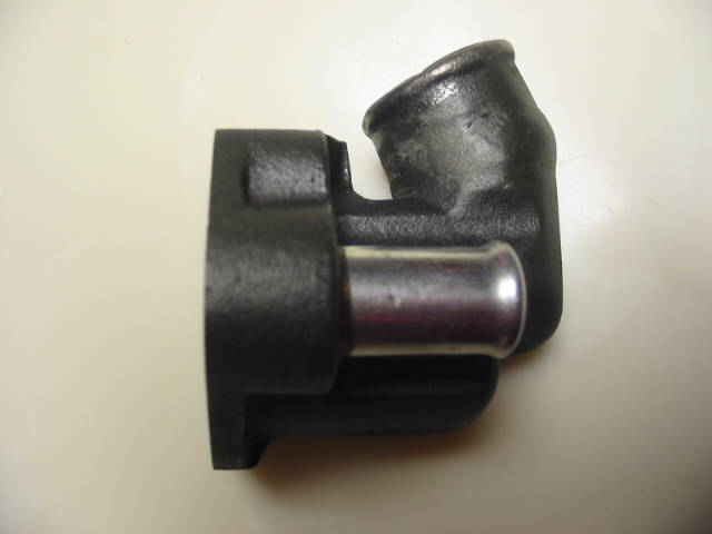

I had the same issue. I wanted to keep the thermostat in the 'standard' location, so opted to modify a standard thermostat cover.
Finding a thermostat housing that would fit proved to be a real challenge. We finally settled on a generic housing (Stant 31418) and then cut out a notch and re welded it with a 30 degree backward angle.
I had a local welder cut the fitting and do the welding. For a pro this is an easy job and he did a nice job. I did make very detailed drawings so there would be no confusion.
A 180 degree thermostat was used. A standard Ford 302 bypass hose was added.
Even with this set up, the thermostat cover protrudes about a quarter of an inch inside the car, so a small ‘bubble’ will be added to the removable fire wall, similar to the bump to clear the pulley. I estimate that I will cut out a section about 6" long by 3" high and bring it in about a quarter of an inch. It will have no effect on the passenger seat and should be fairly inconspicious. This arrangement is tight, but there is enough clearance to, hopefully, avoid any problems.
I will make sure that the rubber hose does not contact the fire wall to avoid any wear due to engine vibration issues before this project is complete.
I looked a long time for a prefabricated fitting without success.
Your hose goes the other direction, but I expect the same approach would work for you.
Since you have a ZF tranny the mounting location of your engine may result in a slightly different configuration.
If anyone comes up with a better solution that keeps the thermostat in its 'stock' location I would sure like to see it.
A couple of pics follow. More on on by build log. Good luck.

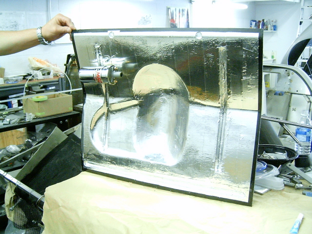

Hi Chuck, Gregg, Bill

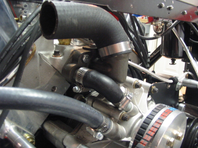

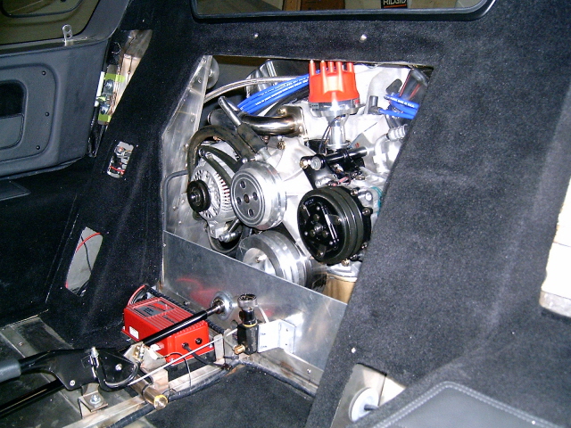

Here's a couple more pics of the same install. It's easier to see the angle of the firewall (30degees) and the low engine position. The bulkhead windows on virtually all GT40 replicas are in the same place so that's a better reference point to guestimate by.
On the intake manifold and thermostat, there is roon for the thermostat and it's a Weber manifold so the area around the thermostat housing isn't quite the same.
The picture of the engine side of the firewall panel shows the relief for the A/C clutch and lower water pump pulley. The top half of the water pump bump could have been taken out completely but wed already had enough fun with fiberglass.
Bill, looks like an electronic distributor, what is it? I tried the MSD Electronic unit but it was WAY TOO HIGH so we went with the standard part and a 6AL
