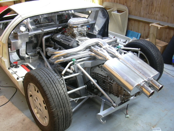

Paul, very hot looking exhausts (pun intended). They look terrific. Not much help to you over there but mine are coated in zinc aluminium which looks pretty good.

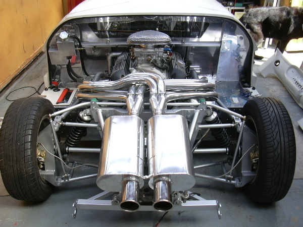

Pete, I'm probably going to go with the silver ceramic camcoating - there doesn't seem to be any other places in the UK unless you wan't it chrome .Having run the engine and felt the heat off the headers I don't think chrome would be the best option.

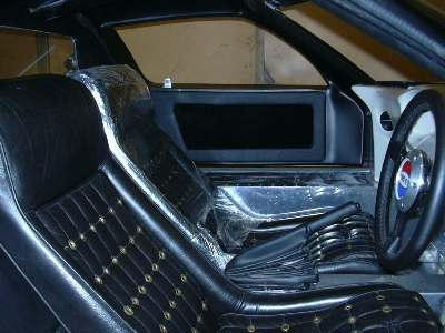

Started trimming the interior....

Thanks Clint - just got the exhaust back from camcoat and it looks great....

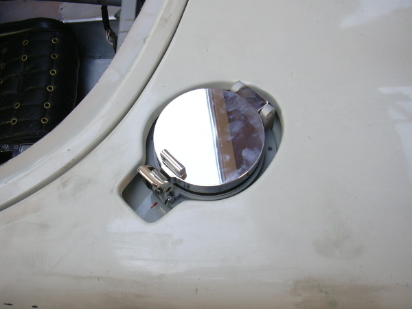

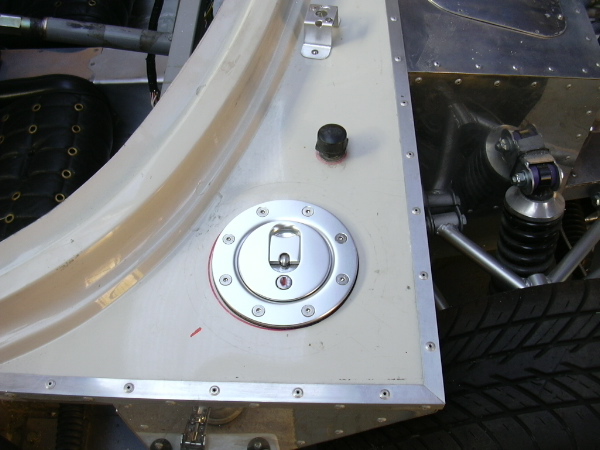

Fitted the petrol caps today, I'm using an aero style cap that will go inside the outer cap.
This also helps with the UK SVA as I'm not fitting the outer caps till it has passed.

Amazing work as ever Paul. Clever idea on the fuel caps, and the exhausts look awesome.

Thanks Pete, yes I am pleased with the coating - I toyed with the idea of chrome but after running the engine and feeling the heat I figured it is best to get as much out the tailpipe as possible. I also didn't realise that you can repolish the coating as it will dull over time.

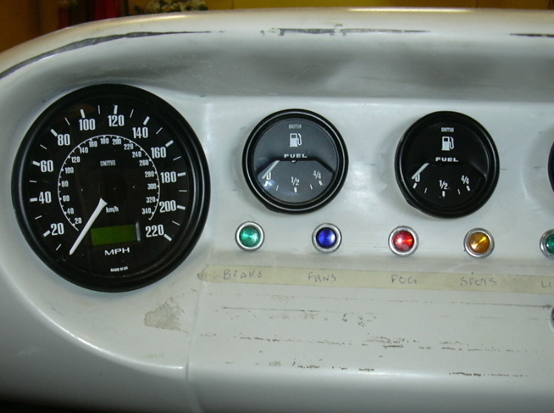

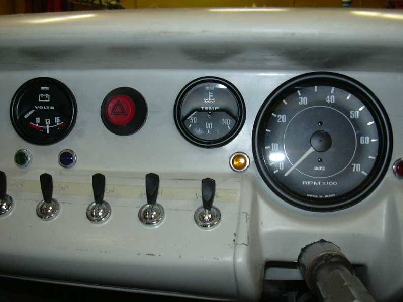

I got all of my gauges yesterday so put them in straight away - engine temp hovers around 90 degrees and sounds great. Also need to suss why my alternator and regulator aren't working properly as this stopped my fun early ! Don't think the neighbours were enjoying it quite as much.

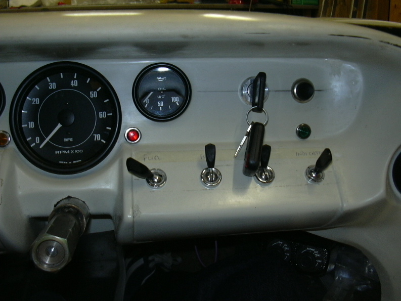

The switches that correspond to the lights on this first pic are temporarily mounted on the rhs of the steering wheel to get through sva. Once I'm through I can move them over and put the two AC controls on the rhs of the dash in their place.
A few pics of the new smiths gauges.....

Thanks Bill, to start with I am just going to spray the dash satin black, mainly because I can live with it for a while ,get through sva and then decide.
You only undo 4 bolts and 6 connectors to remove the dash ,so it's easy to cover it at a later date if i want to.

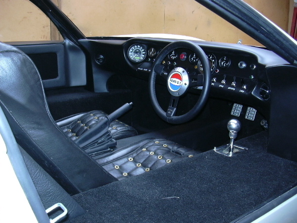

Interior virtually finished, just needs handbrake lever trim, gearstick gaitor and Harnesses.
