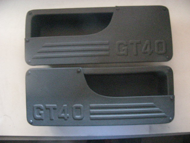

Hi Fred,
They are available as a leather covered pocketed unit from RF or as a bare do it yourself GRP shell as you are proposing I believe. At $100+gst/pr for the shells you'd have to add up materials and your time to see if you can save a dallor.
cheers PB
