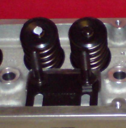

jac mac, they are studs as as supplied assembled in the head. There is a threaded sleevenut with a grub screw in the thread which locks against the end of the pushrod stud.

Right, they are what we call posi-locks. When setting your valve lash if solid lifter, or pre-load if hydraulic lifters, you turn the 'sleevenut' down until you get the reqd lash or preload, then tighten the 'grub screw' ( The Yanks wont understand us here-talking Scottish/Kiwi/English:)).
Going by your lifter/cam follower I am fairly sure thats a hydraulic cam, so you will want to preload the lifter. Here is the setting order for each cam/firing order depending on which you have. Set the lash on the valves on the top row when the pushrods/valves on the lower corresponding cyl are 'rocking' or on overlap, once you have done the top for in order start on the lower four while checking for 'rocking/overlap on the top row. If you bring the crank damper to TDC to start with it will be ready to set both valves on either 1 or 6, then turn the crank 1/4 turn at a time to set each remaining cylinder. Set preload by spinning the pushrod with fingers while turning the sleevenut down until you just feel the pushrod begin to drag, turn the sleevenut 1/2 turn tighter then fit grubscrew & tighten-YOUR DONE, thats it . IT probably will help to do this before fitting the intake manifold so that you can see the pushrod cup in the lifter depress slightly. Good luck & dont be ashamed if it takes a couple of goes to get right, I still do it wrong occasionally, especially if the phone goes! No excuse now since I disconnected it in the W/Shop!

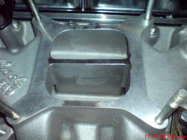

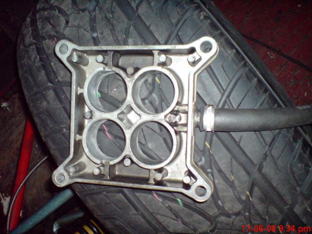

you got it in one! I replaced the 3 and 8 ignition leads and the no 8 plug, which just got it to 'tickover' stably at 2000 rpm, this gave me the opportunity to change the idle mixture to no significant effect (no big surprise at 2000rpm), but clearly there was still a way to go.
So next I removed the carb and spacers looking for air leaks, then I spotted soot marks each side of the manifold face, you can see in the first picture. Then, a look at the adaptor with the breather pipe shows that it overlaps the Edelbrock manifold letting air in on both sides. The face on the stock manifold is bigger and it seals ok.
So, I ditched the breather adaptor, cut some spacer tubes for the carb mounting studs, and reassembled with the tapered carb levelling spacer only. Now ticks over fine, and I will sleep well tonight! There is some tappet noise, so I will go back to the 1/2 turn preload, check torque the head bolts and box it up.

Good one, you might find your carb has a blocked off or unused 3/8" fitting that you can use for PCV if you need it. Brake booster if fitted should source from intake runner of manifold rather than carb base.

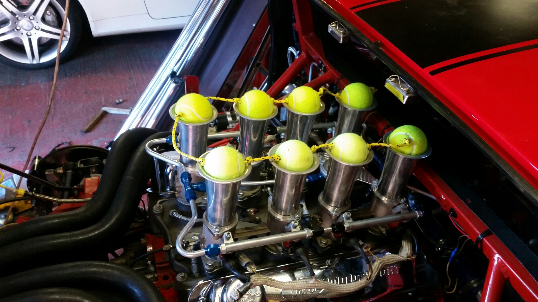

I started for while, all seems good and now relocated header tank and fitted a new throttle cable. Ready to tune settings at idle. Must remember to take the tennis balls out
