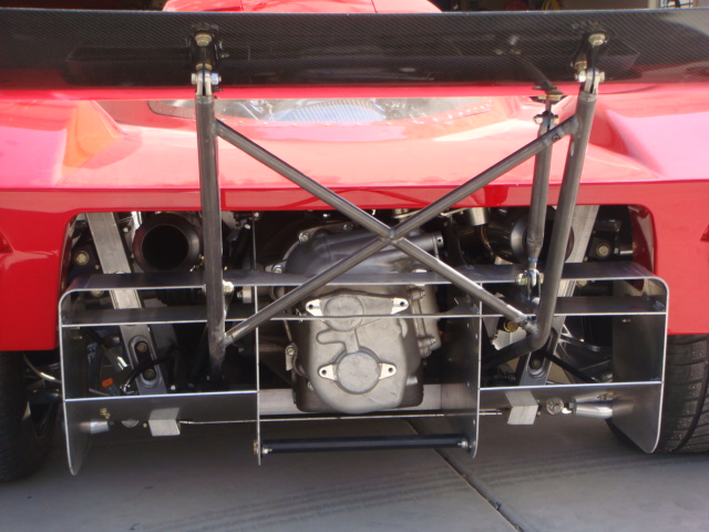

I can't remember who's car this is. But I am curious if you have a picture with the rear clip opened up? Do you need to remove the wing to do so? If so, how do you do it? Pictures would be very useful.
Also while you are at it, could you snap a couple of the henge and mounting hardware to the diffuser.
Thanks in advance.
Howard

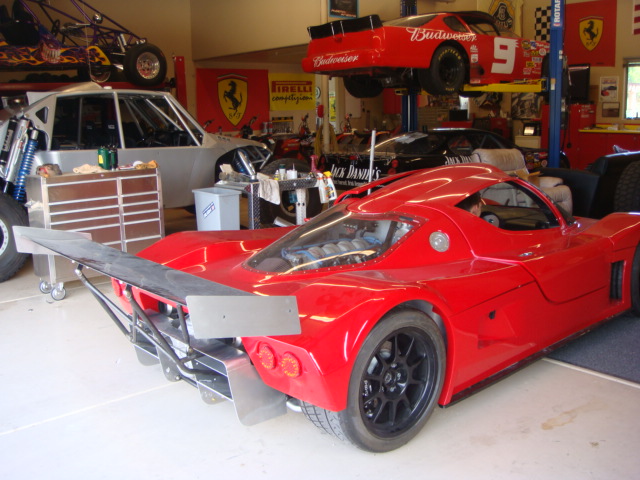

Howard,
That's Tim's car, one of the very early chassis. It has a custom-fabbed wing mount, but I don't think it flips with the clip.
I don't know if Tim frequents the board much now, since the car is complete.
Thanks in advance.

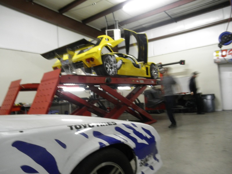

Howard, here is a shot of my rear clip open with the fixed tail. it's a workable amount of room to do quick work. You have to limbo a bit to get back to the ricardo linkage. If I'm are doing any significant work, i'll probably have to pull the clip. That was Tims car in red.

Cam. So if you don't move the alum wing mounts at all then you can open the rear clip as in the picture, correct. I am interested in being able to open the rear clip for tech inspections at the track. I intend to remove the rear wing when the car is in the garage anyway. I may even routinely remove the rear clip to do pre-track prep shop work.
Howard, yup, you can get at the shock setting and snake your way to most suspension bolts. I don't have struts yet, just a temporary matco support. Is your exhaust exiting the back or sides?
