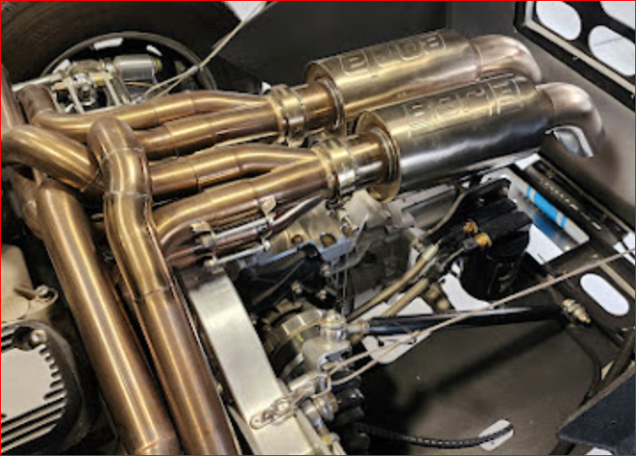

Option#1, Went for a ride in an RCR GT40 with this Borla exhaust and was pleasantly surprised. Without windows mounted on the car (intentionally), I had my head leaning at the edge of the door, to hear the exhaust over the mechanical noises of the engine and roadnoise. Suprisingly relatively quiet, and could live with it on the street.

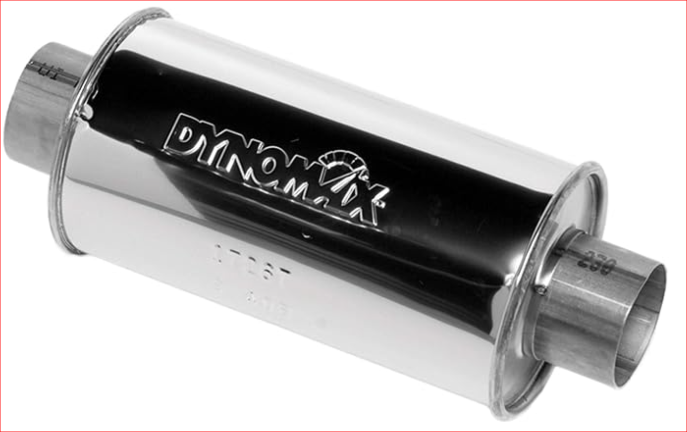

Option #2, I have always ran Dynomax mufflers on the past several cars. Liked the sound, and preferred Dynomax vs Borla on the same vehicle.
So I am undecided (at the moment) myself, but I am quite certain it will be either Borla or Dynomax.
Unless/until I find someone with the Dynomax muffler, and go for a ride, for the final definitive decision.
Have a Sound meter (I used to host Opentrack events, and needed to play Sound-Police), and will probably run a few sample clips to compare.
https://www.amazon.com/Dynomax-17267-Ultra-Stainless-Muffler/dp/B000CIXNSQ

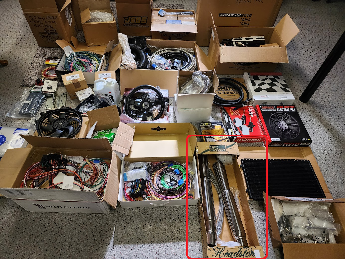

I have the standard RCR cherry bombs and still converse when driving. It also will still stir the soul when prodded as well. Not sure I'd change them for anything quieter, but this is all a very subjective matter.

Standard RCR Cherry Bombs? I don't remember them ever mentioning those to me when I ordered/built my 40. I purchased the 'snakes' from them but no mufflers. Got a picture?
Rod

I recently asked Fran about mufflers. He said they don’t sell them.
