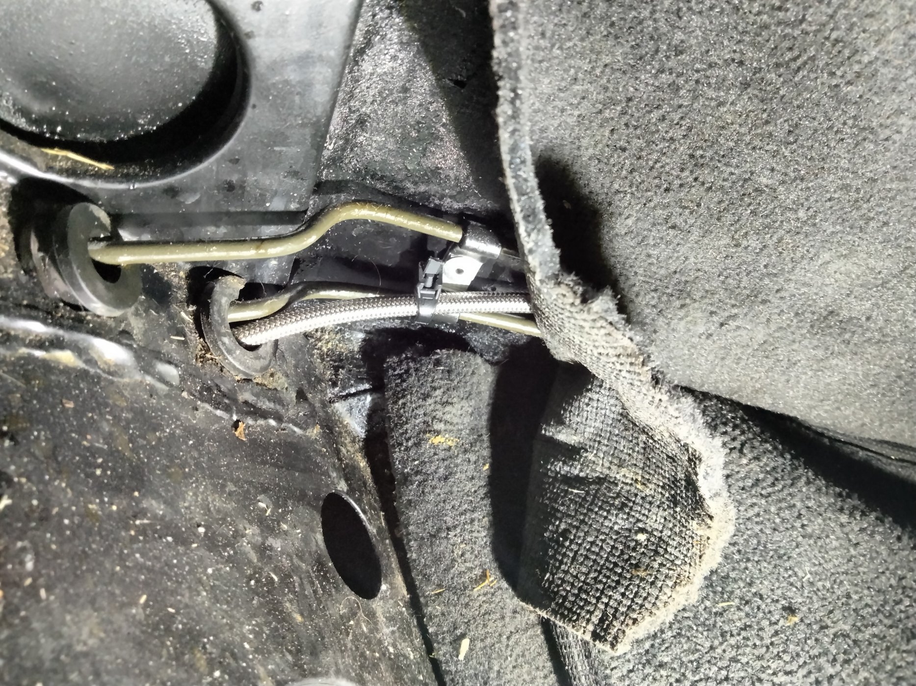

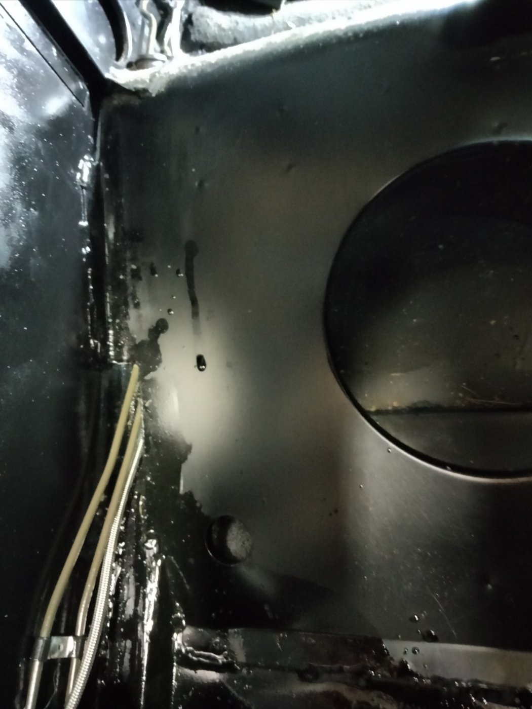

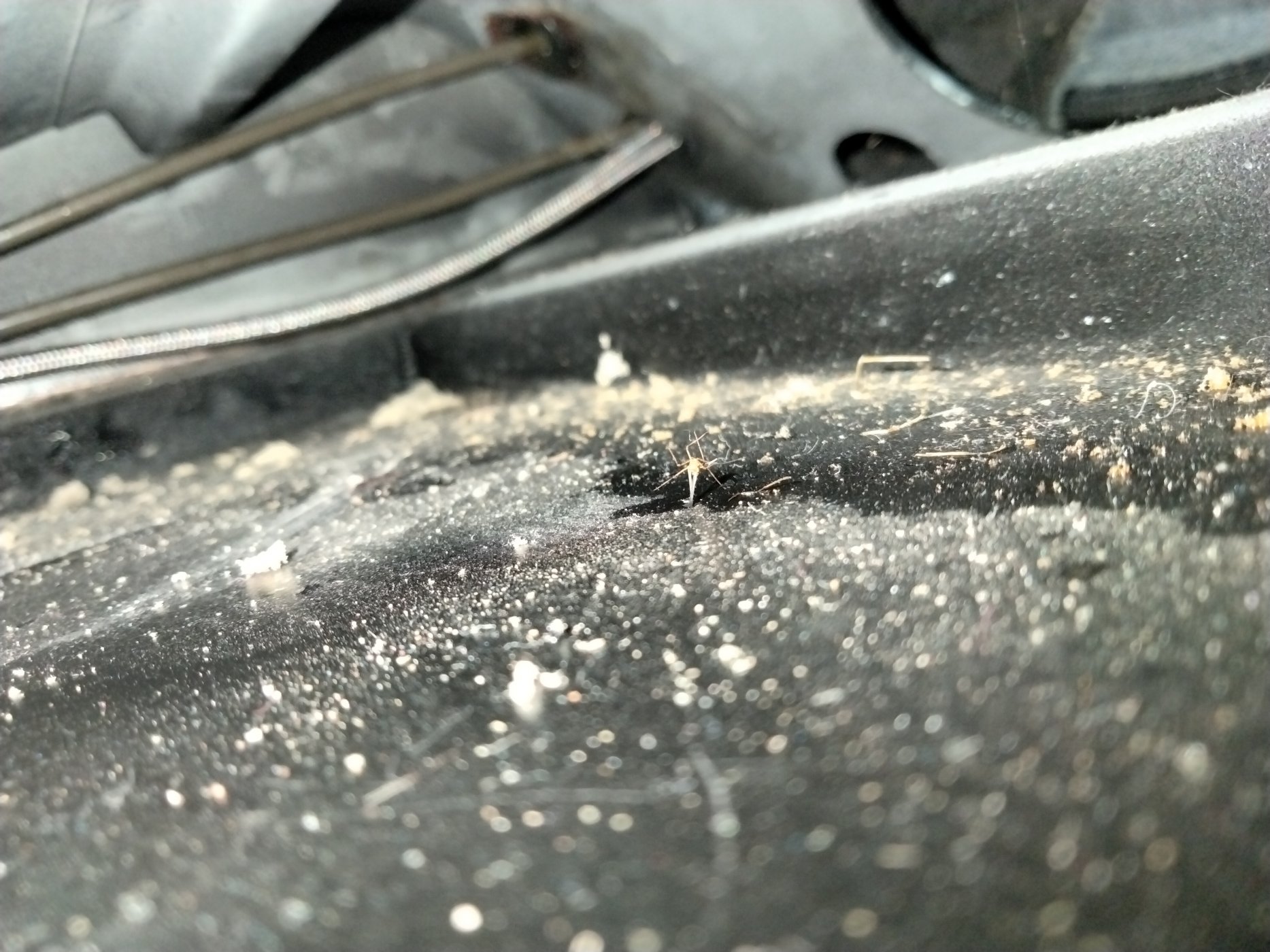

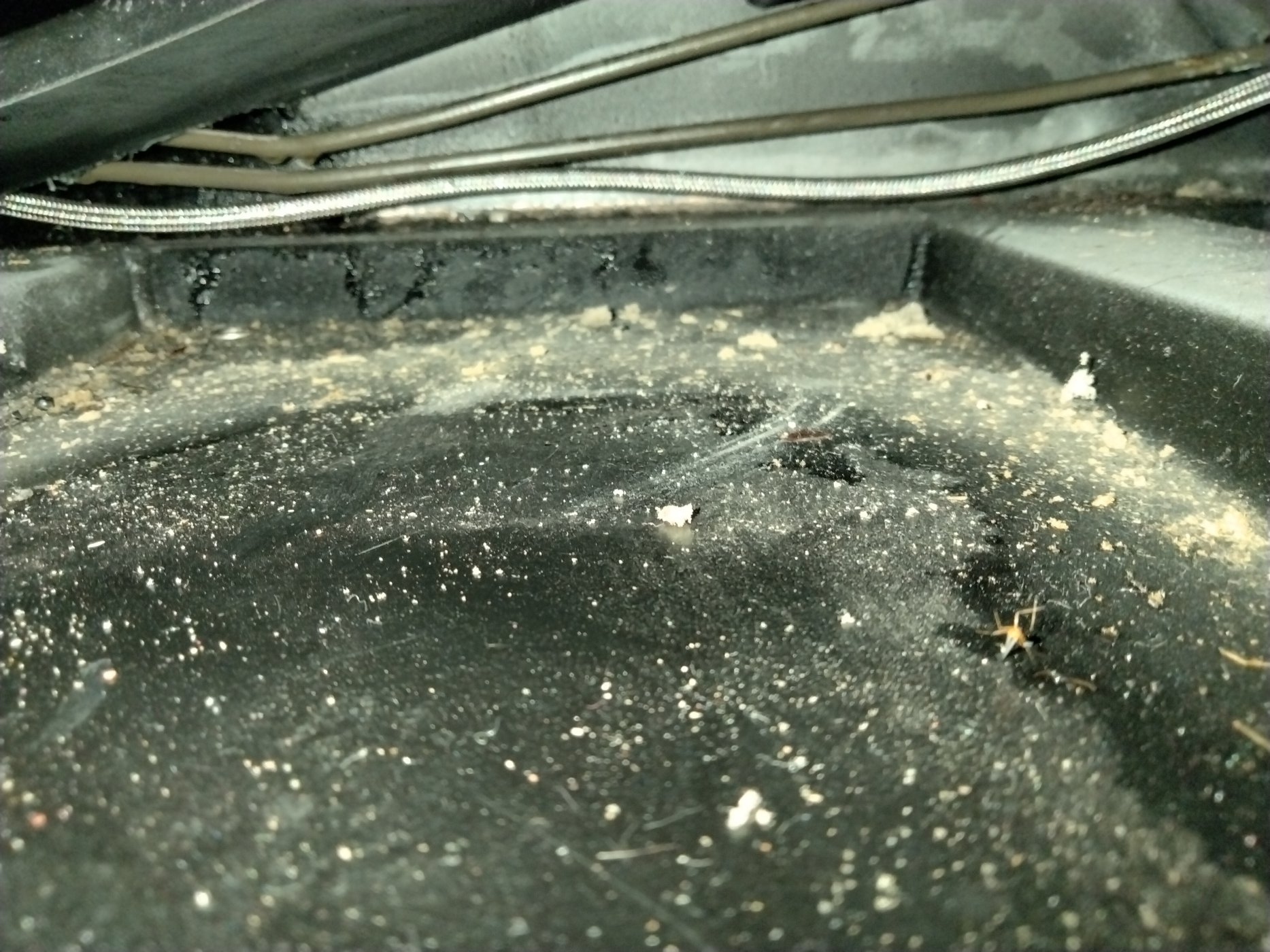

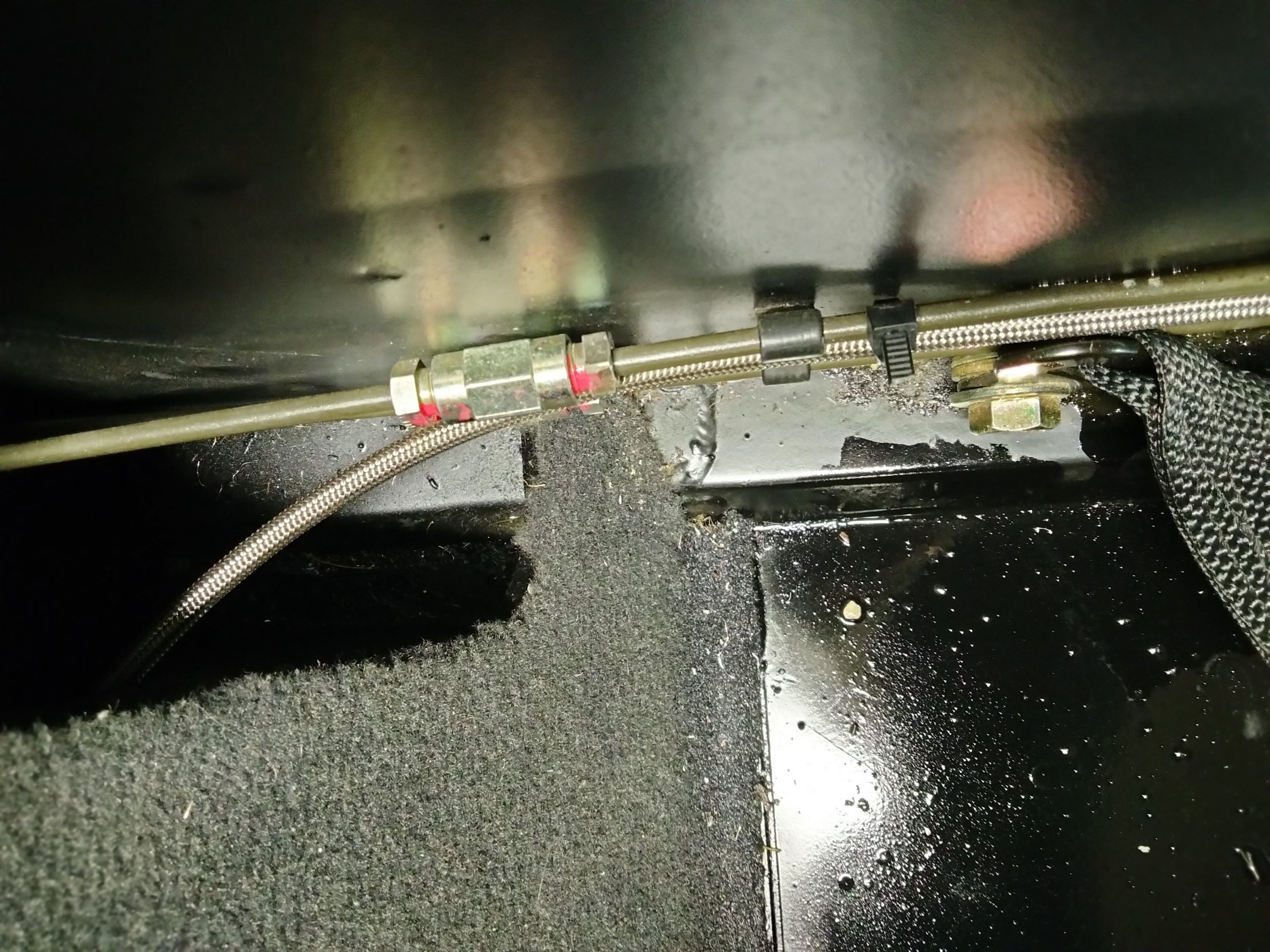

1st pic dry coming from pedals. 2nd pic dry entering bulkhead. Leak somewhere in last three pics. Will refill res and pump clutch pedal to see if I can identify exactly where leak is.
Will verify, but looks like the bottom/lower of the two metal hyd lines belongs to the clutch. Assuming it's the one leaking, seems to me simply replacing that line with a braided stainless steel line would be the way to go.

Installed braided stainless steel brake and clutch lines from double junction (top clutch, bottom brakes) to the left at the bottom of clutch pedal. Fittings were entertaining. At this double junction, installed two male 3an to male M10 x 1.0 inverted flare (convex cone at bottom of fitting) both top and bottom. Two braided stainless steel lines with female 3an on each end were connected to these front fittings. After try and error, found that rear fittings, adjacent to drivers seat, required two male 3an to female M10 x 1.0 DIN concave fittings (accommodates DIN bubble flare (concave) on the 3/16" brake lines coming from rear of car). These two fittings arrive from Pegasus Racing Tuesday. Then will bleed clutch and brakes and check for leaks.
