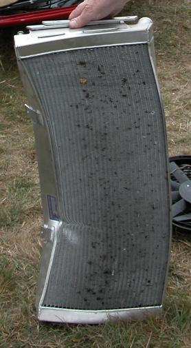

Very good rads - the one pictured below (from a GTD) did'nt leak despite about a 9" 'bend' in the middle following an altercation with a 1tonne straw bale!
