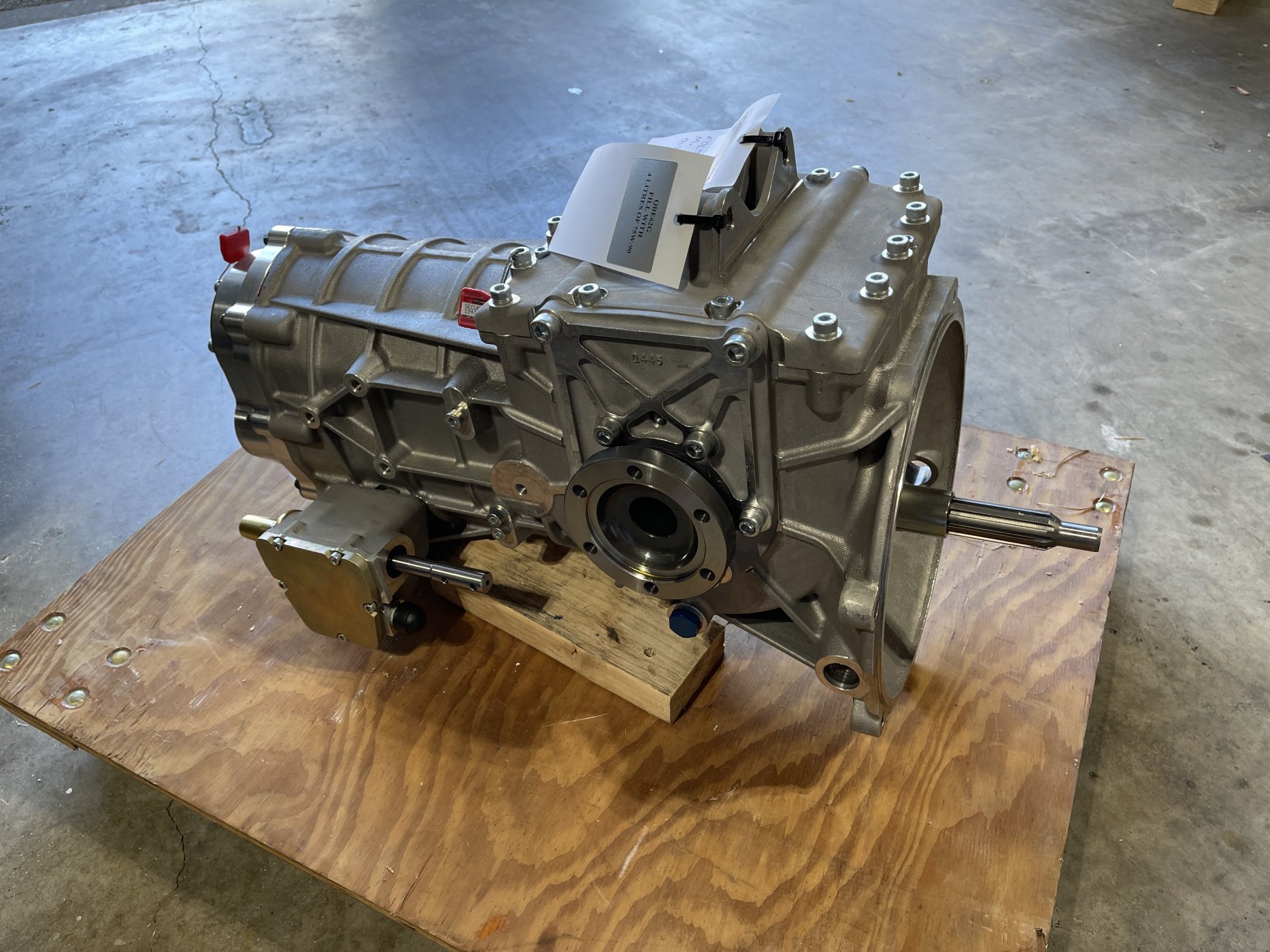

Learned something new this week about the Quaife transaxle. Turns out, a base transaxle order does not include the clutch lever assembly (fork, bearings, shaft, etc.). Those parts come as a package from Quaife for an additional £599.50 (QKE62G001). Fortunately, Bob Wood at Safir was concerned that I might have not included those parts in my order from Quaife and called. Turns out Bob has a more suitable set of parts ($45 less at current exchange rates). Safir’s clutch lever assembly has roller bearings instead of bronze bushings, the lever shaft is a bit longer, and it includes seals. Anyone combining the Quaife with Safir’s clutch package also needs to include Safir’s $236 clutch shaft. There is a one spline difference between Quaife’s shaft and the shaft that fits Safir’s clutch.
Porsche made a bonehead error on their G50 throw out shaft bearings. Needle bearings were a terrible choice- any experienced engineer knows that needle bearings are suited for continuous rotation but not for limited angular motion. The grease develops a "channel" with repeated back and forth motion and the resulting lack of lubrication that caused eventual failure. The replacements all had solid bronze bearings. I would be very leery of roller bearings in that application as well!

I read somewhere here about those needle bearings. I will ask Bob if there are similar concerns with Safir’s. Certainly, it is an easy fix to use bronze bushings. Thx much.

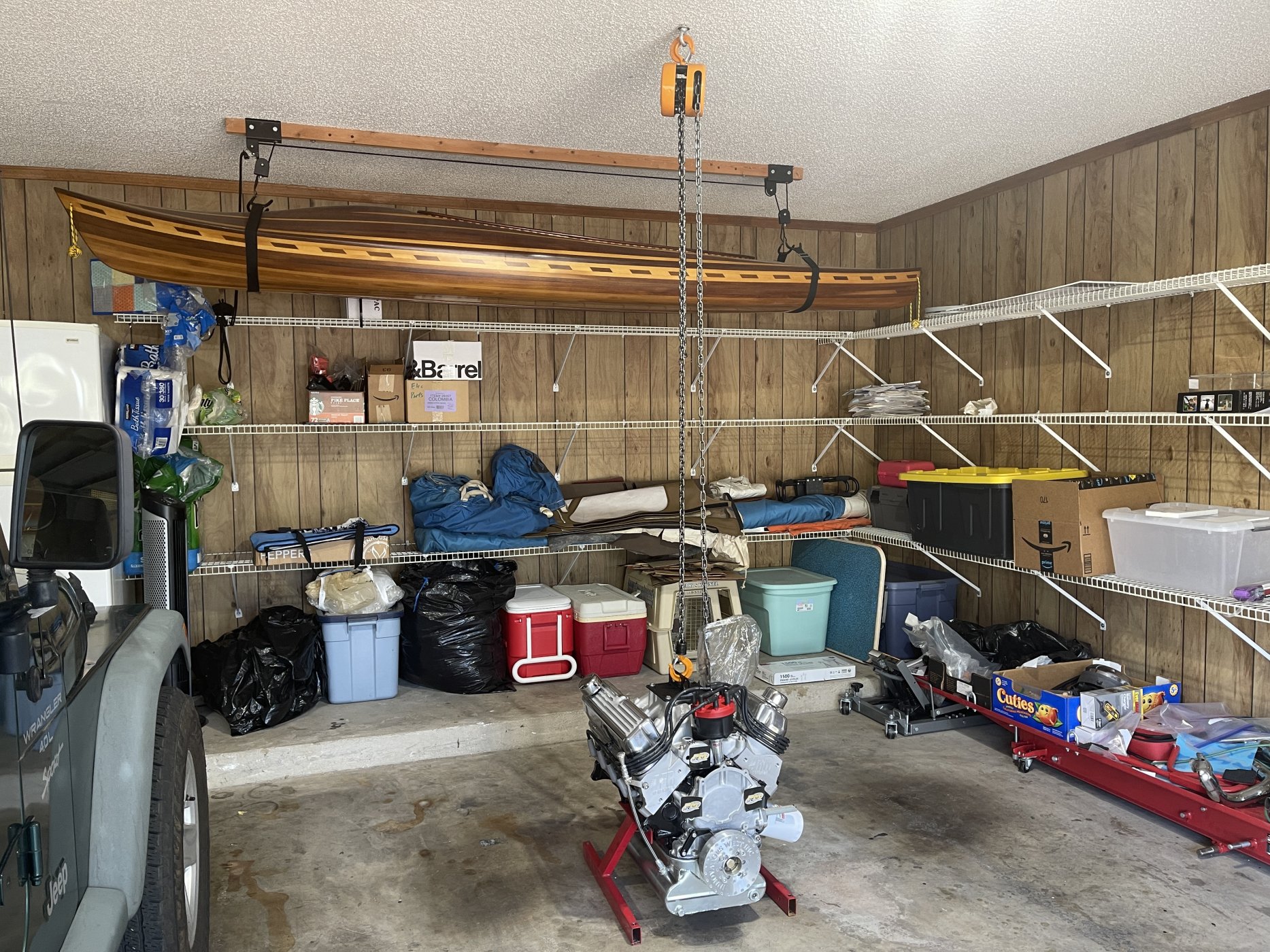

Did you build that kayak Randy? Looks gorgeous!
I did. I also built a canoe and wrote a how-to book for that:

Most “replacement“ U-Joints have a grease zerk installed and you can periodically refresh the lube in the joints. Also, the heat involved with U-Joints will soften up the lube to the point where it will redistribute between the bearings if the bearing was assembled with lube properly to begin with. Not much heat involved with the release bearing shafts on the P-Trans.
I agree with Neil as there are places and times where solid bushings make more sense.

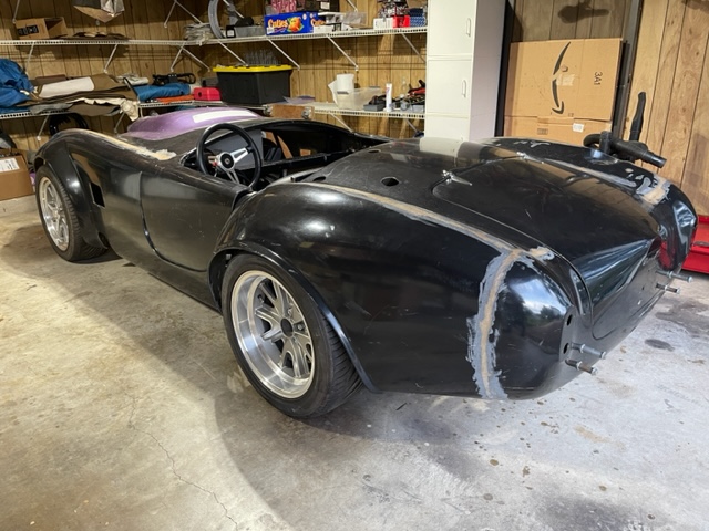

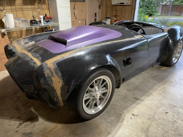

While I am waiting for my RCR40 to arrive, I decided to put my available time towards an altogether different project. Picked this up yesterday. It's a 2007 FFR Mk3 that was last worked on around 2010. Towing it home on an open trailer got rid of most of the dust :) None of the aluminum panels have been attached, which is great since I will be able to clean up the frame.
I am looking for a mild combination set of heads and cam. The ones that came with are a bit peaky. I want more low end torque and less high RPM HP. Suggestions are most welcome.

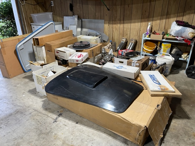

Most of the parts are still in the original boxes

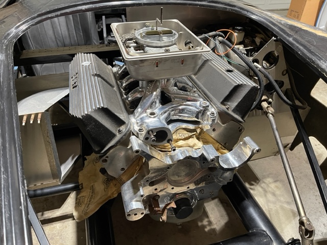

The DART SHP 351W/427 Dart is still wrapped in wax paper with heads, etc. loosely bolted on
Dart SHP 427W Short Block
