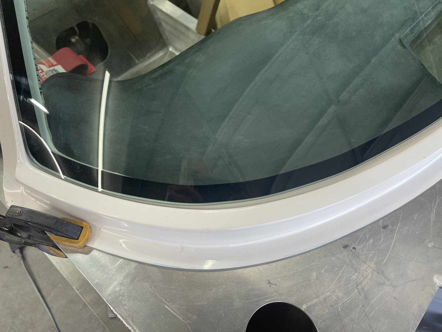

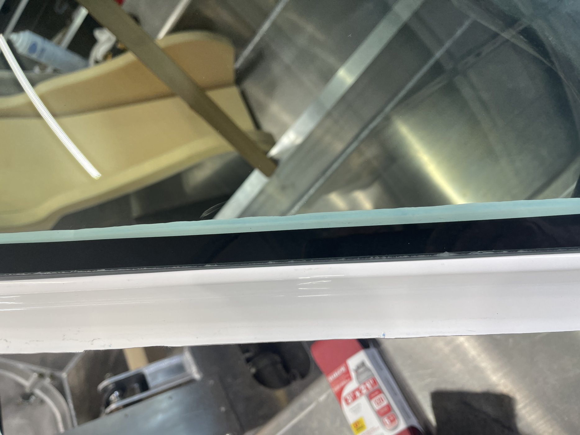

I finally finished sanding down the sides. The gaps at the top and bottom are more or less uniform at about 1/4”. The sides are about 3/32” and align nicely with the A-pillar ribs. I will repaint the frit. I had no idea what this black edge paint had a special name. I also learned that it provides both a bonding surface for the adhesive and protects the adhesive from UV. Hope I can replicate the crisp edge.
I found this one on Amazon
Everything came out very nice. I spent a lot of time making sure the edges were as smooth as a baby’s you know what. I figure any little defect could lead to a crack down the road.
After all this, I don’t recommend doing it yourself. The reason I didn’t take it too a glazier was because I didn’t know how to tell them how much to take off. I figured it out when I was almost done. See my response to Jeff B. above.
After all that fitting it was nice to see that the spider nearly touches the top center of the glass without any support. There is a gap between the PS A-pillar midway down the pillar. I can close the gap with a light squeeze so I think the adhesive will hold without issue.

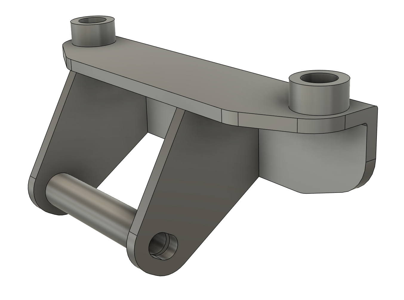

I designed and fabricated solid engine mounts that fit the Dart 302 based blocks (I assume it will fit the 351W as well). I specify Dart because I found that the Dart blocks have more webbing on the mount bosses than Ford blocks. I tried two piece Urethan mounts from two different manufactures. Neither would fit in the narrow confines of the tub when the engine was at the ideal height without some material removal. They both also needed to be notched to accommodate the webbing mentioned earlier. These issues were what drove me to make my own mounts, but it turns out there is a much better reason.
I am running a Quaife transaxle, the mounting ears are on the top of the case and are just big enough to pass a bolt through. No room for a bushing. This means the transaxle has to be solid mounted to the dog bone (the best you can do is is use a bushings to absorb some of the fore/aft movement). It's a really bad idea to solid mount the transaxle and to flex mount the the engine. It doesn't take a genius to understand why. Quaife actually had a problem with cases cracking. I am only guessing, but I bet many of those failures involved flex mounting the engine and solid mounting the transaxle.
The mounts I designed are based on the Prothane mount dimensions. The Ears are sourced from SendCutSend.com. The main support is 2" X 2" X 1/4" angle stock. The Tube Risers are 1" X 3/16" DOM. The Ear spacer is 3/4" X 1/8" DOM. The files are zipped and attached below.

The windshield had a uniform 1/4” gap both top and bottom as delivered by RCR. The A Pillars is where I had fitment issues.
