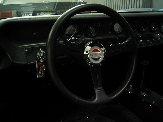

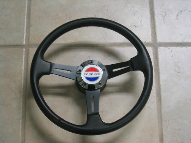

I finally found a steering wheel I was happy with .
What do you think??

VERY Nice! I assume that is leather wrapped. Source? What about the GT emblem? Nice original look! Give us the details!!
Chuck
Ron McCall
Looks like a Grant 739 but blacked out. Looks nice!
Sandy
Damn! You're good! It is a Grant 739 that I painted with Black Satin paint and added a emblem that I got from Paul Thompson. Unfortunately ,they don't offer this wheel in black or leather.It is Vinyl but looks and feels very much like leather.It only comes with polished aluminum spokes also.I was able to use the quick release that came from RCR with the car.All I had to do was get a bit "creative" with the bolts.The RCR adapter uses 1/4"-20 bolts and the wheel is set up for 10-32 bolts. The heads of the 1/4" bolts wouldn't fit through the chrome bezel so I just chucked them up in my drill press and filed the diameter of the heads down until they did.

Did the alumi hub come with the wheel, or is it the summit piece?
Thanks....
Sandy
Gulf GT40
I just yanked one off the Cobra and the P/N was fresh in my head when it went back in the box. It's too bad you can't order some of the Grant wheels in leather. The wheel was a bit too large for the Cobra, but it may find home (with some satin black paint) in the RCR.
I did get an adapter from Grant that may also work as a plug in to the RCR shaft, but I have not thought about trying it.

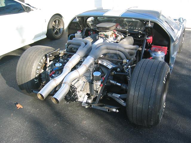

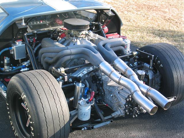

I made up some "track pipes" so I can piss off the neighbors even more than usual! ;)
It sounds bad as hell!!!
