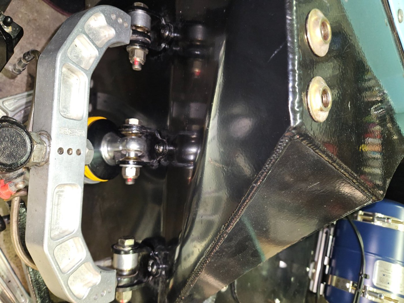

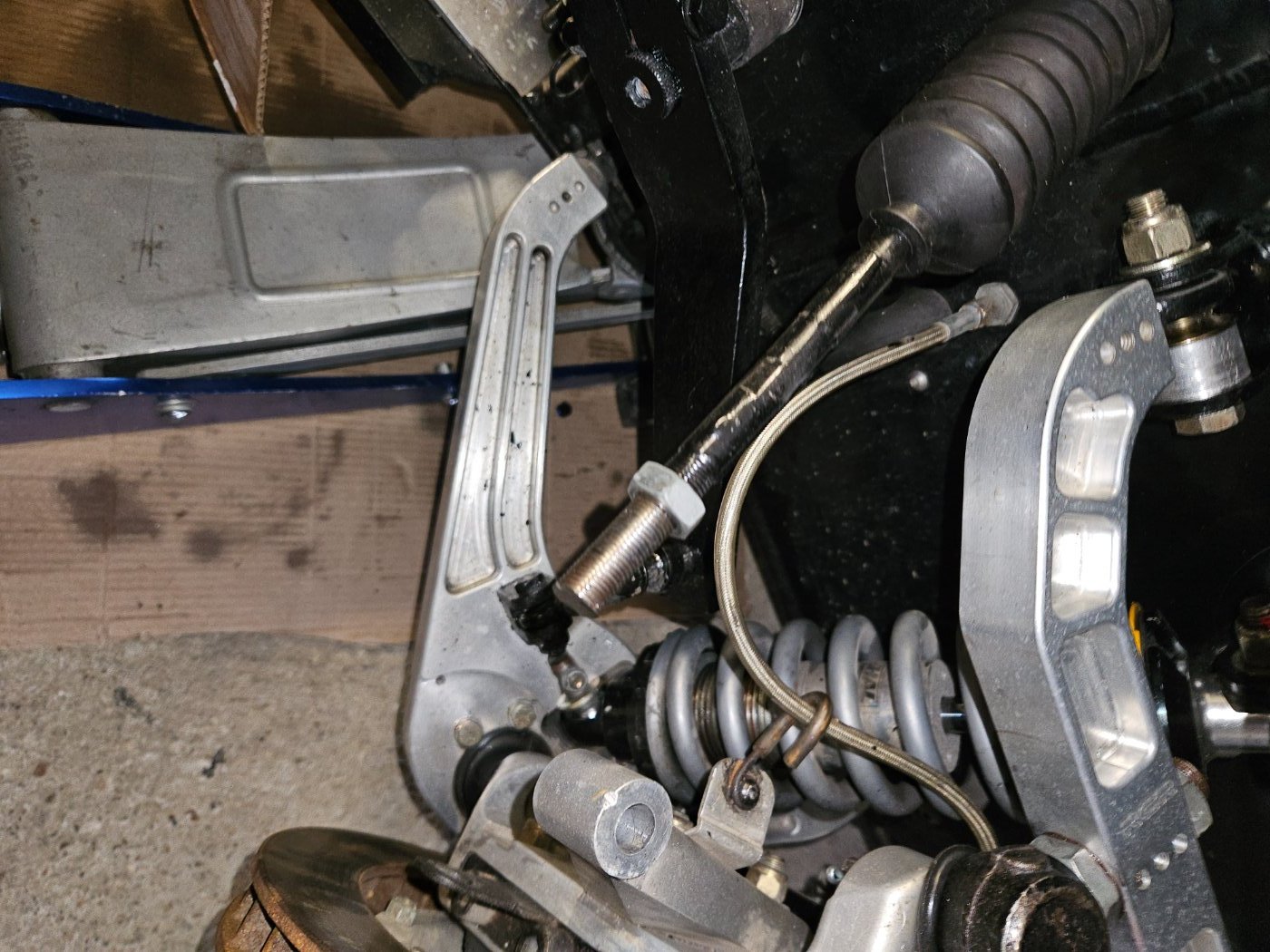

On the 2 photos, the first one is with the wheel strait and the second with the wheel turned half the way.
I did a quick adjustment and move forward the upper triangle to the maximum. I will replace all the washers by a cylinder that I will turn. I also adjust the heigth, it seems much better and almost acceptable. I will see on the track.
If it is not sufficient, I will machine new support for the two attachments of the upper arm to give extra capactity to move may be 5mm more.
Dont forget to check the bump steer as this will have changed the height of the steering arm on the hub in relation to the steering rack.
Jerry

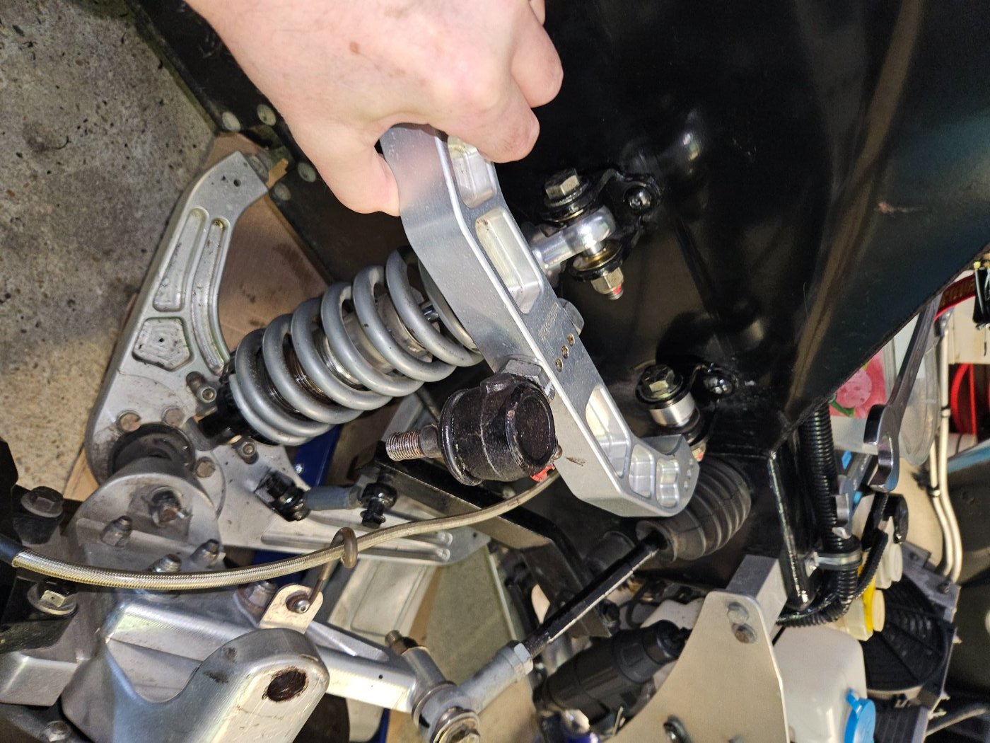

Finally I adjusted the front and back suspensions, my parameters are the following (for race track only) :
Back per wheel
- Toe in 0.25°
- Camber -1°
- Caster 6.3°
- Height 114mm
Front per wheel
- Toe in 0.14°
- Camber -1.9°
- Caster ?
- Heigth 107mm
On the front I machined aluminum bushings to replace the stack of washers, because I moved completely forward the top arm
I had also to cut 1/4" of the steering end screw because the Toe adjustment was not possible.
With all those adjustments, the front tire is still passing very close of the back fiber glass archee, I will may be have to cut the portion in front of the tire.
Does one of you has the same experience, what minimum distance do you experience on your RCR car ?

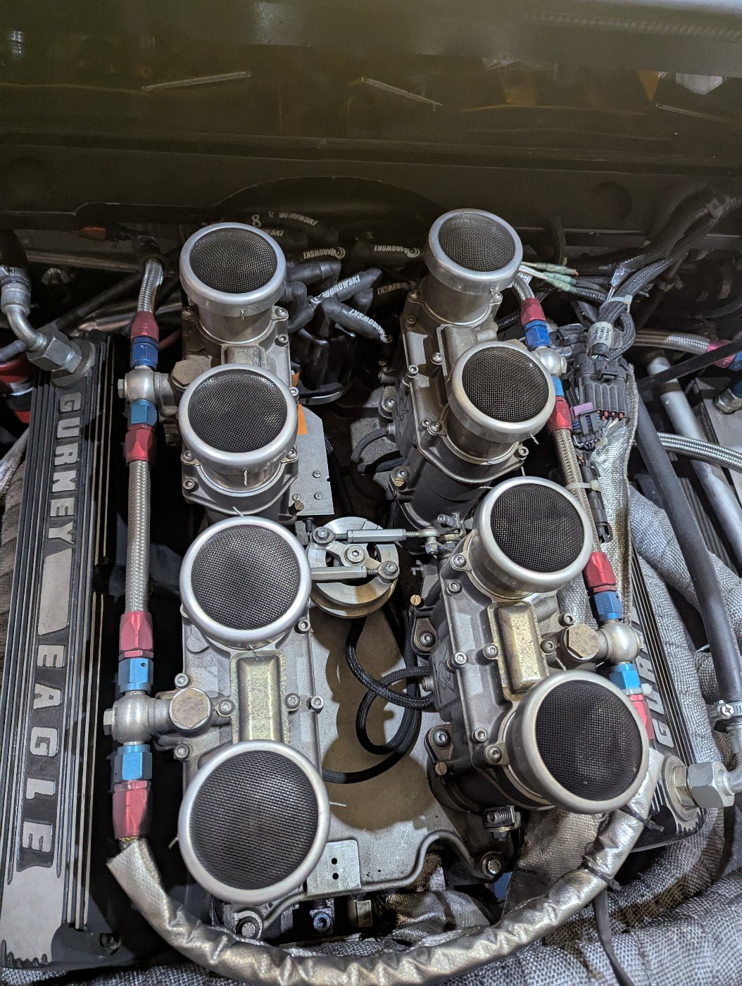

I am a littel desapointed by the first steps on the dyno. The first number are between 400 and 450hp. The engine is very reactive, balance of the 8 cylinder was done, but after checking the material the engineer found out that the rating of the injectors are too small. They are rated for 32lbs/h. To remind you I bought the car as is, and it confirm that the car was assemble for a street use. For a 6 liters engine to get a larger amount of power, the engineer suggest me to put 40lbs/h injector, what the docummentatation of Accel is confirming. It will be probably necessary also to change the gas pump in parallel.
For information with such Borla 8 stacks for the ones of you that are equiped with, what size of injectors and pump are you using ?
