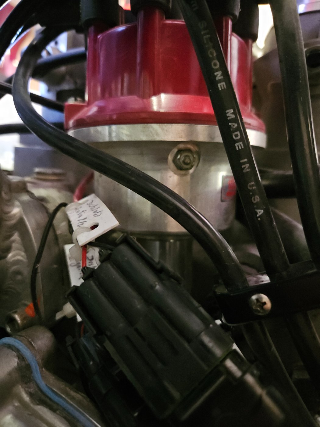

Hello Bart, unfortunately, I cannot read any designation on it. It is full of cable or pipes around it,and I do not see any tag. I can only tells you that it is piloted by the Accle DFI system and see the photo, if it may help you
Hi Jean-Marc,
I am looking for the smallest distributor for my 289.
That is why I asked, but whiteout a number I am clueless.
Thank you for taking the picture

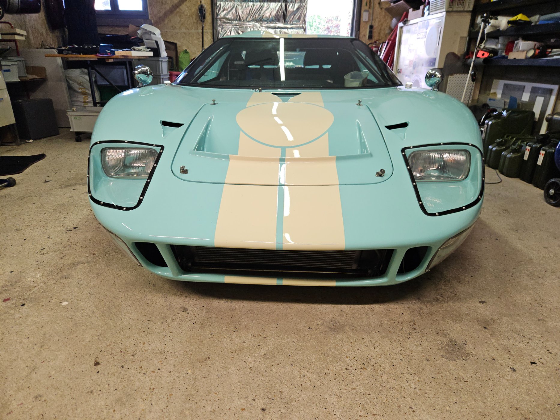

I come back to keep you updated ; I ama seeing the end of the tunnel. I finsihed to put in place the windows and front light glasses. I was unable to renew the surfaces of the ones that I received with the car. They had scratches and even after repolishing with very fine grain and using various type of product the result was never acceptable. Finally I order part from Tornado, The thickness is much less than the ones coming from RCR and they seems to be very sensitive to scratches.

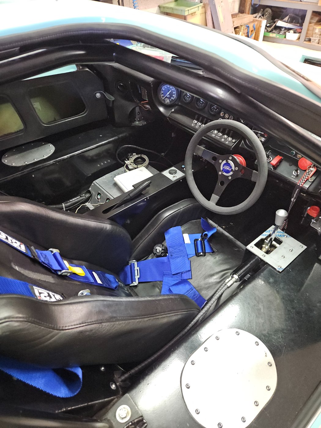

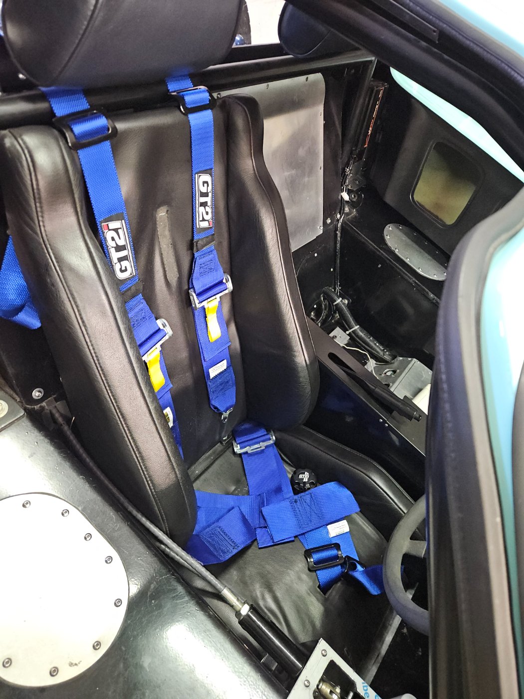

I modified also the seat to allow an easy deassembling of the back and give a quick access to the engine bay, and to be compatible with a 6 point harness.

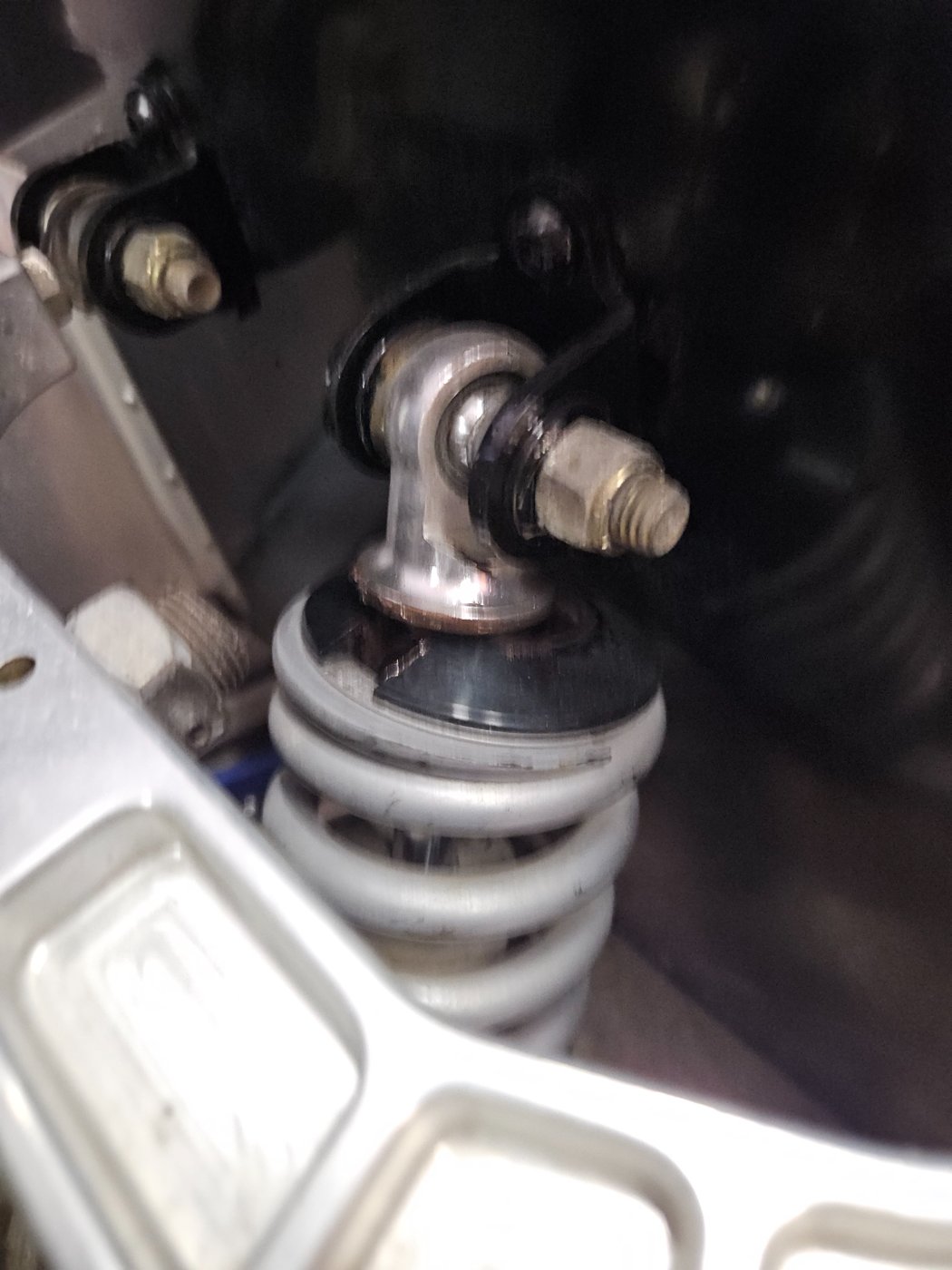

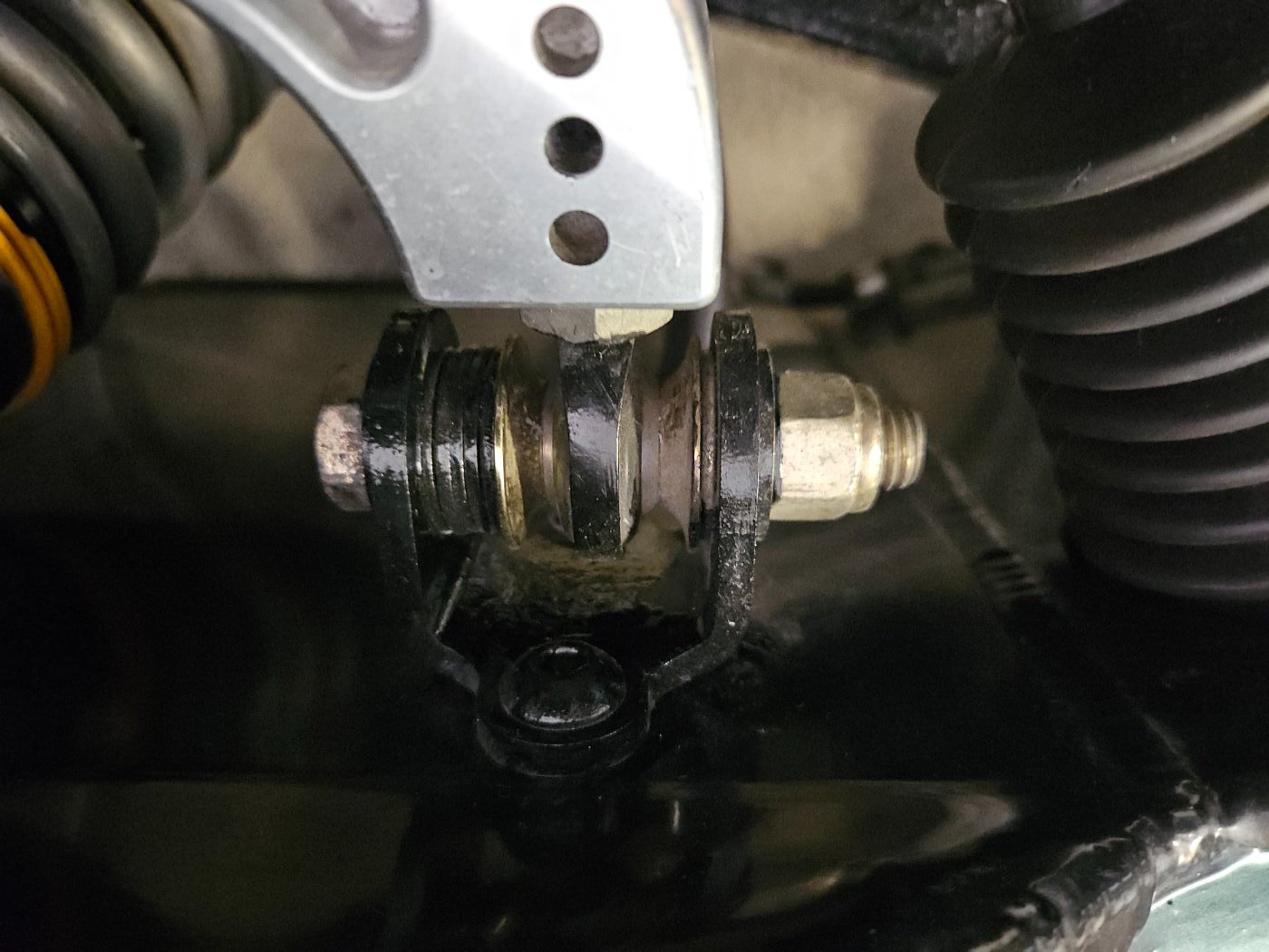

My last problem a t this time is the height adjustment. To I tried to adjust the front to 110mm, 4.3" but when I am doing this the spring is not fully compress if I lift the front on a jack and I wunder what would happen on a track if the suspension is completely decompressed like it is on a jack.
The ressort is not compressed anymore if I reach a height of 160mm 6.3". Is there a problem some where, should I put a spacer, or change the spring length? Any idea ?

Jerry, thank you so a spacer is required.

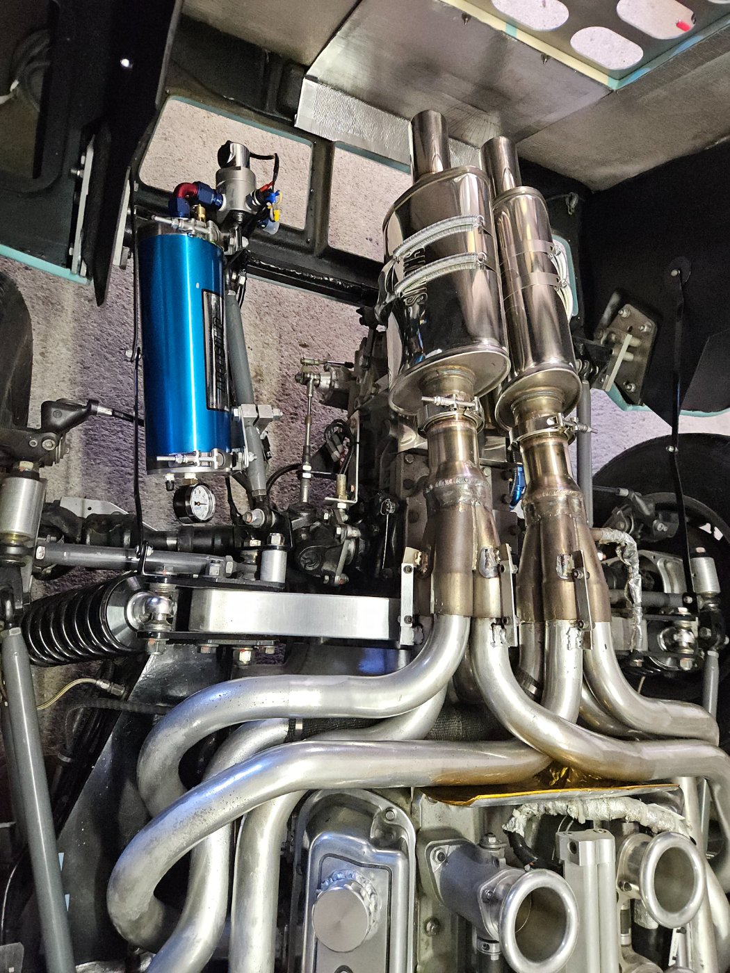

Now I am working on the oil circuit, I am waiting some parts to equiped the engine with a oil radiator and an Accusump. The Accusump and its valve are in place.
For your coil overs. Drill holes in the hats and secure the hats to the springs with zip ties. This guidance comes from the Factory Five Racing Roadster (Cobra) build manual. On the FFR forums some builders recommend using Stainless Steel zip ties.
Thank you Randy, it is a good idea, but a friend, engineer on Michelin tires for Le Mans racing car told me that they use "helper spring" on racing car especially to keep the spring in place when you lift the car on a jack. It also what Jerry suggest. The spring have almost no impact on the stifeness of the main spring and is very small when it compress. On top of it is rellatively cheap.
Helper springs are in place. It was necessary to cut the centering ring that goes between the regular spring and the helper spring to allow the complete compression of the helper spring in compress position.
Now I am finishing the oil circuit, Accusump + radiator but some fittings were missing and I should finish it next week. I order my fitting to Torques UK, for me an excellent vendor.

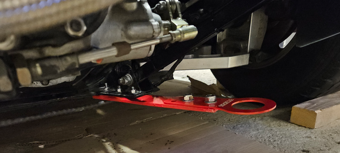

In the meantime, assembly of the rear tow ring; I had to attach it to the main chassis because the rear subframe is only there to support the rear hood and didn’t seem rigid enough to be a good towing point.

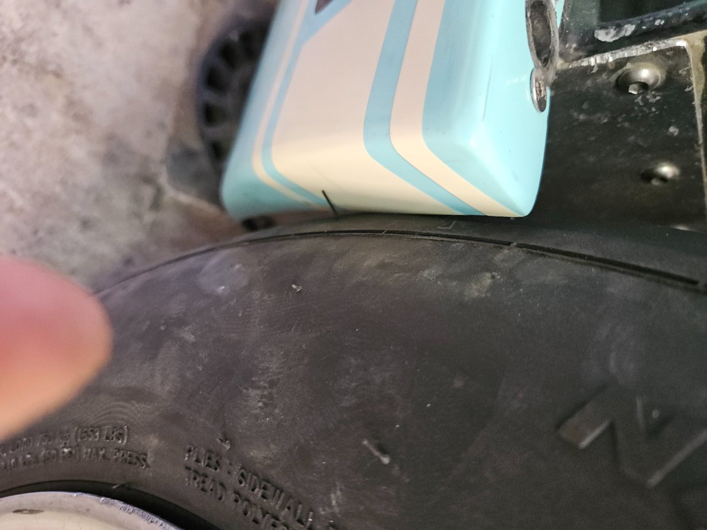

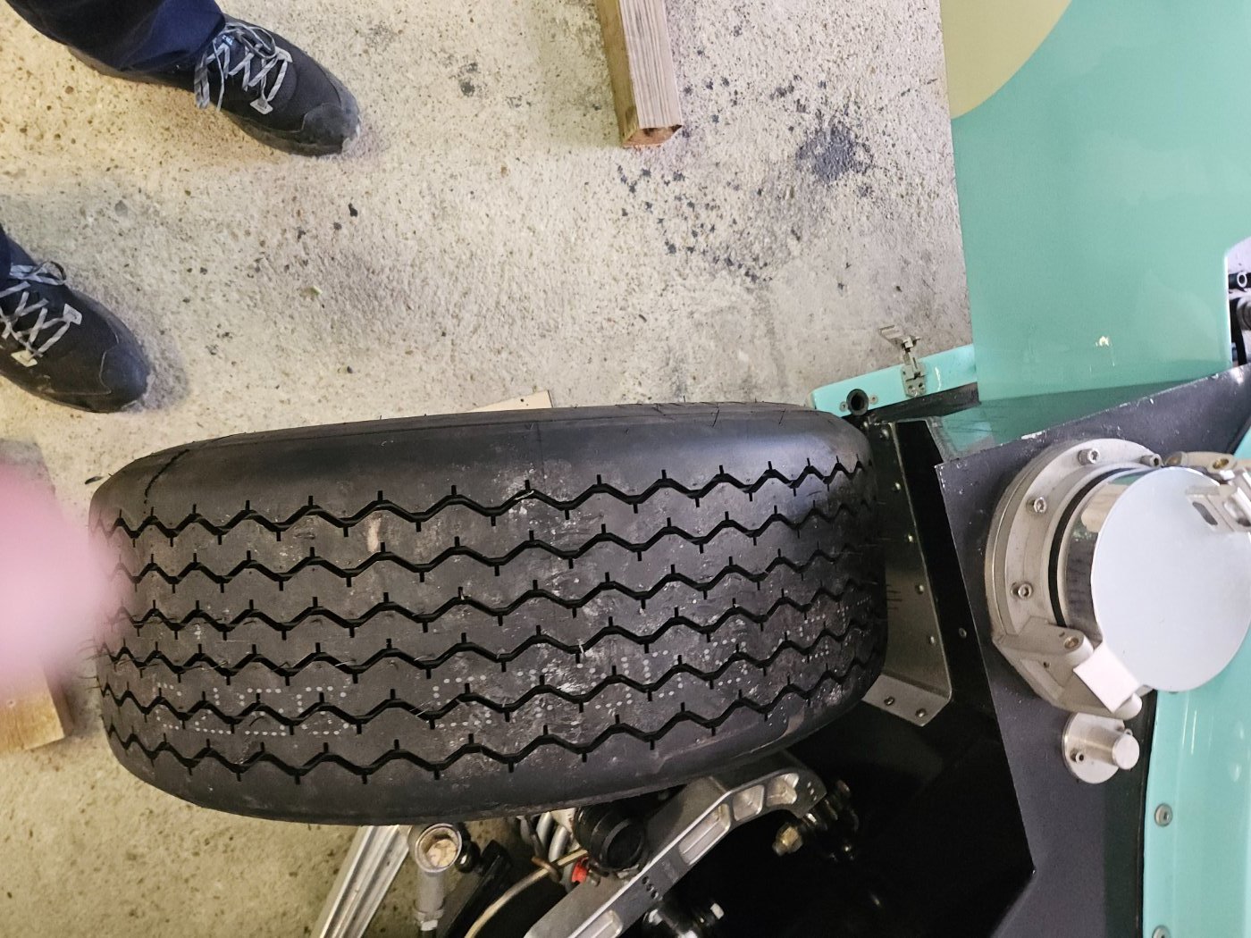

I just mount my new tires. The Avon historic CR6ZZ delivered with the car were 12 years old and completely dry, even if they never saw a race track.
After a lot of considerations I bought Nankang historic CRV6 from Nakang Nederland in exactly the same dimensions than the Avon. My total cost was 2000€, 400€ less than the Avon for 215/60x15 front and 295/50x15 back, that guide my decision.
For the back no problem but for the front they are a little bit higher in diameter, about 1/4".
The result is when I turn the front wheel they are coming very close to the lower side of the body. Anyway I have to reajust precisely the height. But I will may be try to move the upper triangle forward. I do not have a lot of adjustment only one washer left. If it remain to close, I will have to cut in the glassfiber of the bottom sides.
What do you think ?

If you have problems in the straight position of the wheels (photos) how do you envision turning them under steering? A while ago I test-fitted 225/60 Avons which I use on another car - I had the same problem as you and went back to my 215/60R15. I think the only choice is to move the front suspension forward as much as necessary. On my RCR the front wheel sits slightly to the rear of the wheel arch so this would be feasible.
