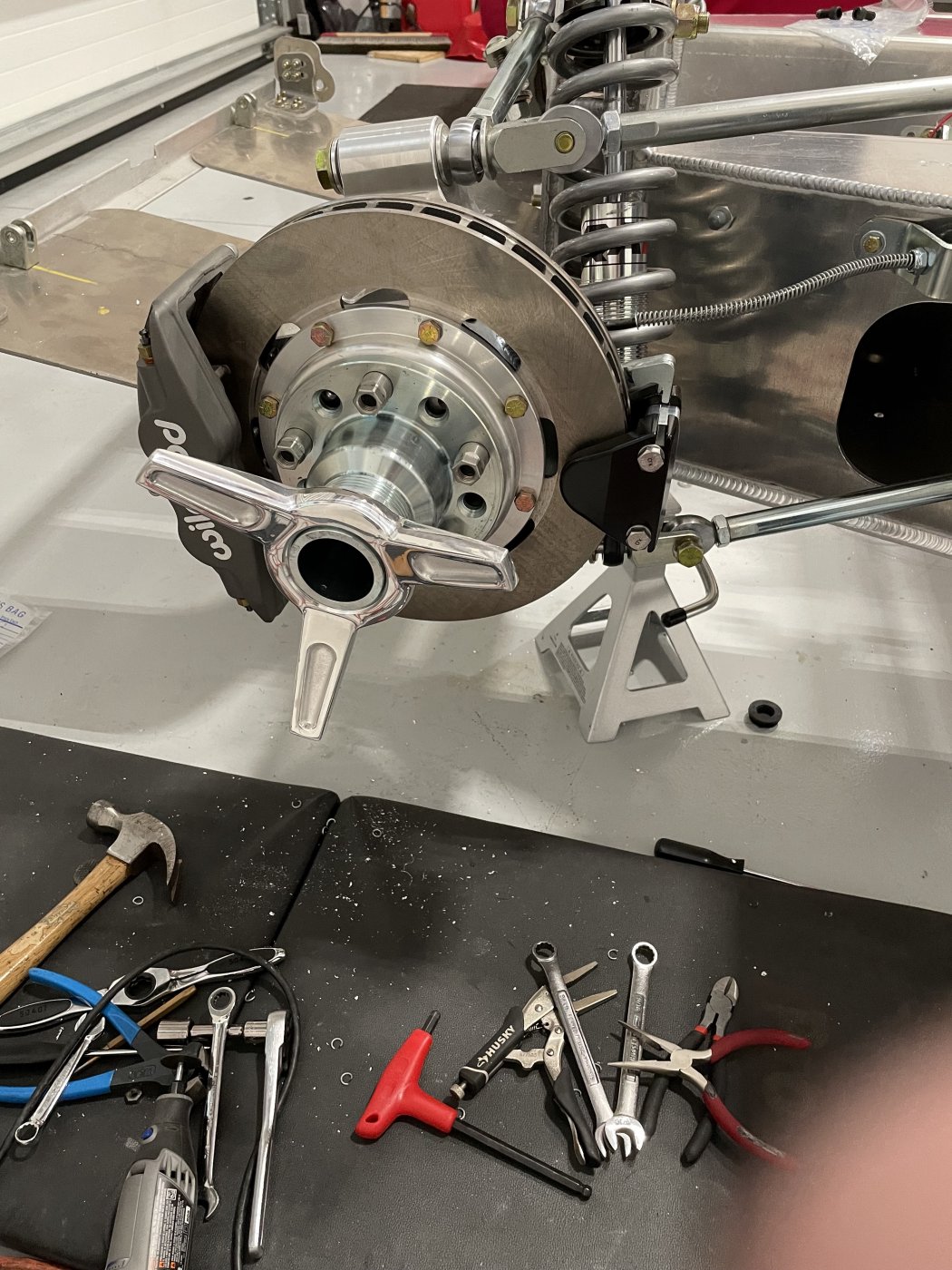

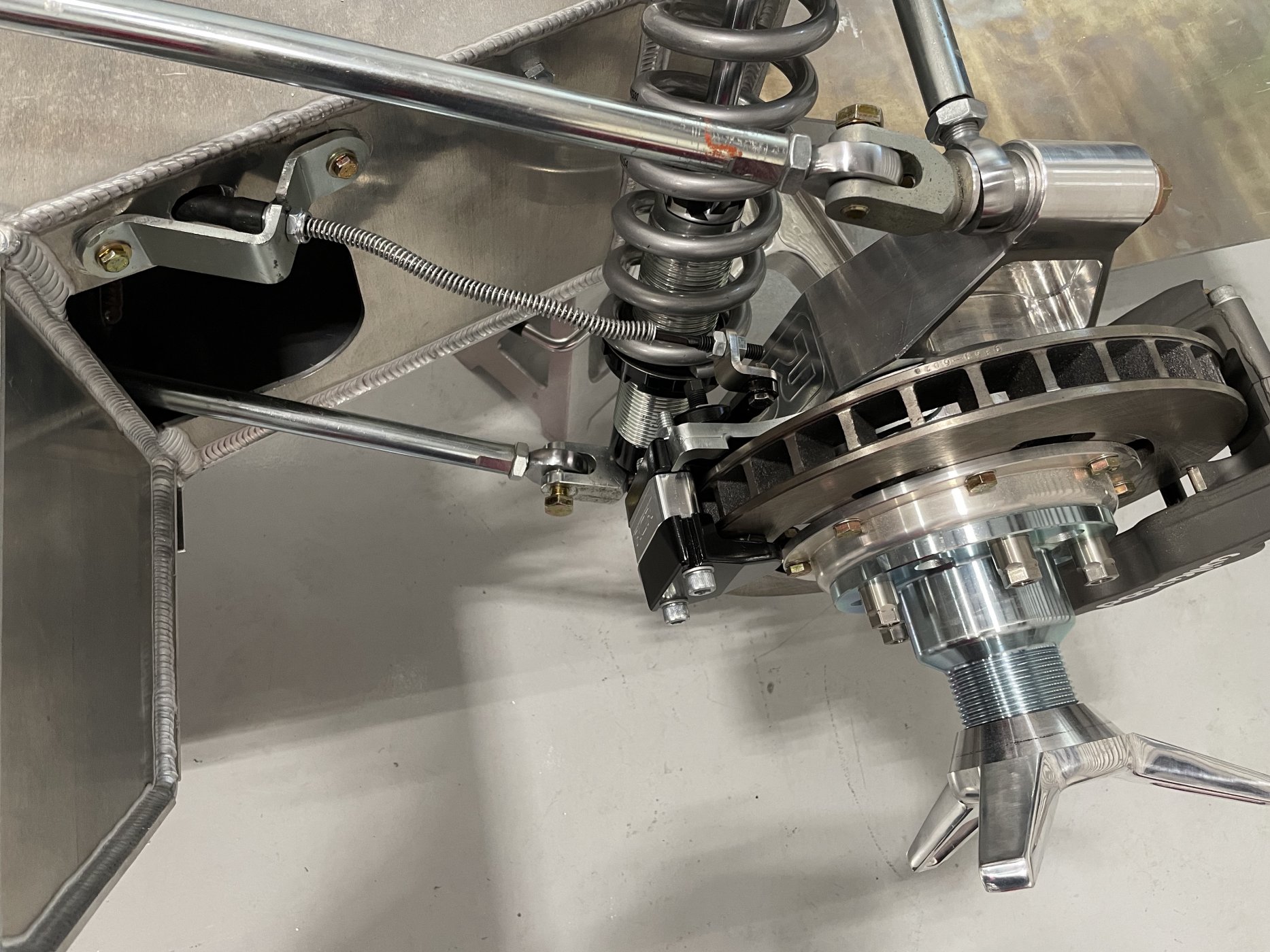

Just following up. I've now installed the RCR supplied handbrake system. I've been able to adjust it to the point where it appears to completely lock the rear rotors from moving so long as I've pulled the handle to the very top rung. Anything less and they will move (with some force). There is still some small adjustment left in both sides of the cables. Since I've not yet put the wheels back on and put the car on the floor I'm not able to test if they do fully lock it sufficient to prevent the car from rolling. Once I reach that point I can do a final adjustment.
There is still one area of concern. The caliper has to be adjusted to give the maximum amount of tension on the rotor when the handbrake is engaged. That adjustment is a balancing act between moving the pads sufficiently away from the rotor when not engaged and being able to get the needed amount of movement sufficient to "lock" the rotors from moving when engaged. In my experience that adjustment results in the brake pads still having some contact with the rotor when the handbrake is released. I'm not sure if this amount of contact will result in any drag when driving and I'm nowhere near the point where I could test that.
The "floating" nature of this design means that the caliper itself moves so setting a precise "gap" between the brake pads and the rotor is not really possible since that gap changes slightly each time the caliper is engaged by the cable then released. Considering this lack of precision it is not surprising that when not engaged my left rear caliper has less contact between the pad and the rotor than the right. Once I get further along and get the car on the ground I might experiment with inserting some small spacers into the right rear caliper to adjust the width and put some additional space between the two caliper halves. I think that the spacing on the left rear should be fine as is.
For now I am satisfied with the install. The final verdict will have to wait until the car gets on the ground. I will also test for any clearance issues with the wheels as had been noted by others on this forum.
