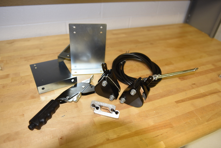

Attached is an image of the RCR40 handbrake system that comes with the kit. As you can see the calipers are much different than the ones sold by IPSCO. I'm hearing that one of the issues with making this system work has to do with the difficulty of adjusting it so that the pads stay far enough off of the rotor (so they don't stay in contact with it when not engaged) but making sure this adjustment doesn't result in the pads being too far away from the rotor to hold solidly when engaged. It's a very simple caliper design (maybe too simple?) where a lever when pulled moves the brake pad on one side closer toward the rotor. It's also designed to float on the bracket to return to unengaged status when the handbrake cable is released. In theory this should work fine - but it seems that in practice there are issues (maybe because the tolerances in this design are so wide?).
I also looked into installing an "in line" parking brake as an easy solution since it would use the existing rear calipers and the RCR40 brake plumbing already has the rears on a separate circuit. Still researching if this would satisfy my state's requirement that a parking brake be engaged separately from the brake system.
It may be that the RCR supplied handbrake is the best system for me to install - just trying to make sure of that before moving forward with it...
Chet

Chet, they look like Wilwood spot calipers.
Here is a link I found..
Chet Zerlin
Joel you are spot on (pun intended!). As I get more info I will give Wilwood a call. Perhaps they offer a different "spot" caliper that would work better and still be able to utilize the RCR supplied bracket and cables....
