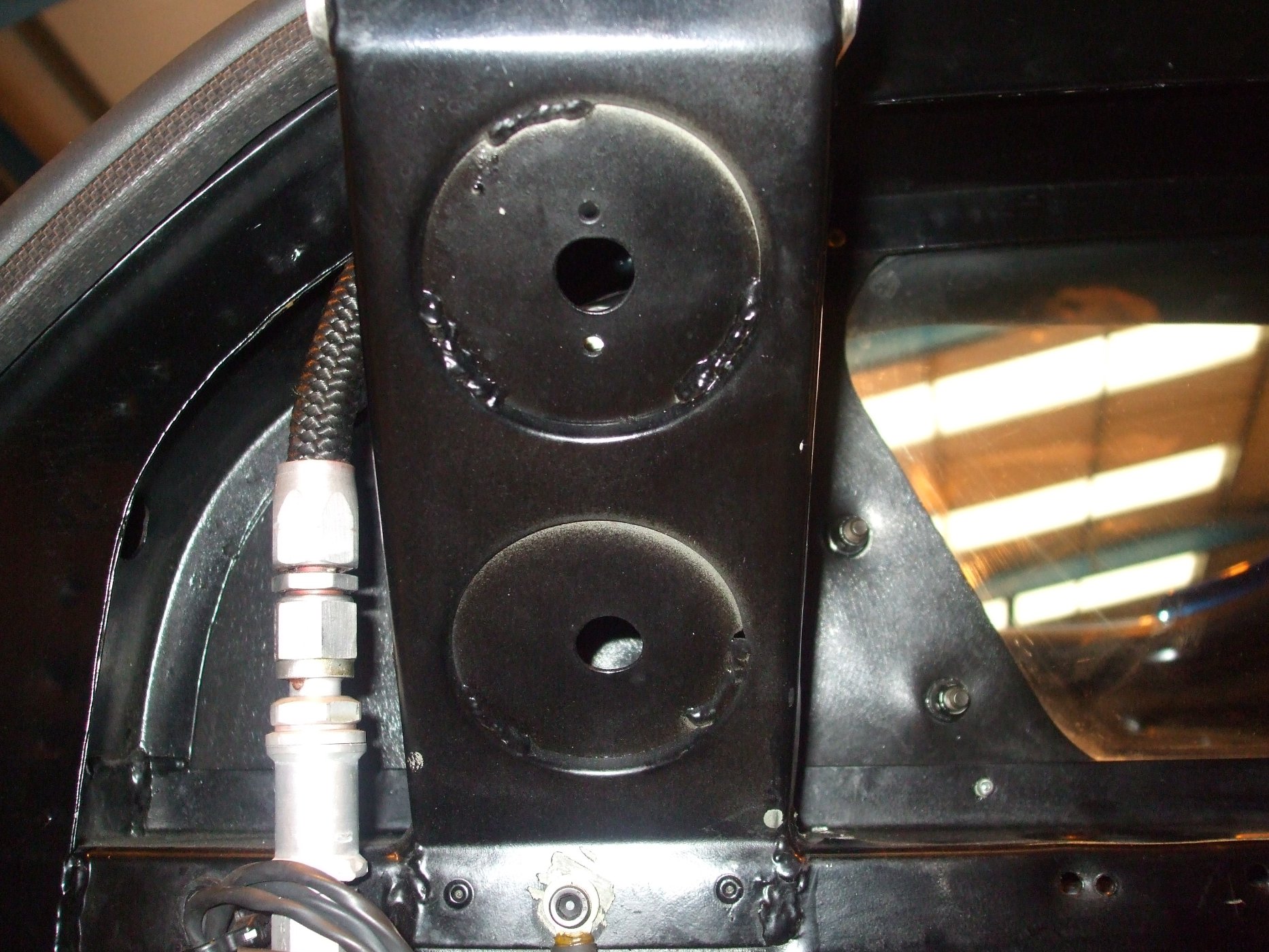

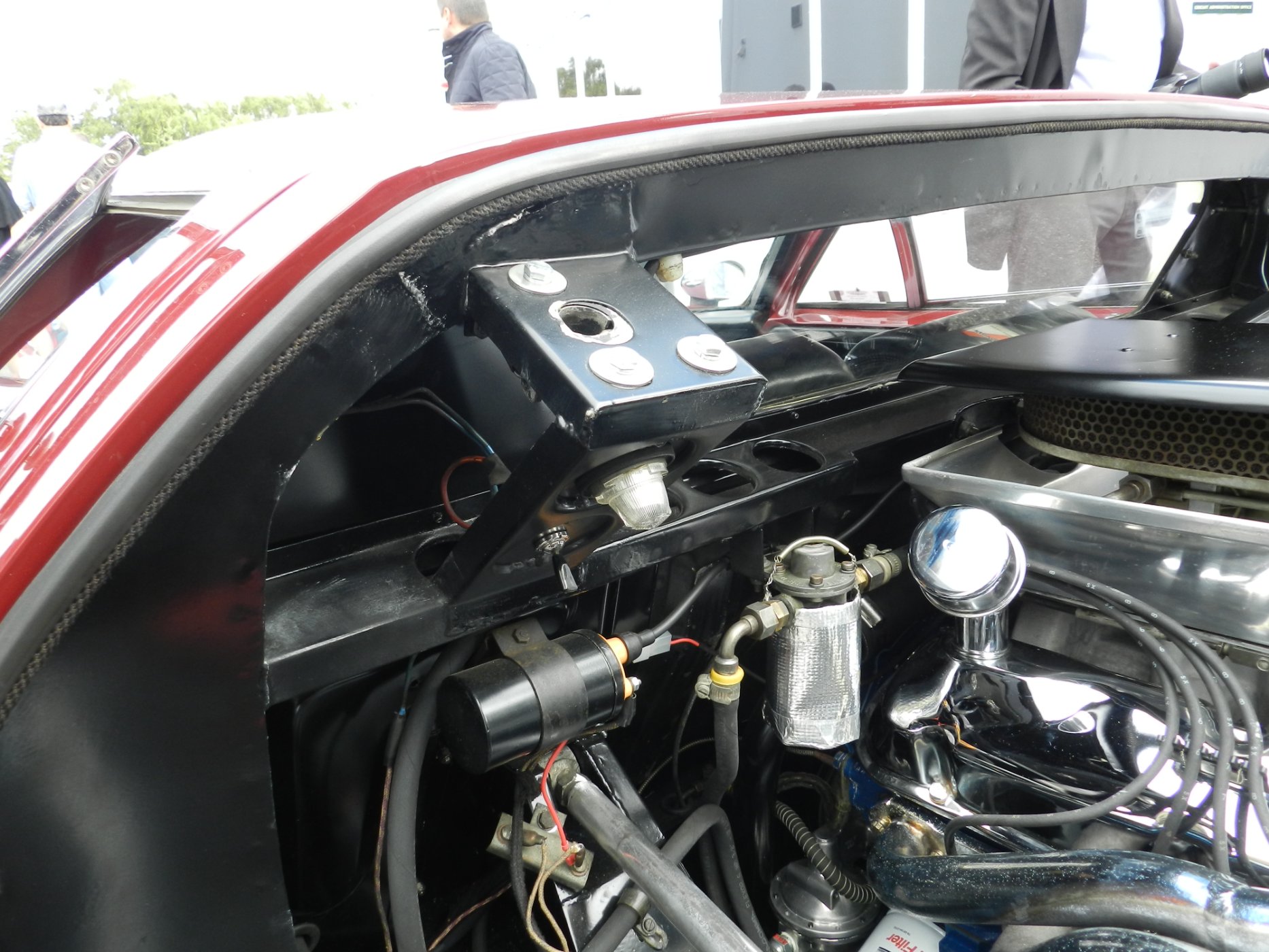

Here is a detailed pic of the left side shut of P1053 showing the top holes for the TR4 light and the switch in the dimple below. The piece of metal is rectangular that fits inside and covers both circles and is tacked in where you see.

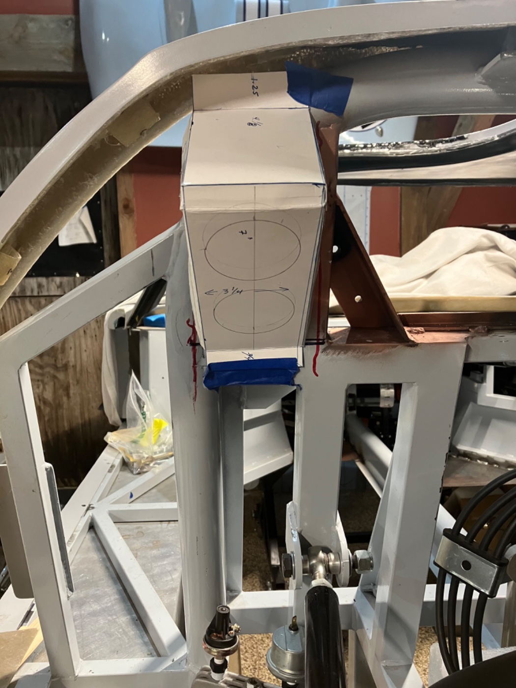

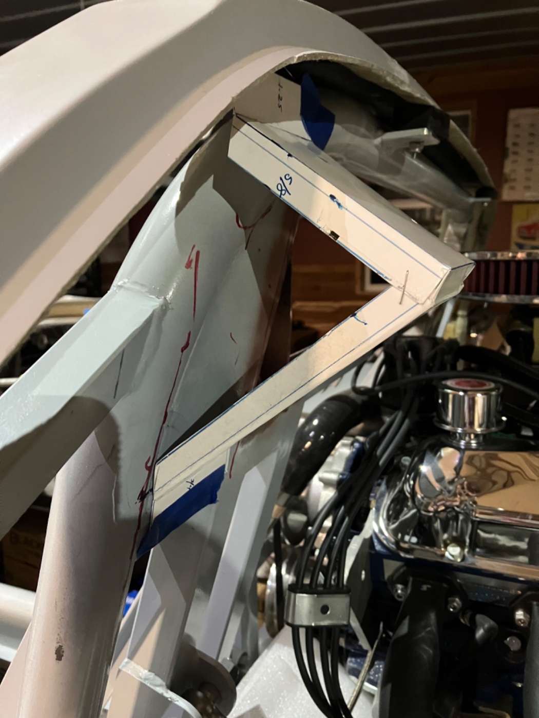

Davidmgbv8
Got some dims over the phone and taped some fag packs together and I am pretty close. Holes are 2 1/4” dia approx. distance is guesstimate
The TR4 light, is that original to 1053?

Looks like a nylon plastic guide just below the return on the top of the rear firewall?
I have been wondering about how the release rod is held in place in the roof cavity and what stops in rattling around.
