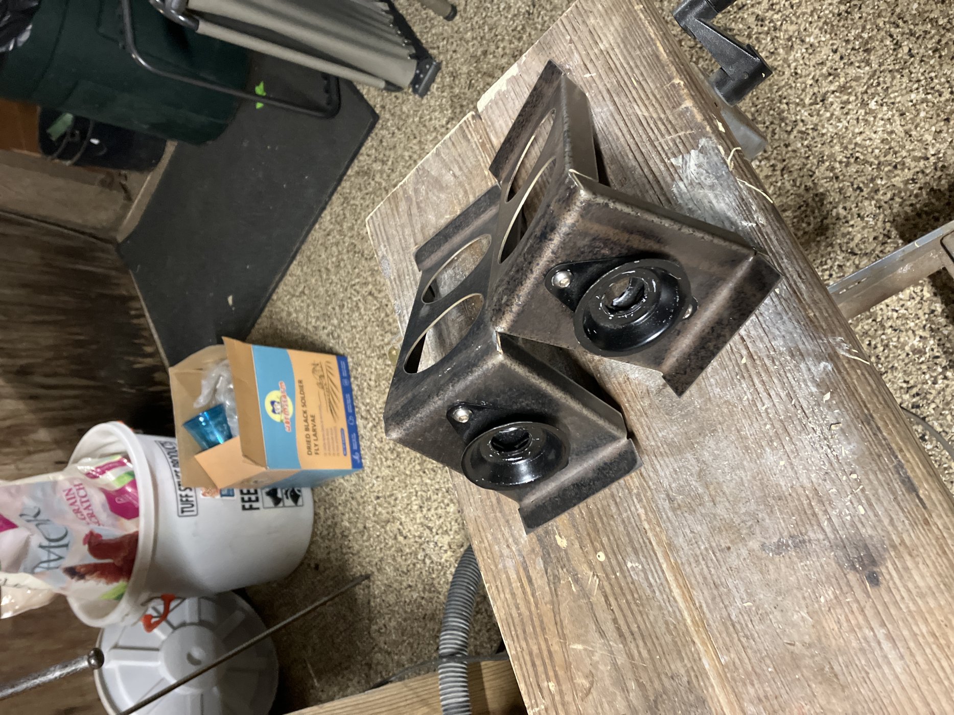

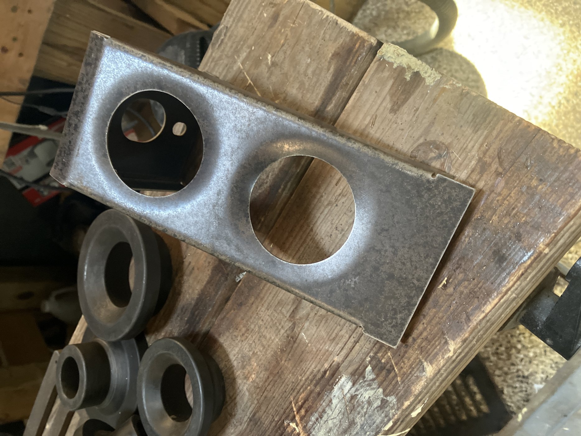

Just picked up goodies from water jet and my catch fits well, will sand and bend tonight

Davidmgbv8
I folded my long edges before I used the dimple dies and then they would not fit! In reality holes should be 1/8th in smaller to get the dimple. Not sure if I will redo.
Not sure where the catches originated, I bought them from SGT with my chassis

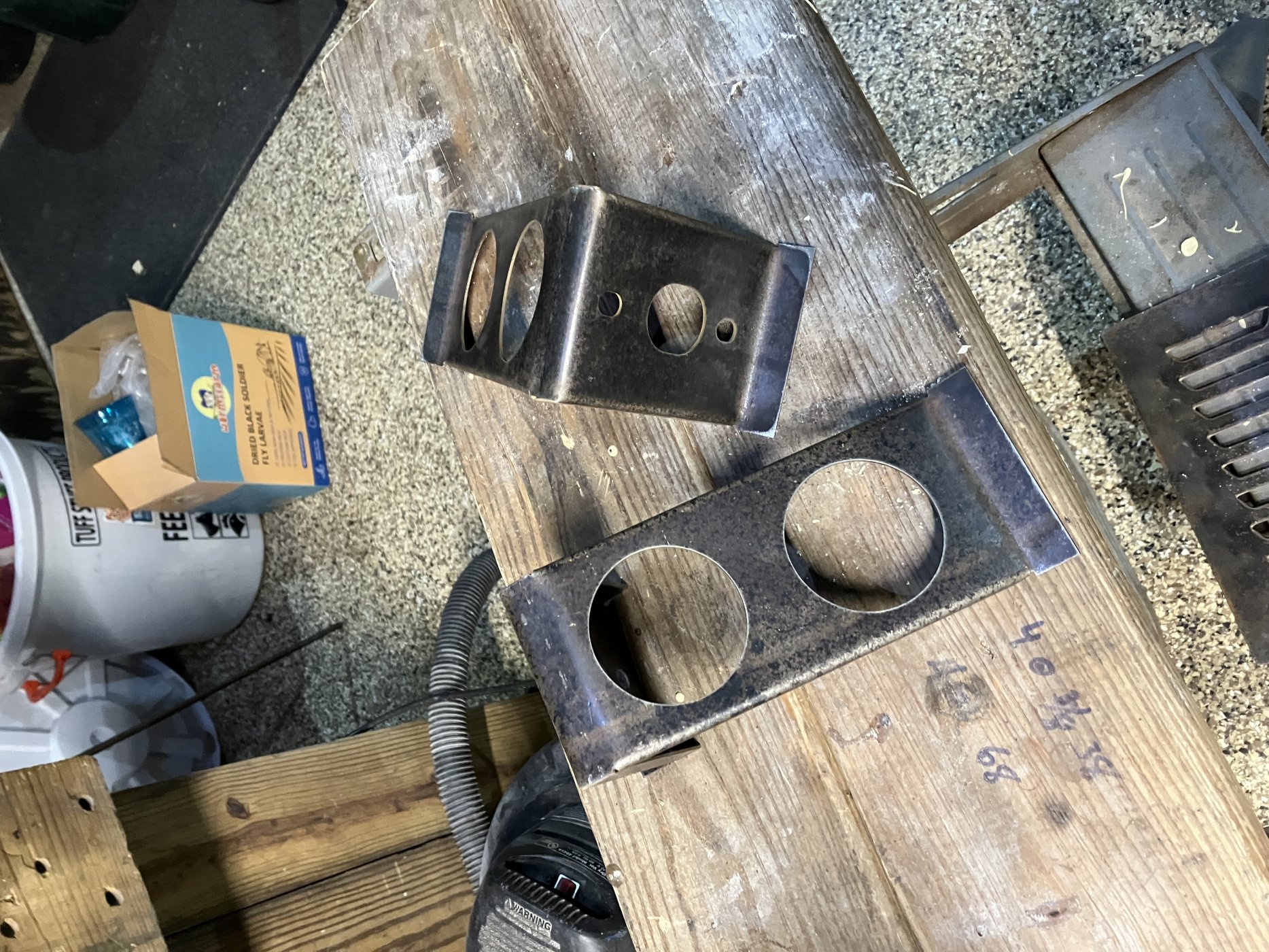

Davidmgbv8
2nd try, had the hole cut to 2 1/8” dia and used my 2” dimple die. Original had a much tighter dimple.

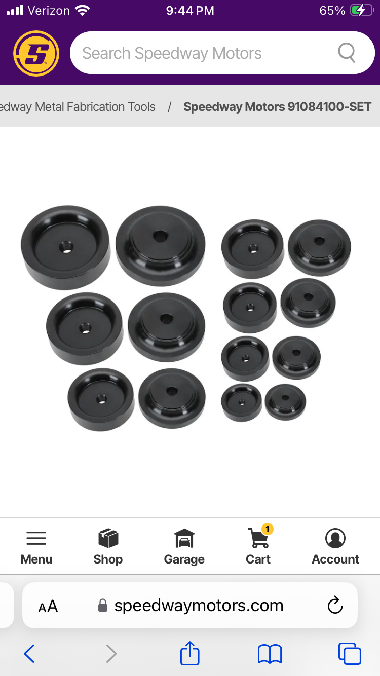

Davidmgbv8
Looks like these are the dies needed seen as a Flat dimple did in some listings. For me not going to redo again, going to use my first brackets with no dimple

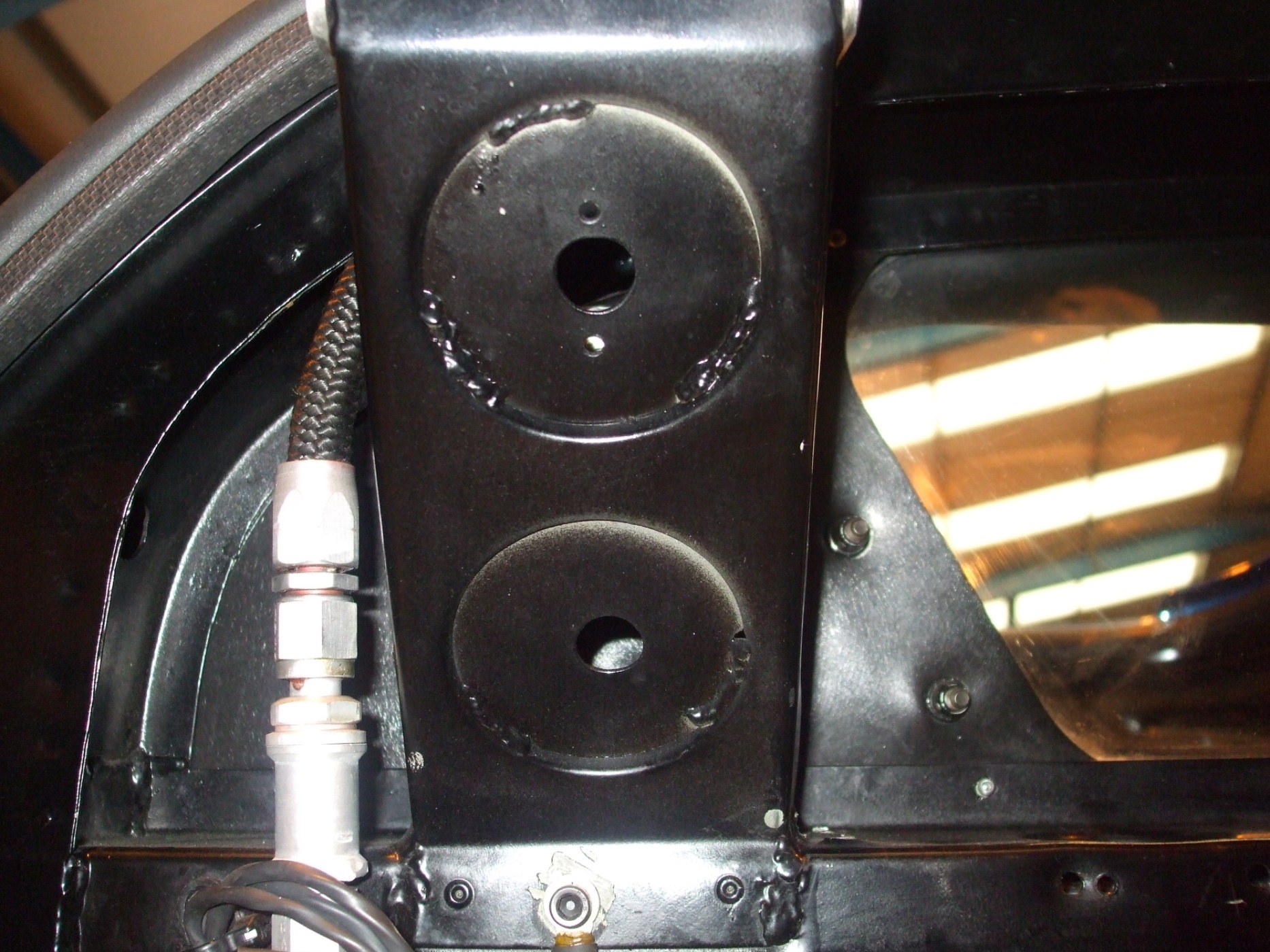

Ole Nylende
For info (and as you already noticed david) the two holes are not intended for dimple dies.
They are supposed to be fully flanged with an internal radii equal to the plate thickness.
In this case the tool could be a pipe with an id of 2,5" + 2x plate thickness, a small radius on top typ same as plate thickness
and then some suitable die.
All holes are flanged like this on a monocoque chassis, i have to make some proper tools in a number of different dimensions.
