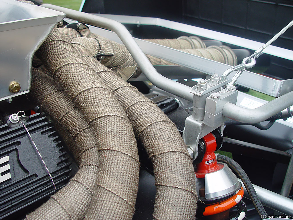

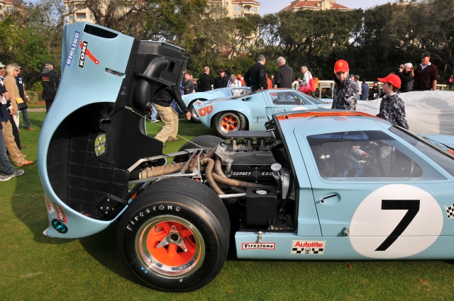

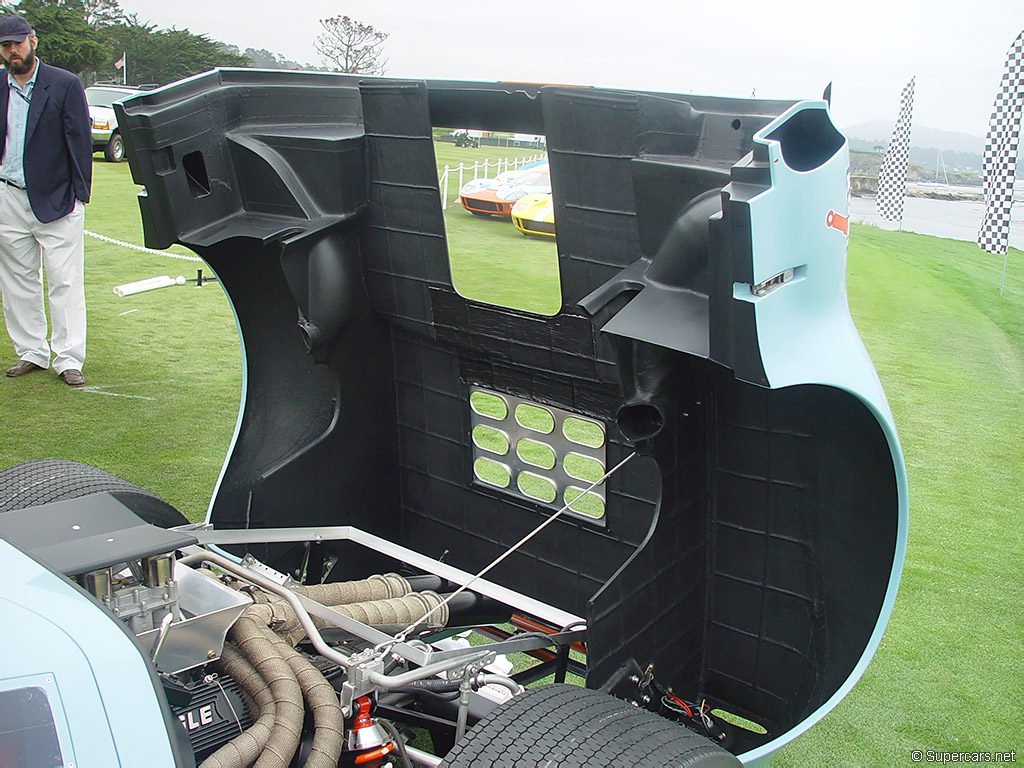

Here, on 1074.:thumbsup:

Pierre-Louis,
Thank you. Your photos are helpful. Do yiou happen to have a photo from the other side showing the bracket that is bolted to the clamshell?
Pierre-Louis,
Actually, that shot is helpful. i can see the placement, and that the bracket appears to be a strip of aluminum(?) held on with two bolts. I'll try to magnify it a little later.
Ron
It seems to me that the rear bracket is almost the same than the front one (strip of alu, 2 bolts as you noticed), maybe just lightly bent at one end, where a loop in the cable engages, to clear the fiberglass...
