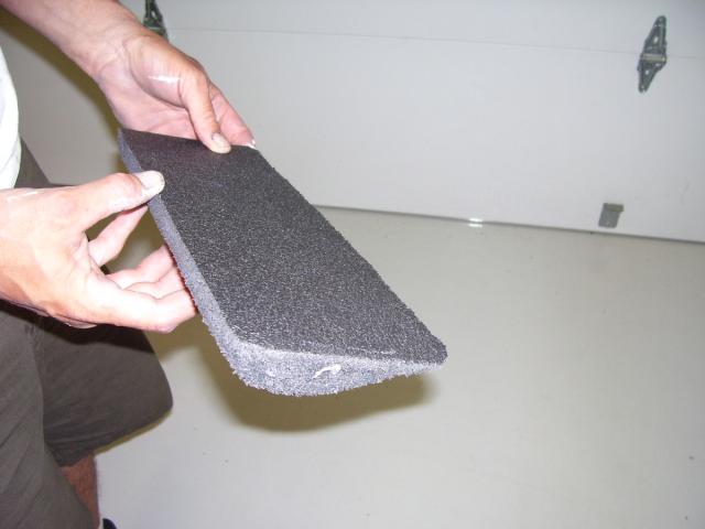

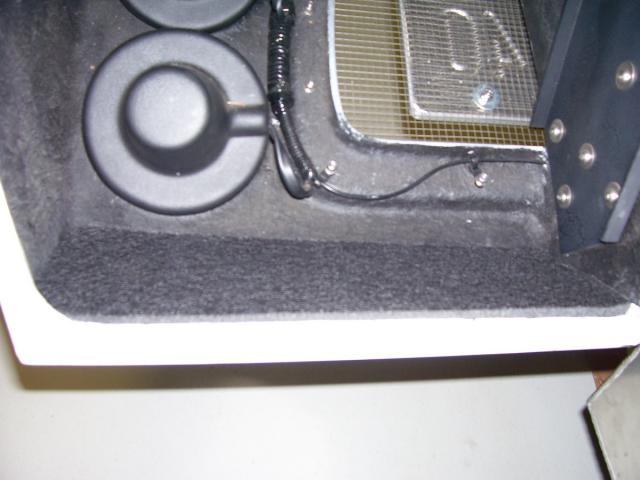

Jack,
Used closed cell foam rubber; cut and sanded to fit and adhered with marine caulk/adhesive.
Pics below:

Chuck,
Came as packing material with a bunch of parts Olthoff shipped me recently (think it was part of the ZF shipping box) but, anything like pictured will do.

Jack, Lynn Miner did an article in the “How TO” section that covers some of this issue. He used spray on bed liner on the inner fender wells in both the front and back. Seems to work very well.
Jack Houpe
My son has a bed liner business, if I had a way to get the car up in the air I would have him do the belly pan too. His is the cold process which is like hard rubber, he does fuel tanks, fenders, floor pans for rock crawlers, basically anything now that no one is buying new trucks. I plan on filling in that cup area just behind the rear tires and then spraying them, I like the foam idea and then spray.
