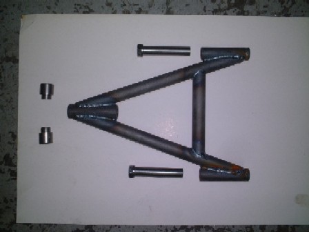

I am in the prosess of making several sets of rear lower arms for the RF.
These have a 5/8 inner rose joint to allow for caster adjustment on the rear upright without twisting the bush out of the arm (To reduce rear bump steer)
The arms are in mild steel same material as original arms.
It also has tube nuts to attach the outer joints(4140).
This allows toe in and out adjustment without dismantling the suspension.
2 5/8 to 1/2" adaptors to utalize the original bracket.
I have 2 arms left if anyone is interested they are $300 Australian each plus gst if in Australia.
To pull more caster you may run out of adjustment on your upper t/link you can fit one of the link adjusters to you upper t/link.
These link adjusters give double the adjustment of a rose joint.
I have them on my site.
