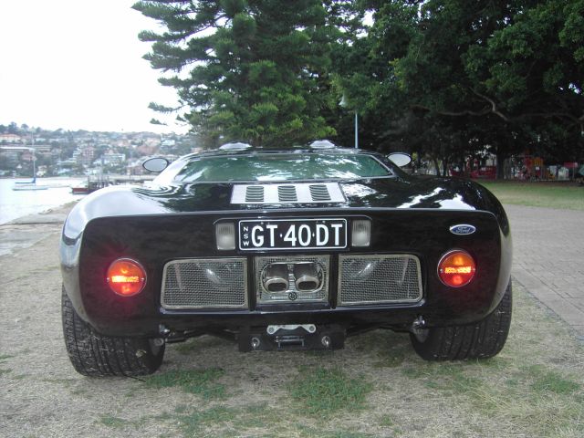

Dimi Terleckyj
Hi all
I have to agree that you never have too many ways of seeing where all the cars and obstacles are around you.
A GT40 is not an easy car to have all round view from.
In mine I have high mounted mirrors plus an original interior mirror and also a ultra wide angle rear view camera mounted just below the exhaust pipes (see photo).
Dimi

rear view cameras are not a substitute for mirrors, they are helpful ,especially in parking lot backup situations. Your depth of field is very limited with a camera so a mirrors is still needed in my opinion. GT40s, especially MK11s are a challenge, to say the least, in traffic. I would highly advise a stalk mounted sideview mirror, they may not look vintage, but at least you can drive more safely.
hi chuck,
i agree cams wont give you good depth, but i think while driving u just need to know if something is there.
i think over time you will "learn" the depth.
i really like your mirrors, can u see pretty good with them?
what kind are they?
Hi all
Dimi
have any more pics that show where you mounted your mirrors and what kind?
