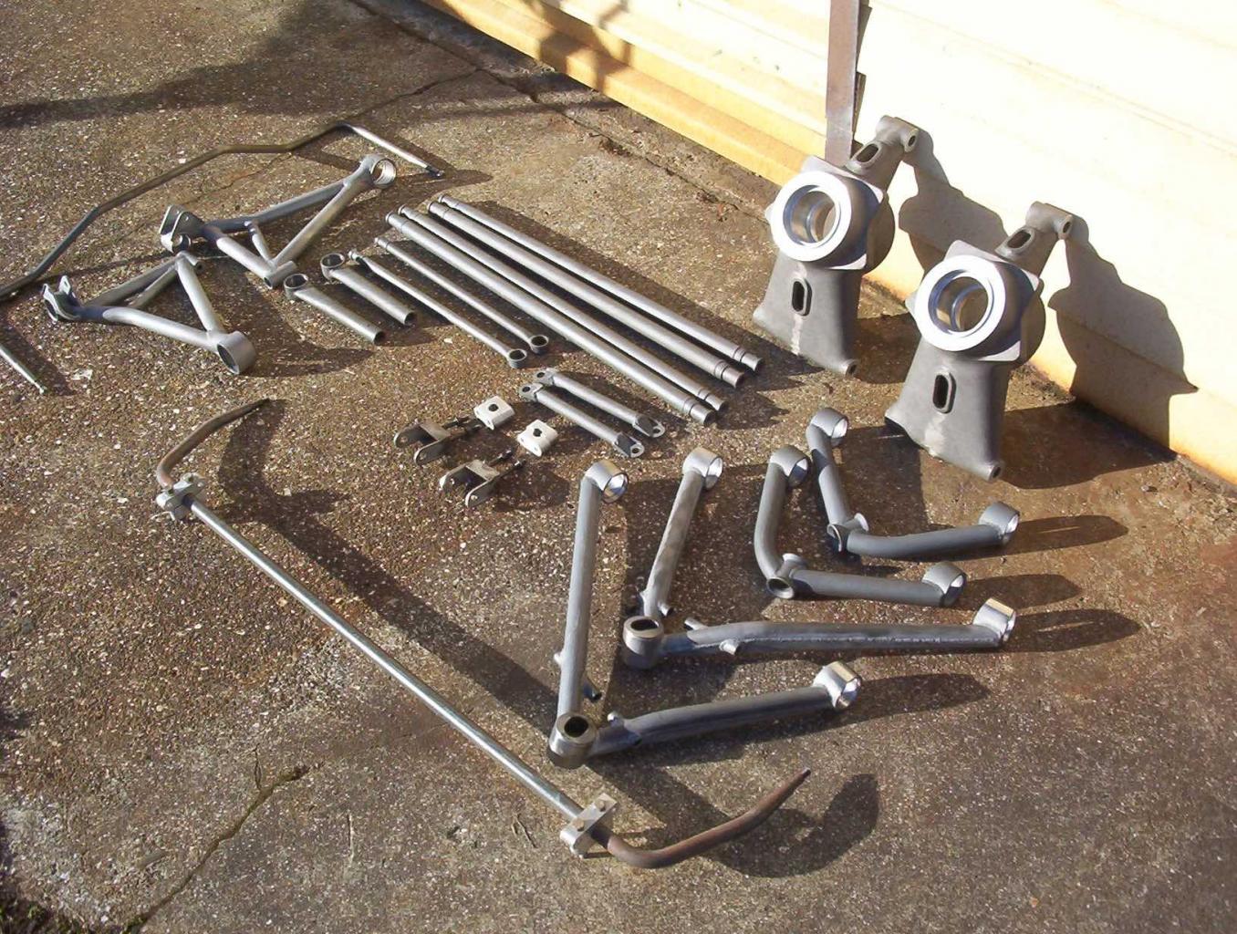

Haven't got mine to hand to measure Andy, but top and bottom look to be different lengths in this picture.

Would be great if you could get some dimensions.... looking at your picture looks like I need to source some more unobtanium........ another question if I may, what is the plating used on originals? were they nickel plated or clear cadmium, and assuming the specification calls for a minimum plating thickness how does this affect the shafer bearing tolerances, or is there no plating around the bearing surfaces?

They are different lengths on the original cars.
I have the measurements but there's no guarantee that they will be the same for your monocoque. I can let you have them if you want but personally, I would rig up the rear suspension with what you have, set the wheel base to the correct dimension (95"), set the rear upright inclination (can't remember this offhand but I do have it) and then measure the distances for the radius arms.
