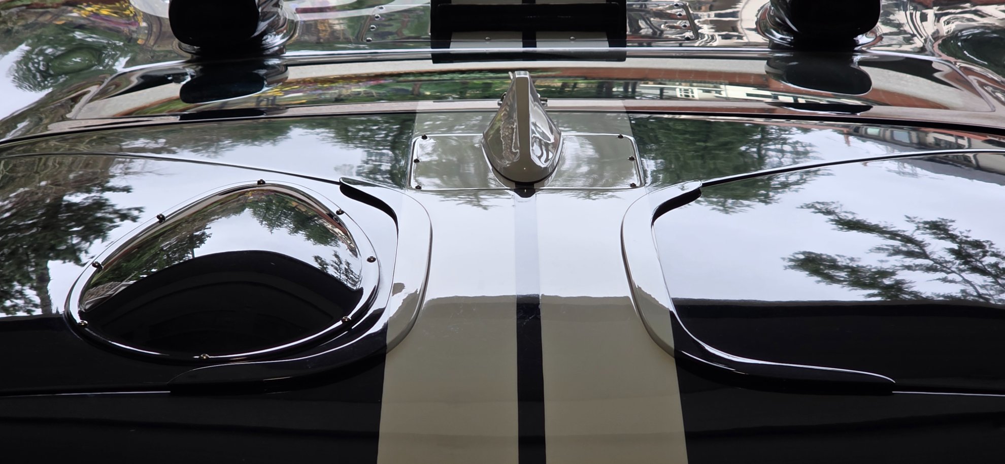

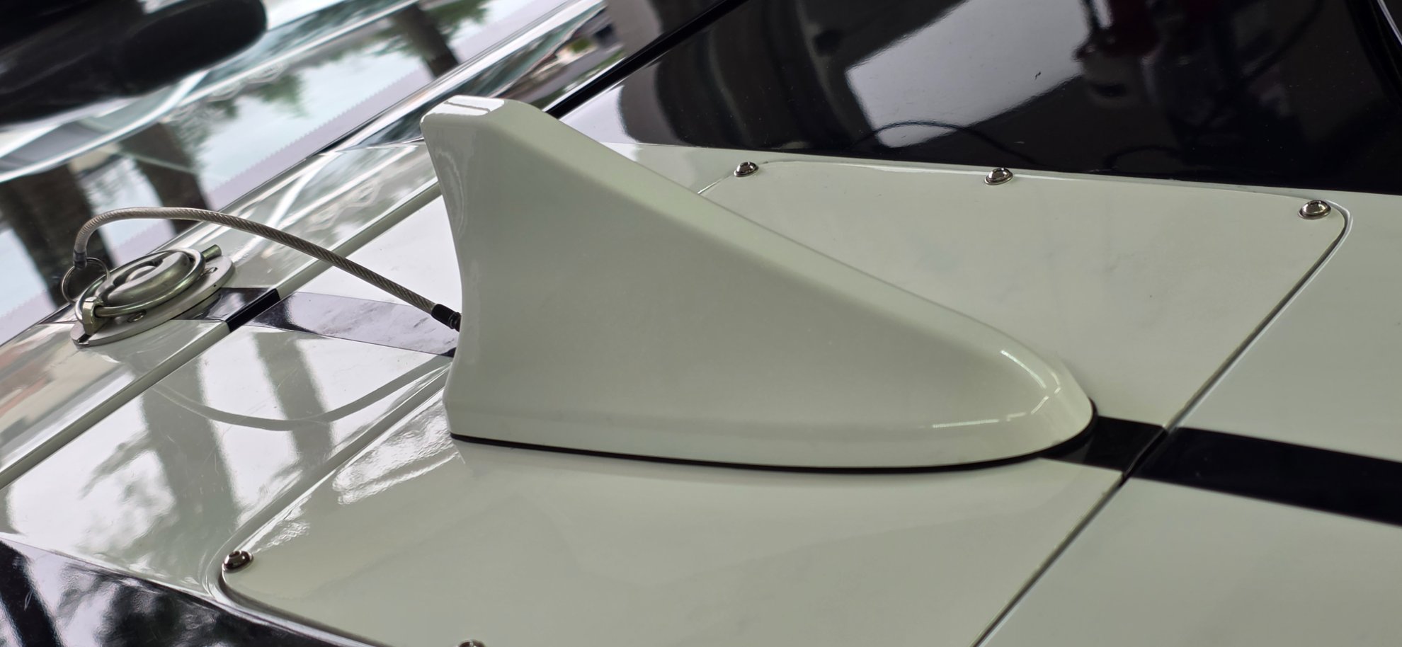

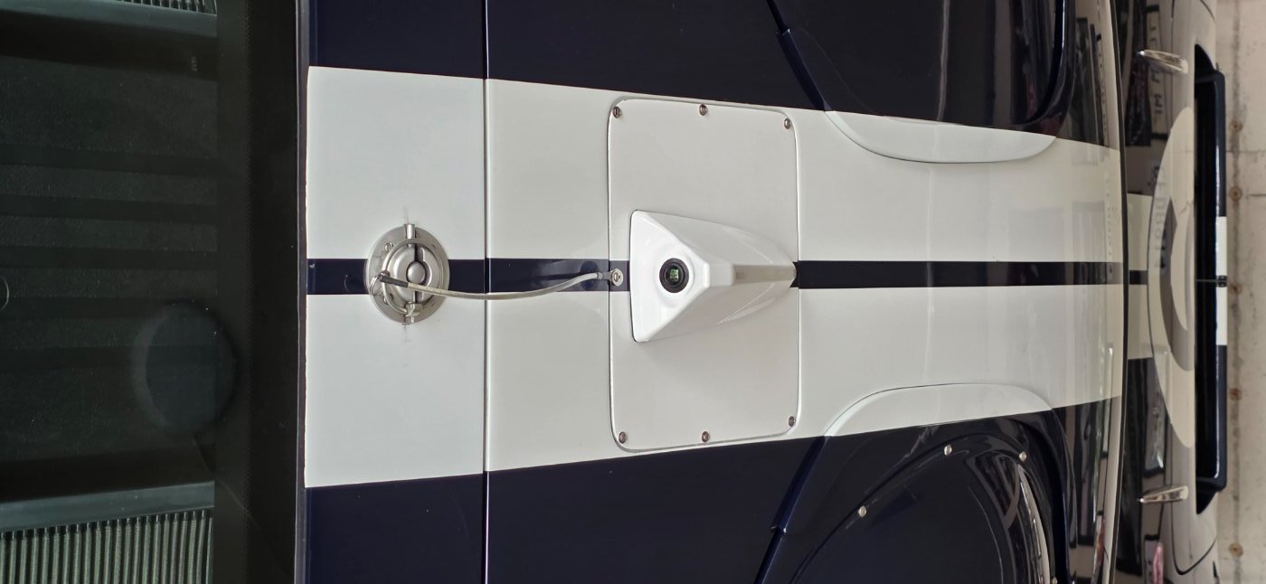

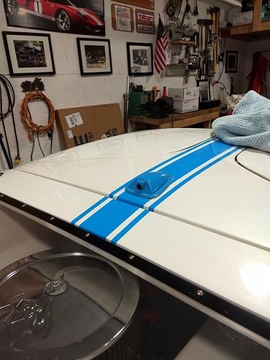

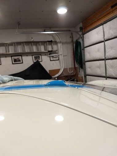

The Mirror/Camera is a very reasonably priced Vantop Discovery H610. The mirror is 10" wide, and attaches to your existing mirror. It can function as a stand alone mirror, has front and/or rear view capability along with recording and has lots more features which I've never explored. I've darkened my rear window to reduce glare and just use it as a rear view mirror. I have it wired to come on with the ignition. The image is crystal clear and fully adjustable up, down, right & left.
The Camera housing is a satellite antenna roof mount from a 2008 Nissan Infinity/350Z. I gutted the I/S of the antenna and cut the hole for the camera in the back. I also removed some material from the top & bottom of the camera itself. I made a base mounting plate, epoxied it to the housing, painted it same color as the stripes, and attached it to the roof with double back tape which also serves as a seal. Sadly, this was one of the few things that I didn't document with a picture or two. Admittedly, I thought long & hard about it and wasn't sure I wanted something like this on my roof, but after driving the car both with and without, I'm totally sold on this location! My O/S mirrors are practically useless on this car and I never need to use them now. By the time a passing car (doesn't happen too often), right or left, is out of sight on the mirror, I'm picking it up alongside with my peripheral vision. That amounts to zero blind spots Additionally, I've never had a complaint about how it appears by anyone looking at the car.
HTH, Rod

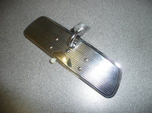

Does your lucas one mount to the glass or ceiling? The one they sent, it is roof mount type without a mount
The arm on it is like 4 inches long.
I bought the E-Type version. If I remember correctly I did not have to shorten the arm. I used a short piece of a cylindrical aluminium rod (straight cut at one end, angled at the other) and drilled a hole centrally for the mirror arm and one from the side for a pinning screw. The angled end of the rod I glued to the roof using a strong 2-component adhesive. Make sure the pinning screw is positioned for convenient access. Note that some of the original GT40s seem to have this mirror mounted off-center somewhat towards the passenger side. I can take a picture of mine if so desired...

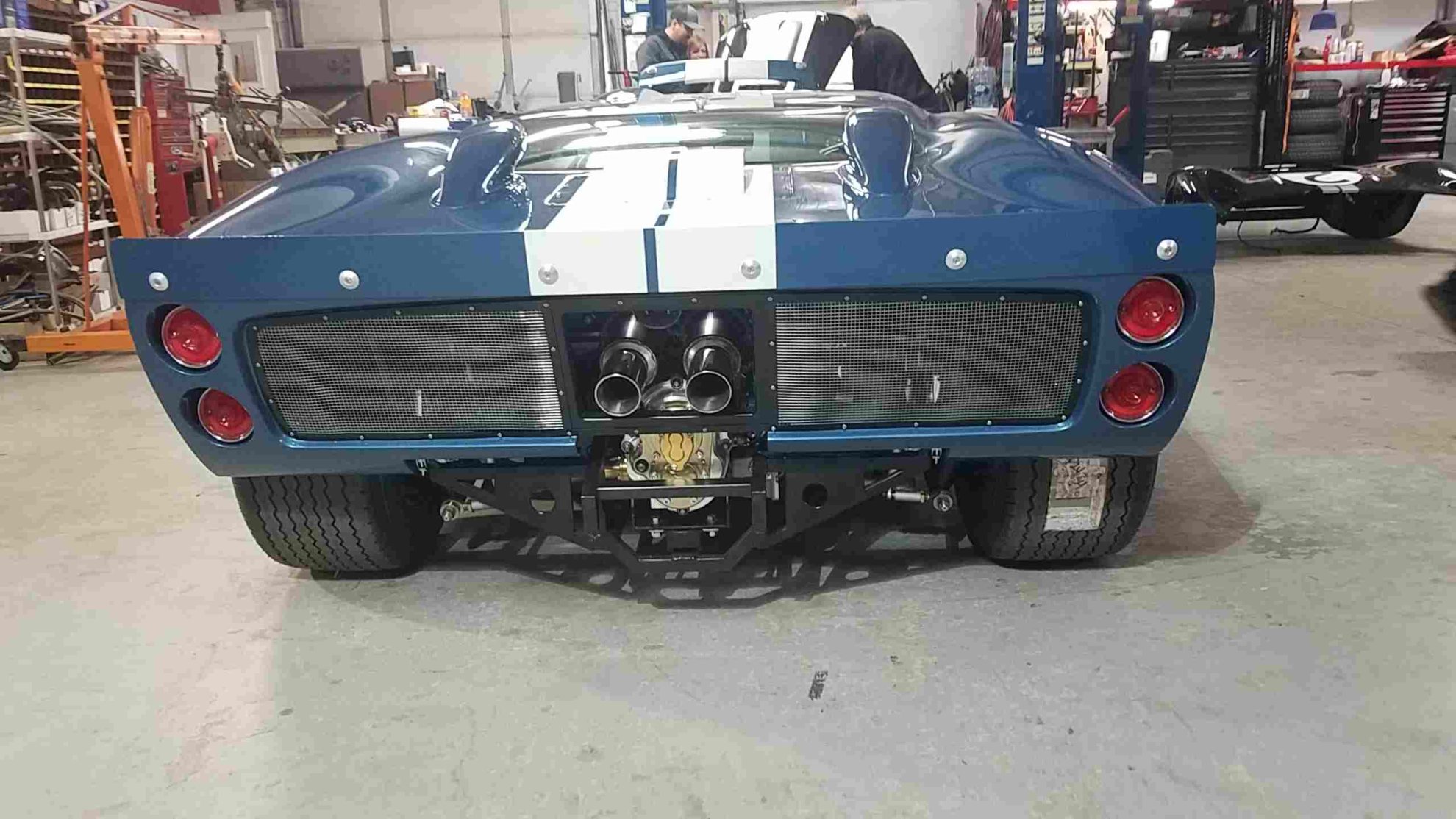

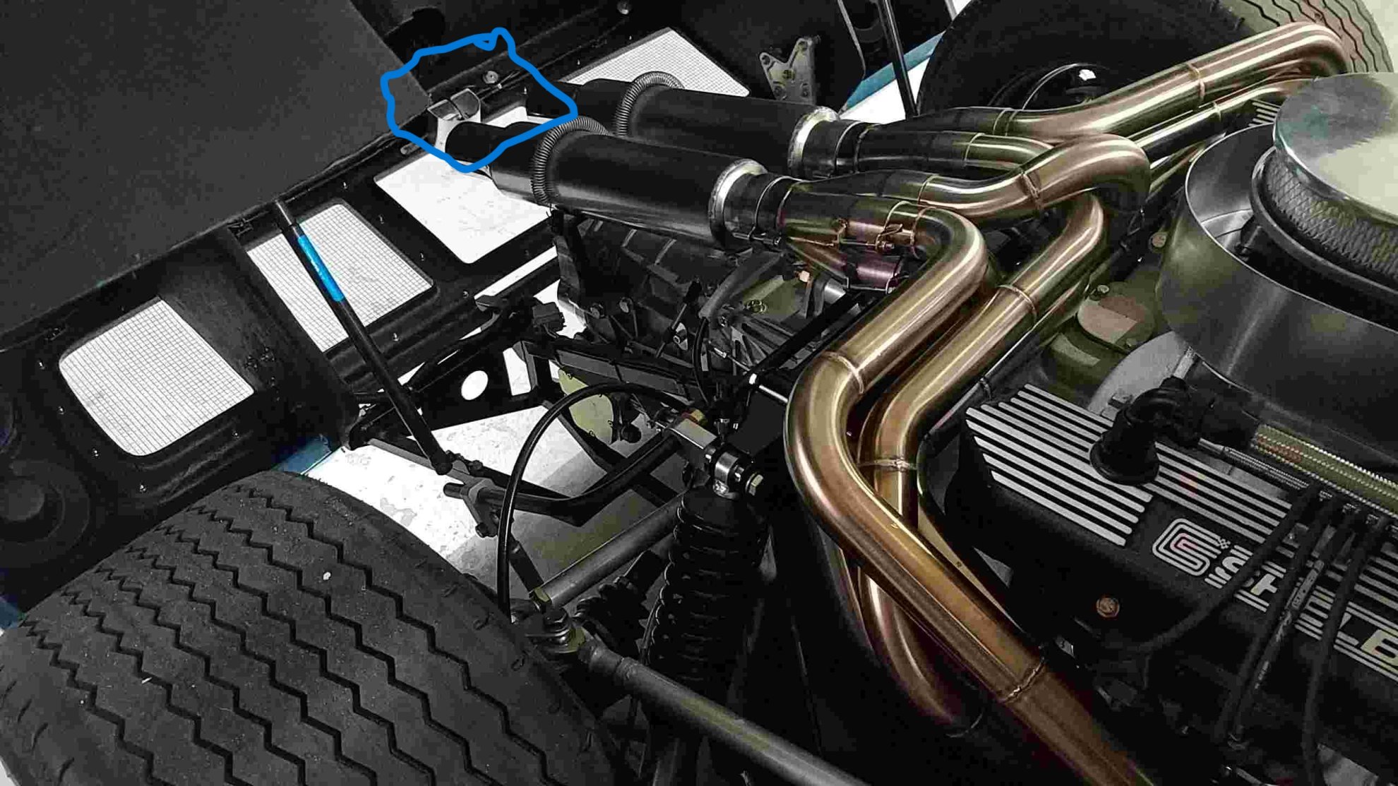

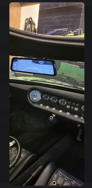

For what it's worth, when Olthoff completed my SPF for me he installed a video rearview mirror and mounted the camera to the rear clip just between the exhaust pipes. They made a nice little heat shield for it that so far has worked just fine. I have about 2000 miles on the car and it hasn't died yet. It gives a great view behind the car but obviously zero view of the blind spots on either side. You can just see it in the photo from behind the car.

Exactly the same place as mine, the rear view is a vast improvement over the normal mirror. How did you deal with the glare on the actual video screen?

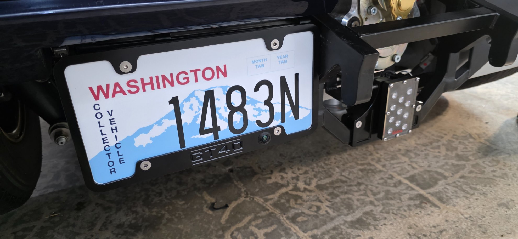

Any reason you guys aren’t using an autovox t9 or similar. Mount it high on spider like someone else did and be done with it. Shows you 180 view from rear of doors onward. I have the same setup in my SLC and FFR coupe.
Leonard L
Leonard L
Camera 1 is built into the removable license plate mount and frame. Camera 2 in mounted on the roof and used on the track when camara gets removed. Both cameras can be rapidly removed when showing the car to its authentic look.
Adam,
I haven't noticed any problem with glare on the video screen. Mine is built into the rearview mirror that is mounted in the normal interior rearview location so it doesn't really ever get sun on it.
Bob
