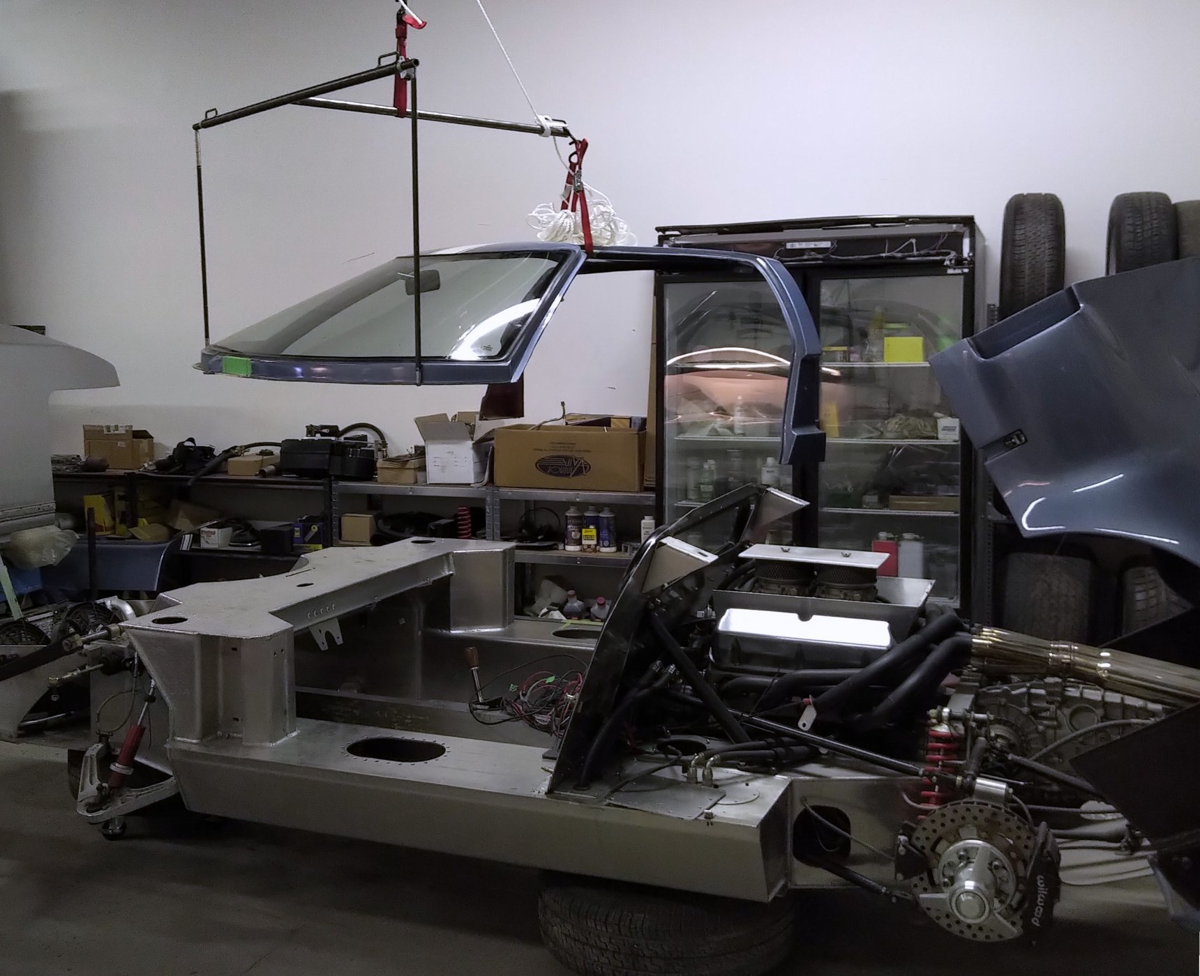

Ian Clark
Hi Mark,
The answer is yes, you can remove the roof spider molding with the windshield bonded in. You don't need a lifting frame as we made here, however if you prepare a clear space to rest the spider on the floor and support it so there are no new stresses, fiberglass it will not warp nor the windshield crack or debond .
  • RCR GT40 Rework Cowl Bridge, AC Upgrade, Replumbing and Insulation p132.jpg
